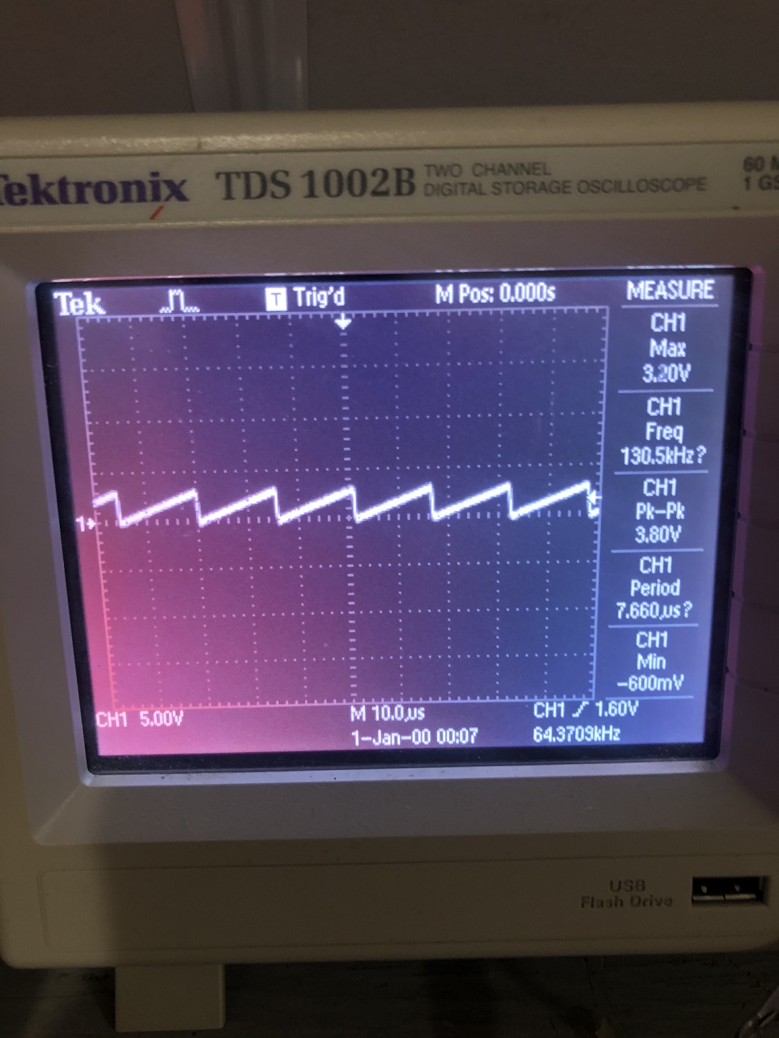

Start by removing all IRF3205's.
Once removed check with a scope the drive at the TL594 U2-Pins 9&10, and the sawtooth wave at Pin 5. post screenshots.

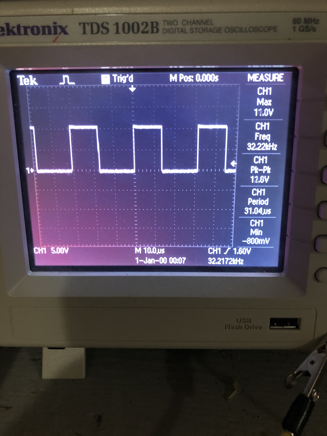

Image 1 - U2 - pins 9 and 10 scope output - they both are the same

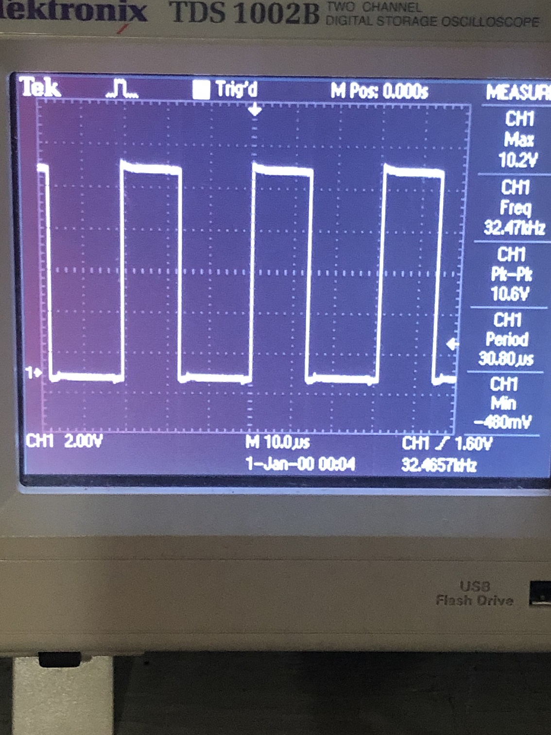

Image 2 - U2 - pin 5 - sawtooth output

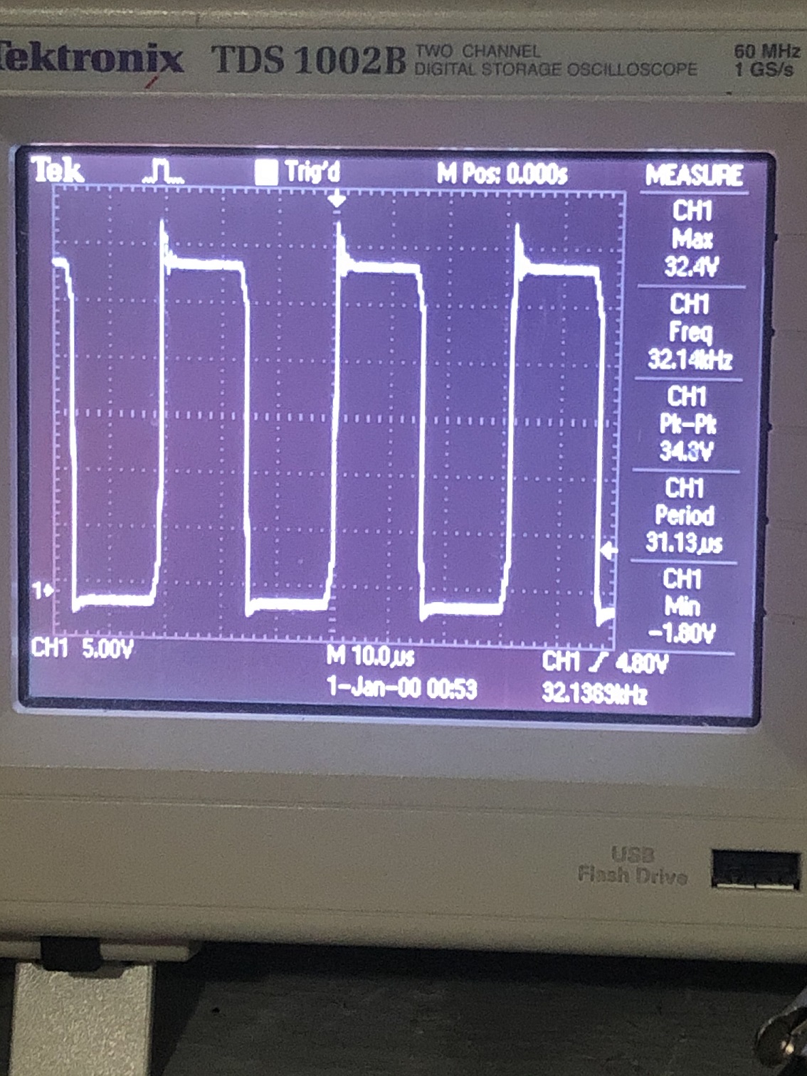

Image 3 - Power supply fets at the gate pads - all of them look like this

Quest components shows stock on both but i've never used them. Your drive signals looks perfectly fine. You can monitor them when the new FETs are installed for issues, but I suspect you'll be OK. You should measure the gate resistors even if they look fine.

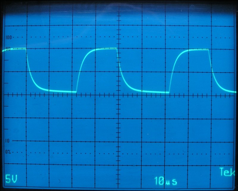

Testing with no load on the driver circuit isn't definitive. The drive circuit needs to be loaded g-s on the FET pads with a small capacitor. I used a 0.047uF but anything close will suffice.

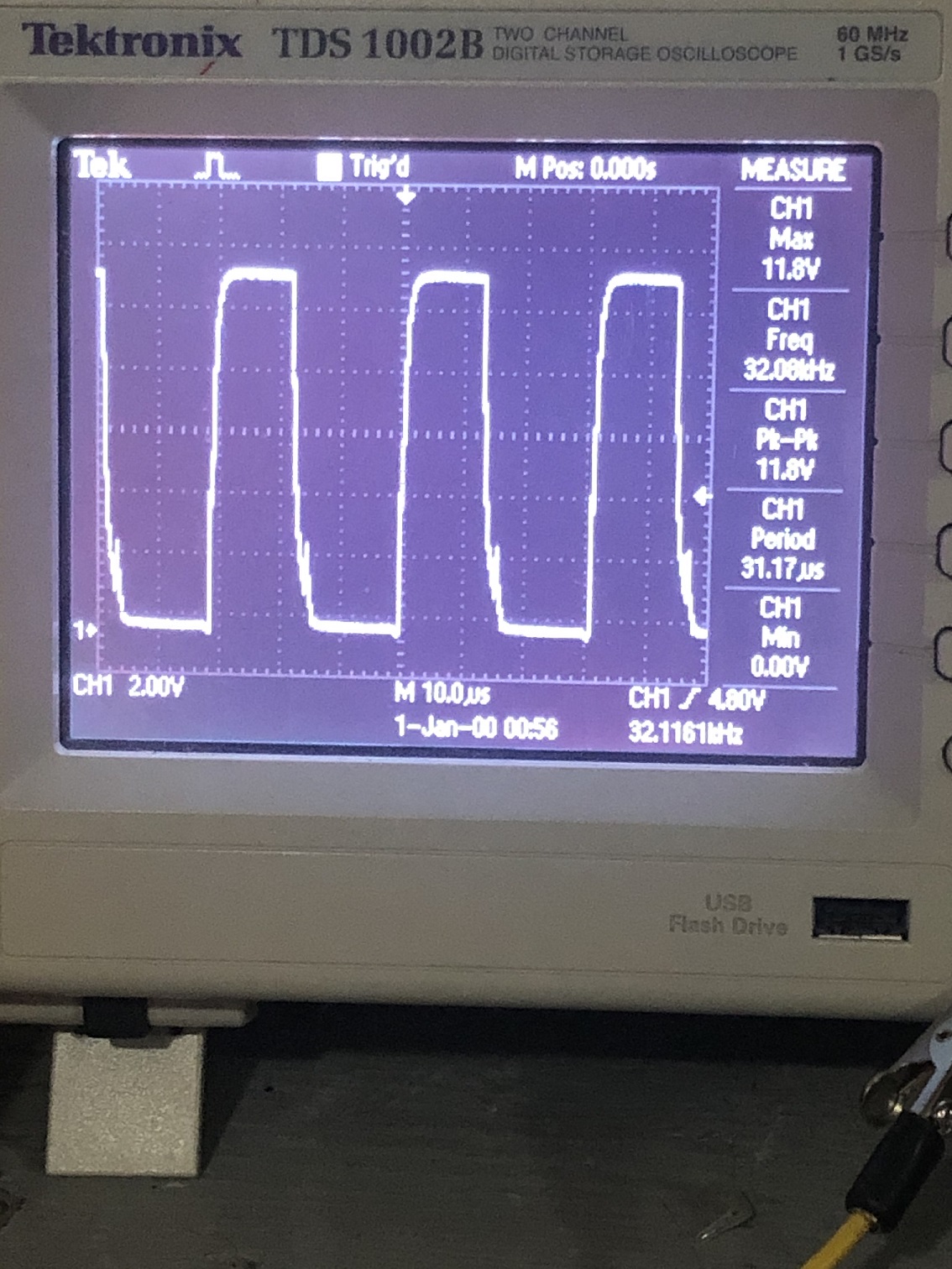

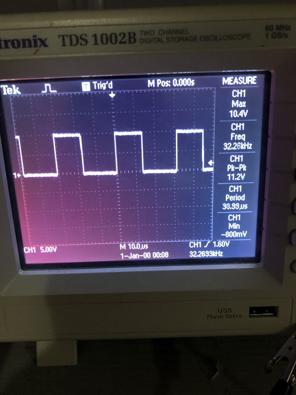

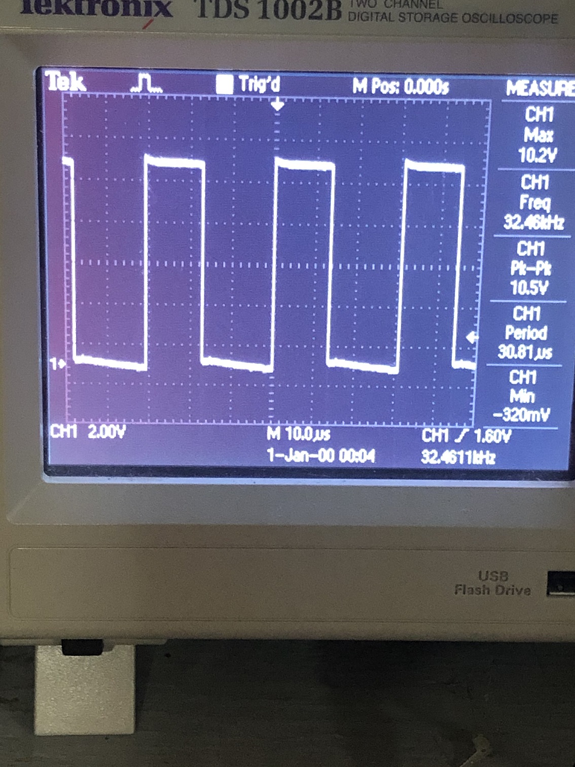

I've included two images. The first image is the power supply drive wave with no load, and the second image is the drive wave with a 47pf capacitor between the gate and source pads of the fets. In my opinion, the drivers are probably OK - but I'll put a couple fets in to try before I fit all of them just in case. I'm not a fan of substituting in class D if I can help it.
