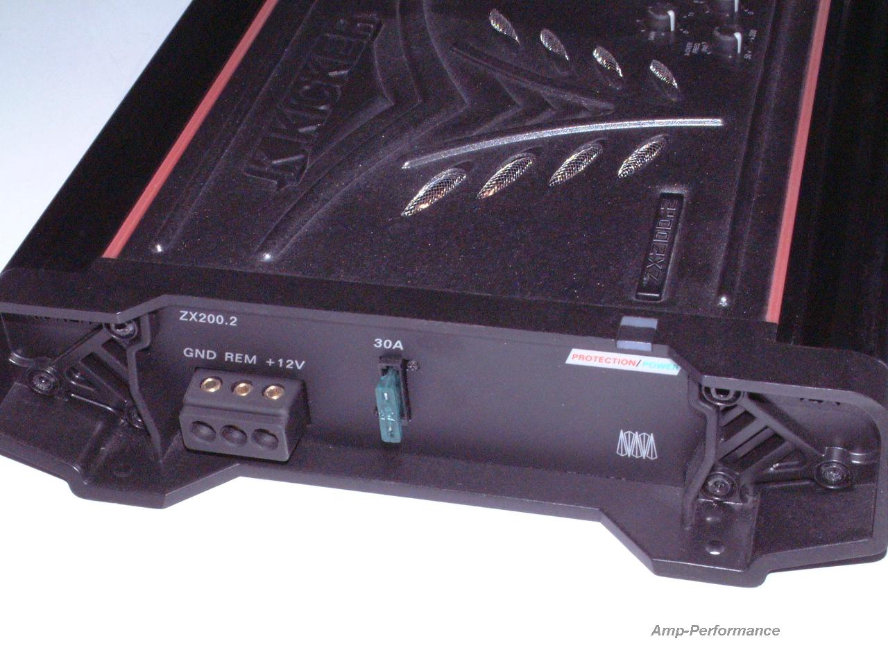

I have a Kicker ZX 200.2 amp in my system and I was playin around one night and had my stereo turned way up and wasn't paying attention and next thing I knew I had melted the power connector. Does anybody have info or know where I can get one??
I don't have a source for the terminal. It would likely have to come from Kicker or a donor amp.
The reason it melted was too much resistance at the connection. This is generally due to not having the set screw tight.
These can generally be made to work but will never look like new unless it's replaced.
Post a photo of the melted terminal if no one can tell you where to get a replacement.

Well I ended up fixing it temporarily by cutting the ground post off of the terminal and using one of my spare output terminals cause I have it bridged so you can't see where it was messed up
