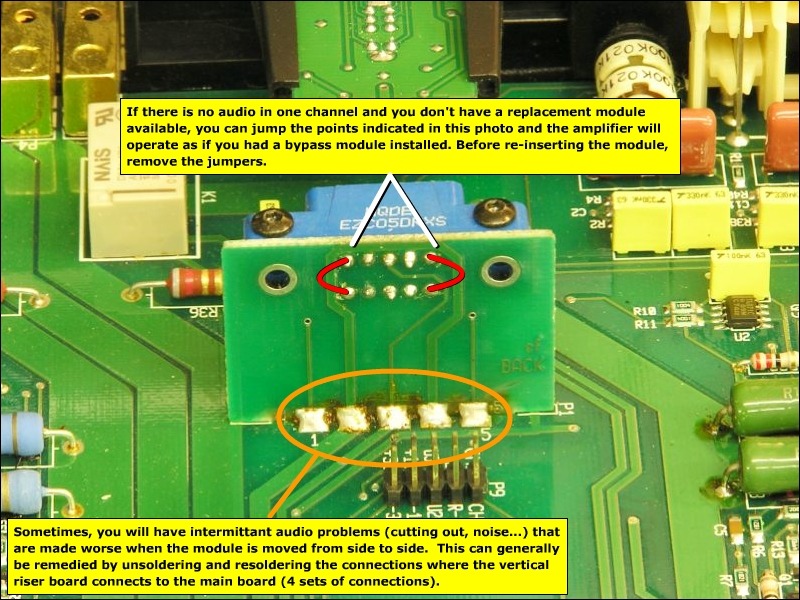

Bridge the fuse with a 1 ohm resistor if you don't have a fuse.
Jump the module as is shown on the main kicker page of the tutorial:
repairnoteskicker.htm
There are partial diagrams on that page and the ZR1000 diagram in the Kicker folder will be similar.

Post #5 I didnt use wire on the fuse, I replaced with a 1206 1 ohm smd resistor. I have audio on the right channel, have not checked for audio on the left due to the 10vdc on that channel.
I'll remove the module and jump the outer pins with wire.
I'll check the DCV on the TL071's.

The crossover module is stuck in full range but I pulled one from a parts amp and all is good.
