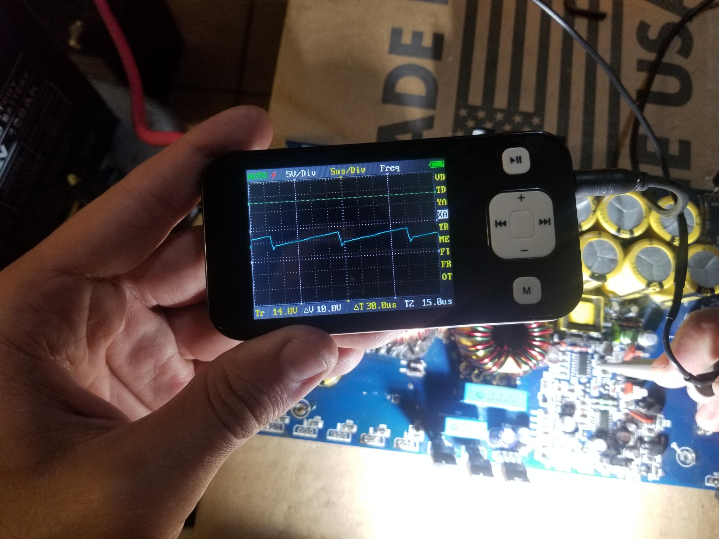

Power up the amp. With your scope grounded to the Battery Ground terminal. With the scope probe, check the waveform's at U01-TL494 Pin 5(triangle wave) Pins 9&10(Rectangle wave). Post screen shots. follow the rectangle wave to the 47 ohm gate resistors(Mosfet side) Post screen shots from either side.

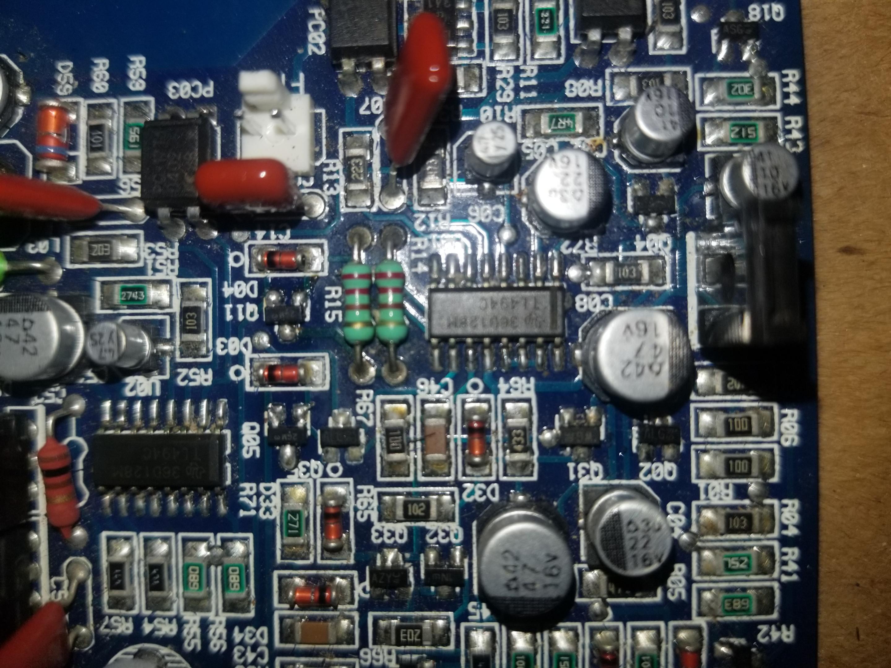

In the photo it's in the top right hand corner. This IC has a bar or stripe denoting the top of the IC. The pins run in a counterclockwise manner. Example below

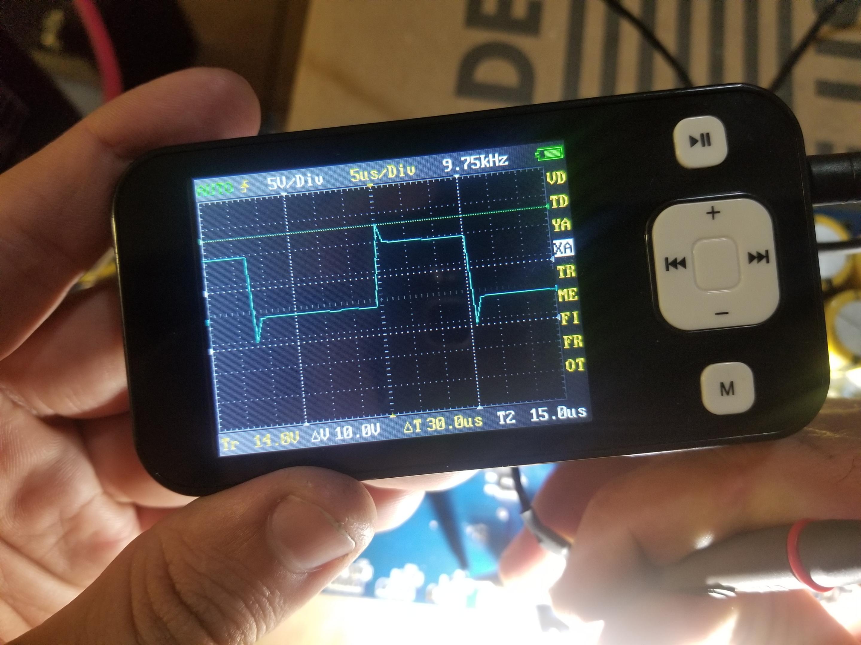

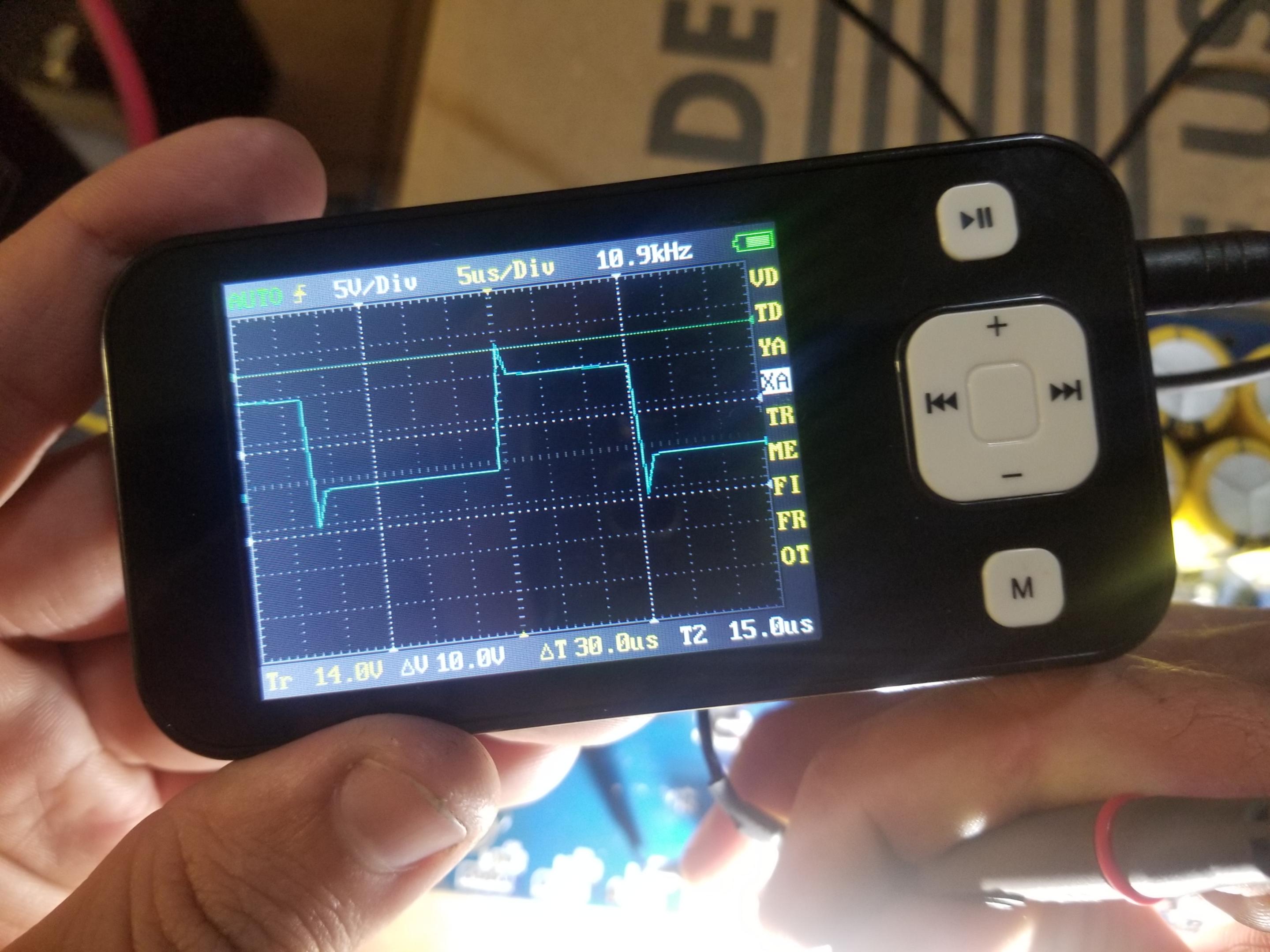

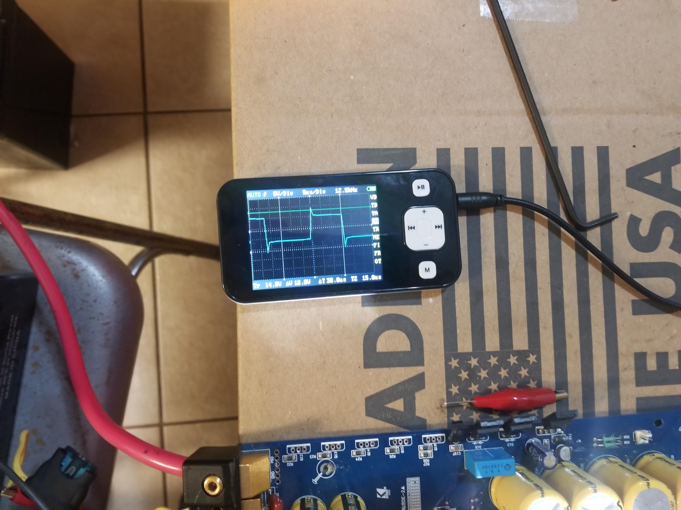

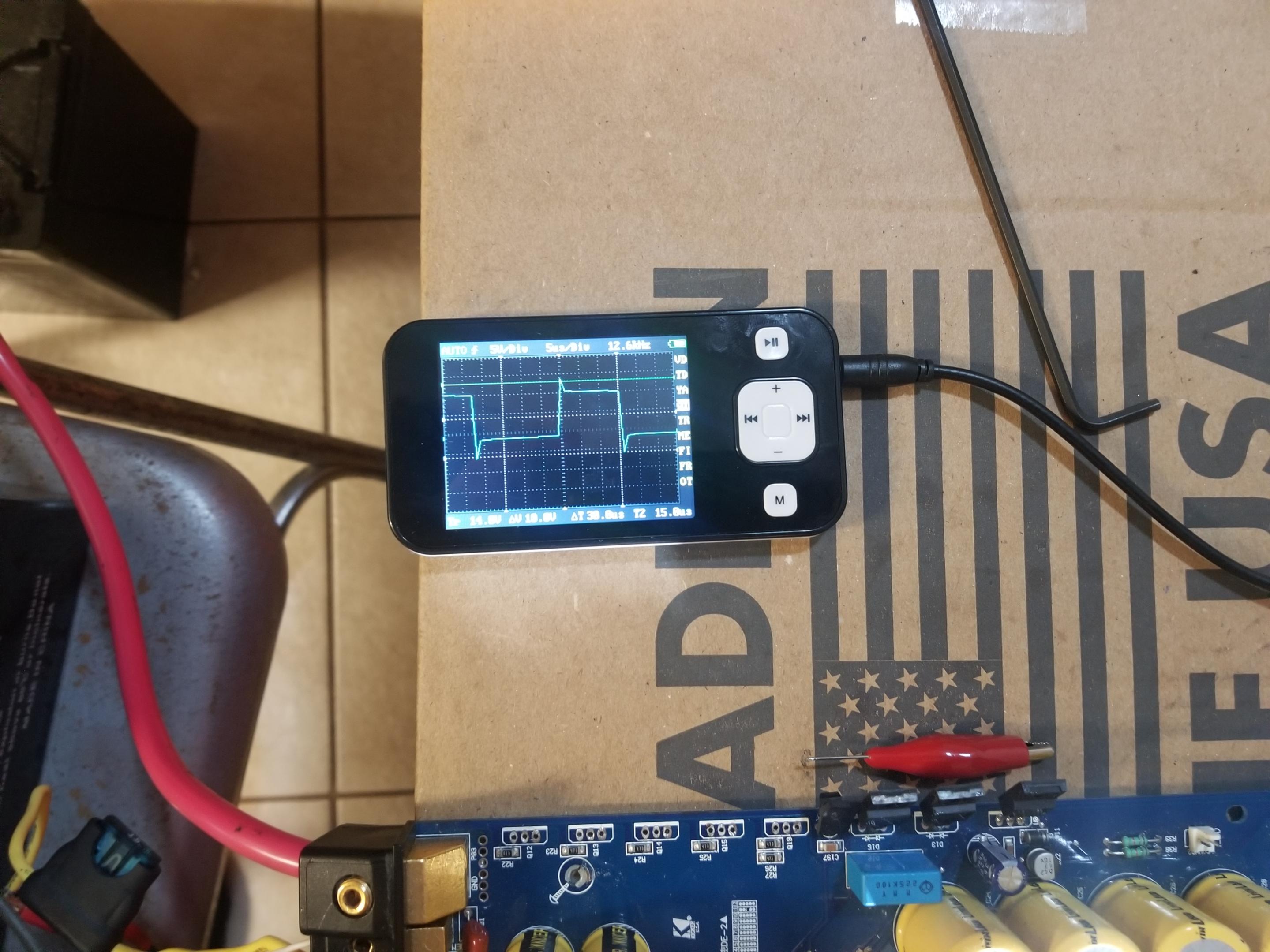

Both sides of q9 gate resistor . The bounding lines on the Y axis are +5 and -5V. the bounding lines on the X axis are -15 uS and +15uS

Not the best oscilloscope but it works

i think i checked u02 there for triangle waveform.. its the same on u01... the rectangle waveforms from u02 do not match those of u01... the ones i showed u are u01. the ones on u02 seem to have half the duration
