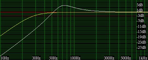

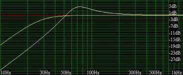

Winisd shows a nasty 5 db response hump centered around 75 hz for 1 cubic foot sealed. Optimum is 8.323 cubic feet sealed for ruler flat response down to 60 hz and an f3 of 27 hz.

Thanks for your reply, sub is used for home, iam using electronic xo at 125 hz, could you explain wot f3 is. what effect would the larger box have on power handerling, low end response and effecancy, could you post the response chart. Is there any one out there using this sub for home, any comments, advice would be appacrated. I use a tri amp set up with fostex xo for main speakers (vintage B&W 603 with vifa tweeters as I cooked the organals) and kitset sub xo feed off the lf output.
F3 is the point at which the response is -3db from reference (0db).
The larger box should require less power and play more efficiently.
At 20 hz you would see a 14 db gain, so your "low end" would be considerably more substantial.
If you like the sound from your current set-up you may not like the "optimum" version. Your 1 foot box would be really punchy, while the big box would be pretty flat until quite low.
