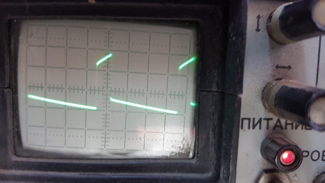

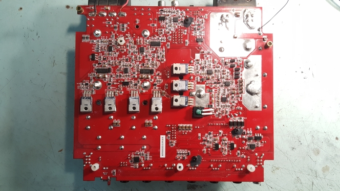

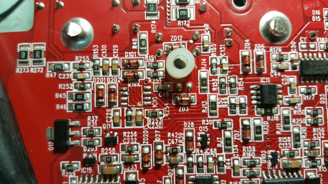

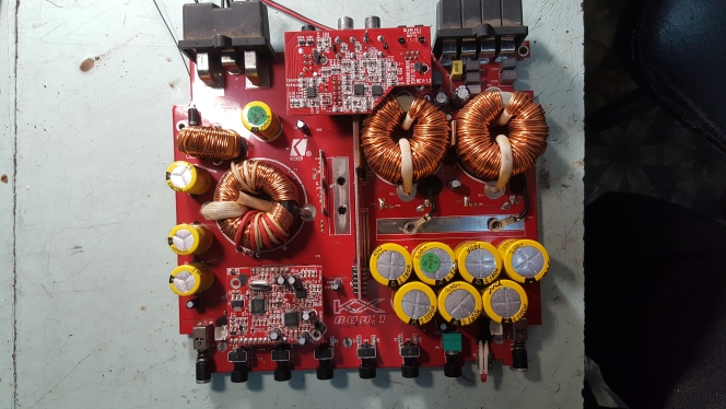

kx800.1 power on - but no sound.
hot d201, d202
ic10 TL072C - no audio on 1 and 7 pin. on 2,3,5,6 pins audio is
if delete ic10, a there are impulses on l101, l201. I changed the ic to a new one, there is no sound at the output, the pulses on l101, l201 disappear.
