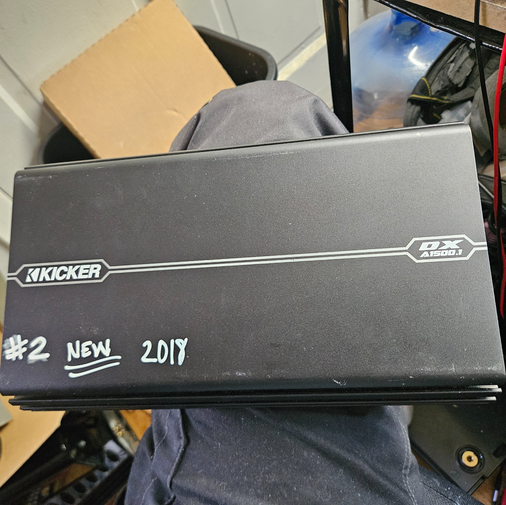

Hello all! I'm currently repairing a Kicker DX a1500.1 which has a blown unrecognizable 6 pin ic in the power supply section. The only legible marking that's left on it is "20..."
I believe it may be a buffer ic, since it has continuity with the output pin of the UC3843B iC and the gate legs of the IRFB4110 power supply fets. Does anyone happen to know what it is? Thank you!
