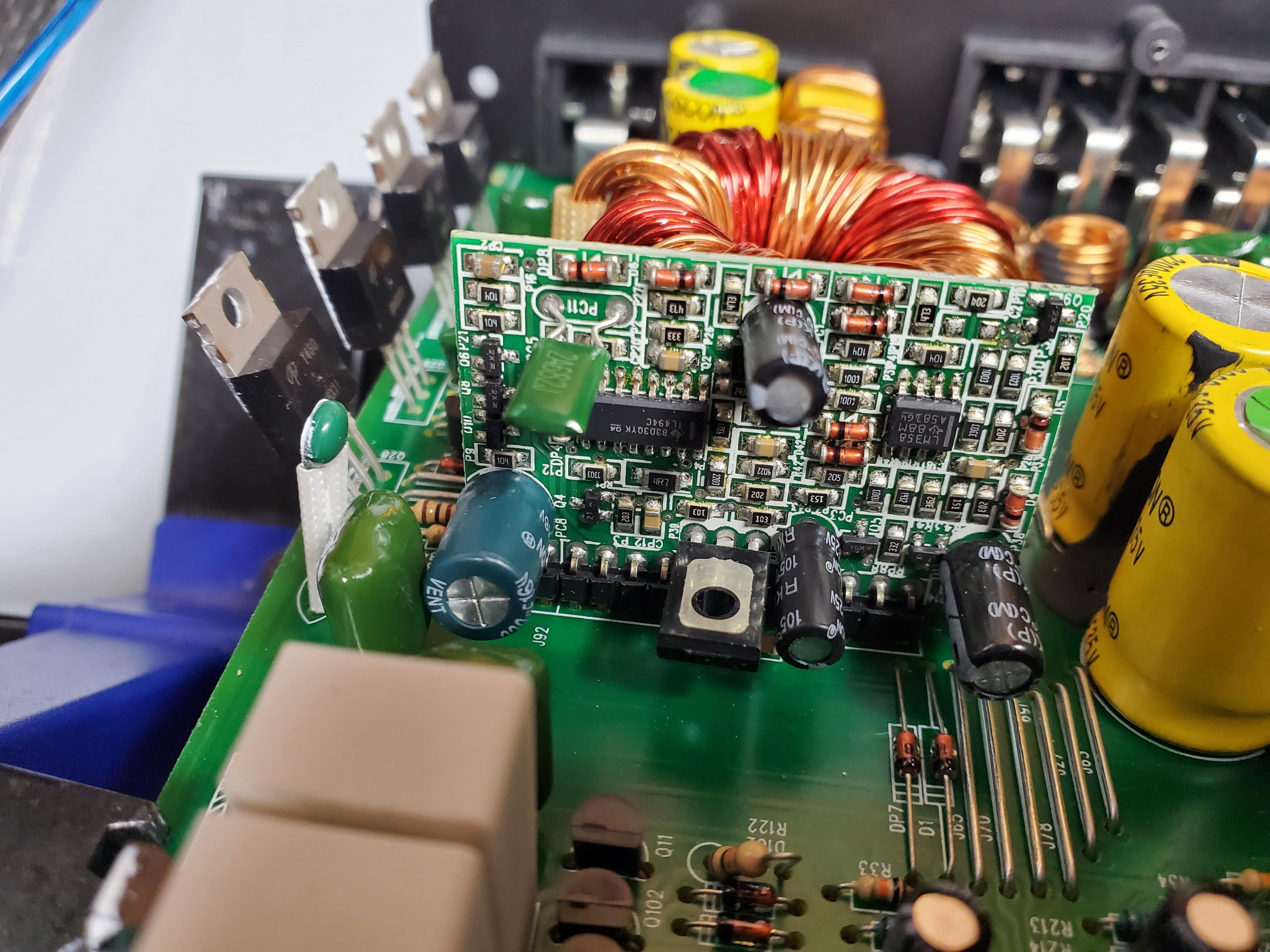

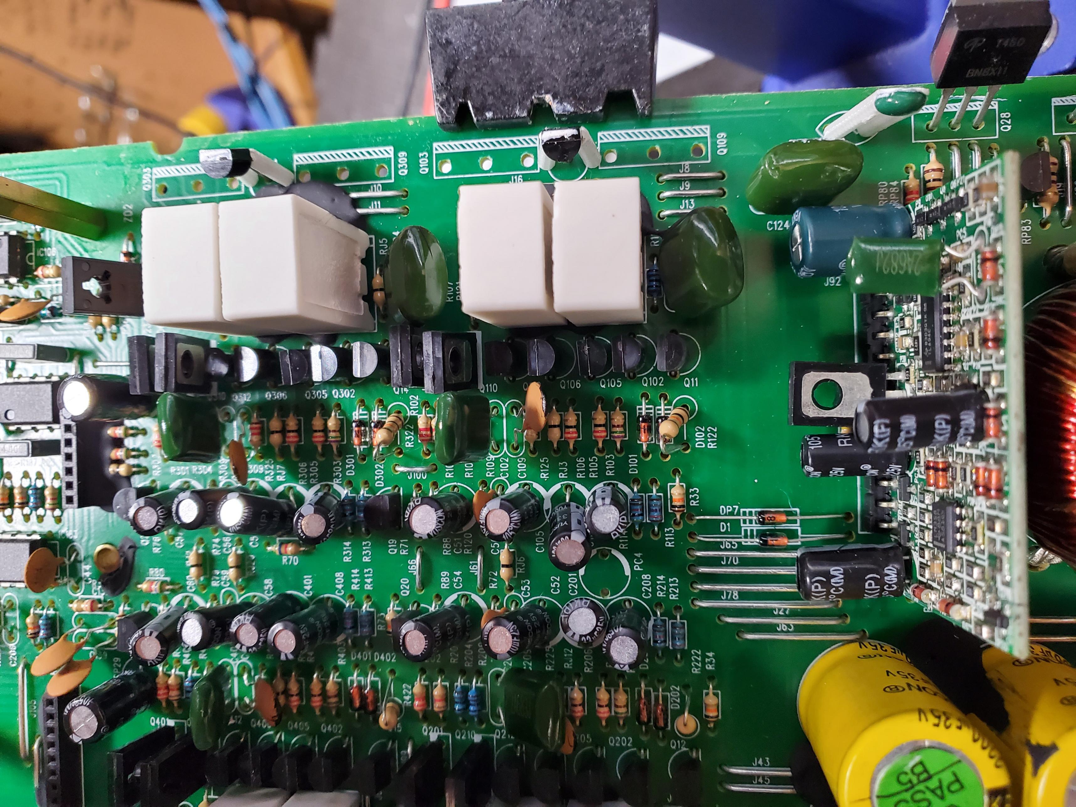

Having a little trouble with this Kicker. Had one output transistor, D718. I have replaced it and didn't find not other components shorted in the channel.
When I apply power the amp cycles in and out of protect. The outputs are out of the amp now, and it is still doing it.
I have unsoldered the middle leg of both rectifiers, I get +/- 25 volts on middle legs. The amp is no longer pulsating on and off. The protection LED is still on. Power supply seems to be working fine.
With legs unsoldered amp is only pulling 20ma.

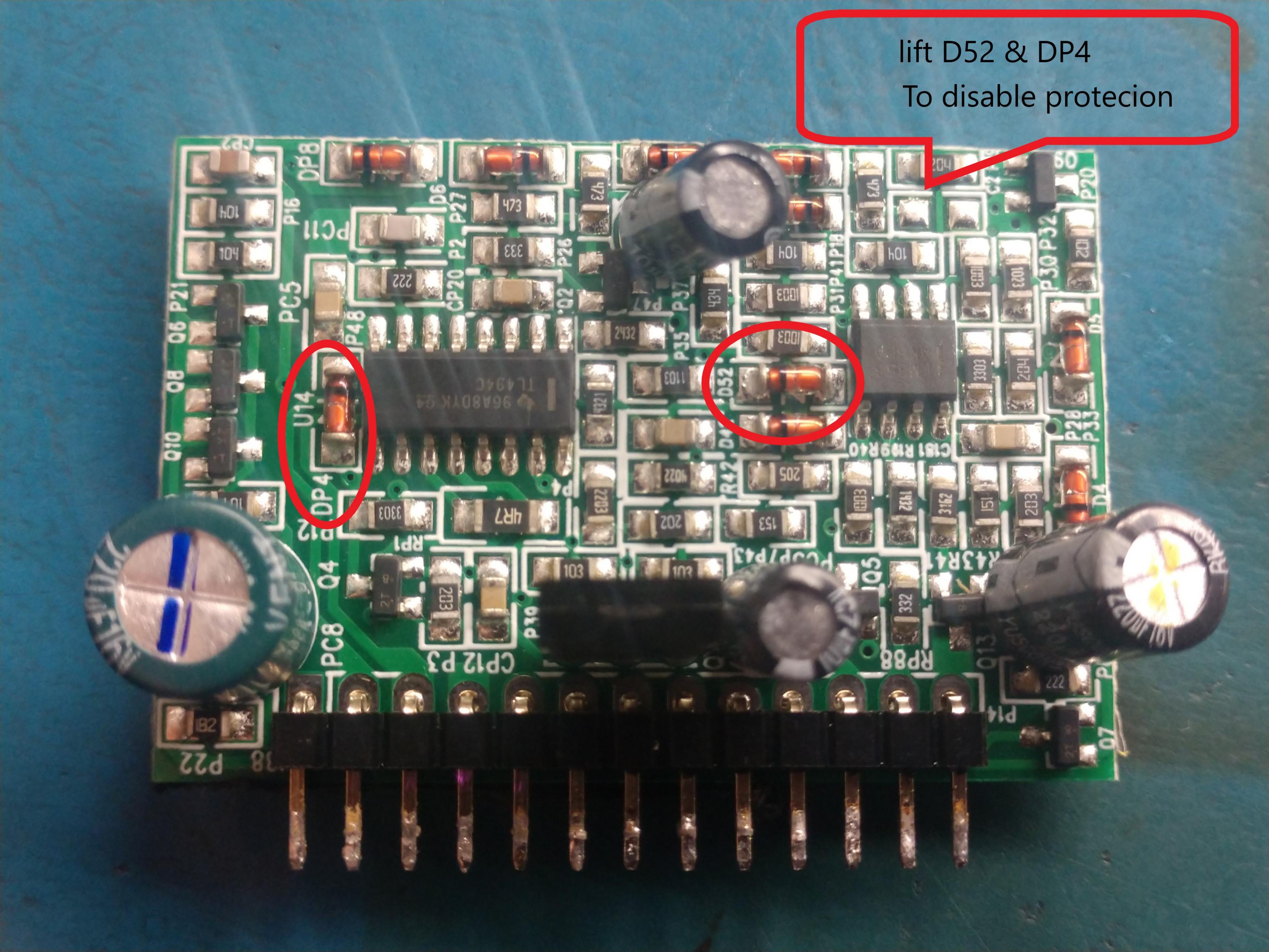

Lifting DP4 and D52-1N4148 (Both will be on the PWM daughter board) will disable output and DC Protection, and allow you to troubleshoot the bad channel. You can also desolder the pin on daughter board that is connected to either cathode of DP4 and D52.

The shorted 718 was in channel 2. I only replaced the 718, however I have no outputs in, all 4 channels have been pulled.

PapaZBill, which pin is it that I need to unsolder? I don't have continuity from either diode to a pin.
Okay ignore my previous comment, I was mistaken about lifted the pin card. You will have to lift the diodes in order to disable protection. You may have to remove card to do this.
This will allow you to troubleshoot deeper into channel 2. It's also possible there is another bad channel.
