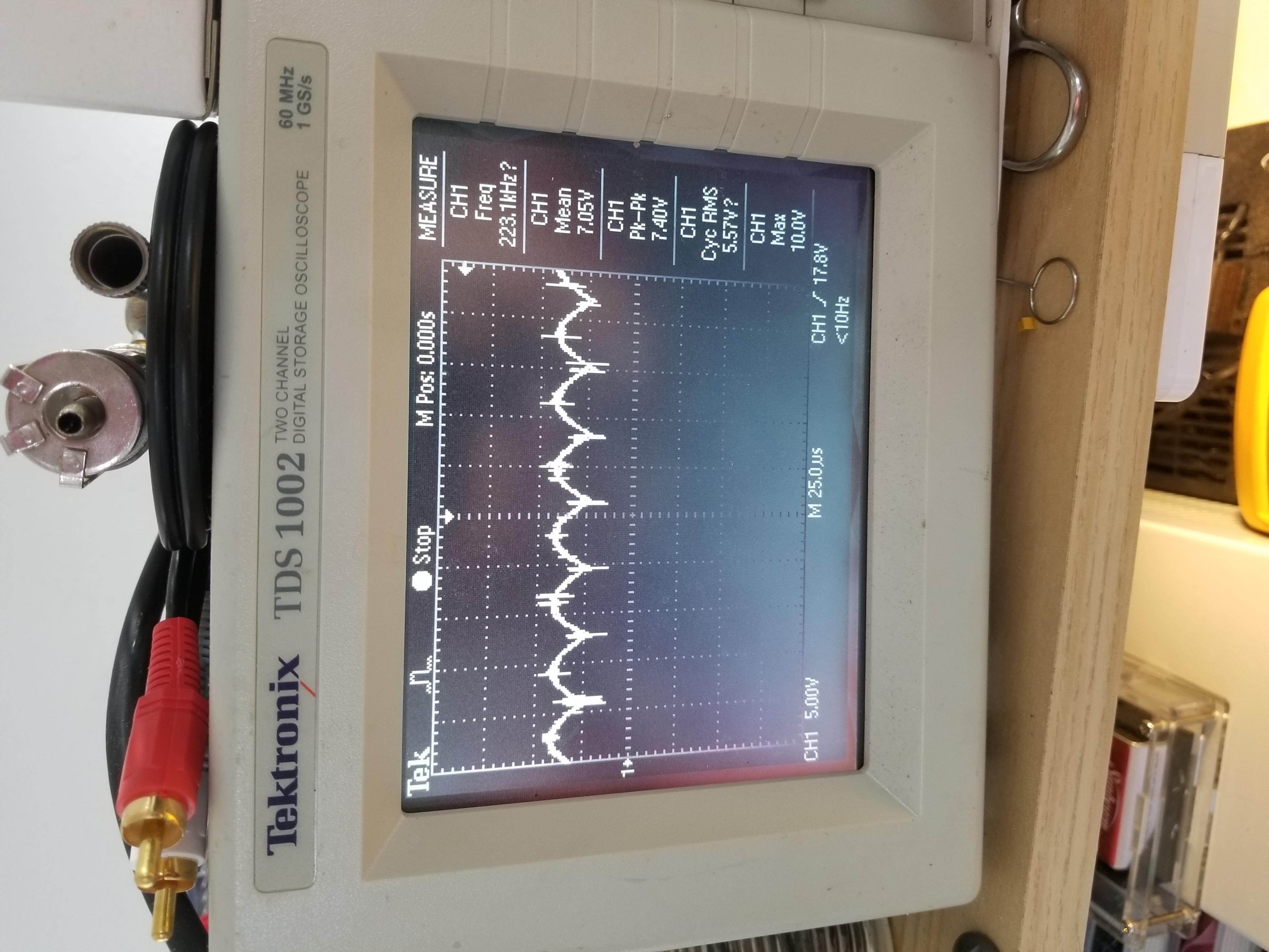

Pin 1 ic11 now on 1x.
After a second look I realized this waveform should be the same as Pin 7 IC11. Recheck it to be sure.
Pin should lbe the same as pin 7 correct? on the ladder what i should read from main ground is 12-24-12vdc correct?
Yes to Pin 1 should look like Pin 7
ZD5=12v, ZD4=24v & ZD3=12v If you measure from ZD5 anode to ZD3 cathode it should be 50 volts.
So from power ground on zd4&zd5 41v and zd3 41v zd7 31.6vdc. I have a 50hrtz signal on the r150-250....I do not have the signal on pins 1-7
So I can not get no matter how many times I change around the diodes and or capicitors have the signal now is I have the drive on pin, and 100khtznsawtooth on 3&5 but not on 7,
