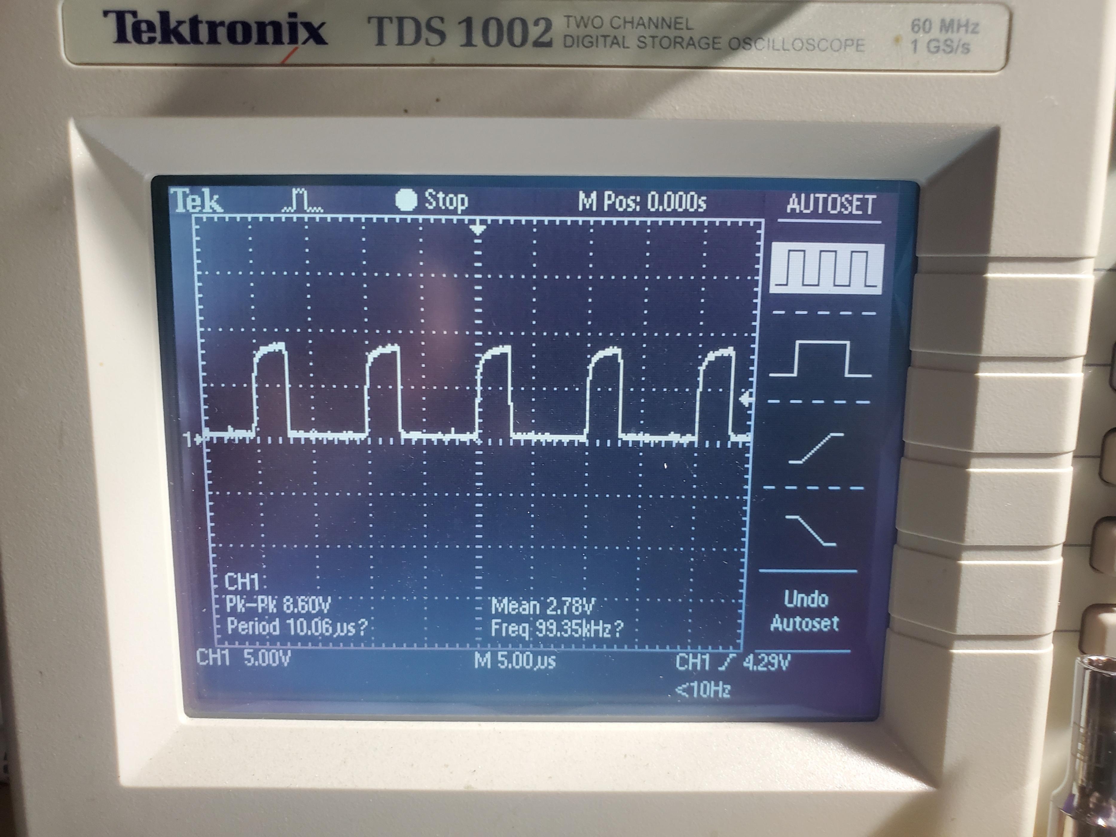

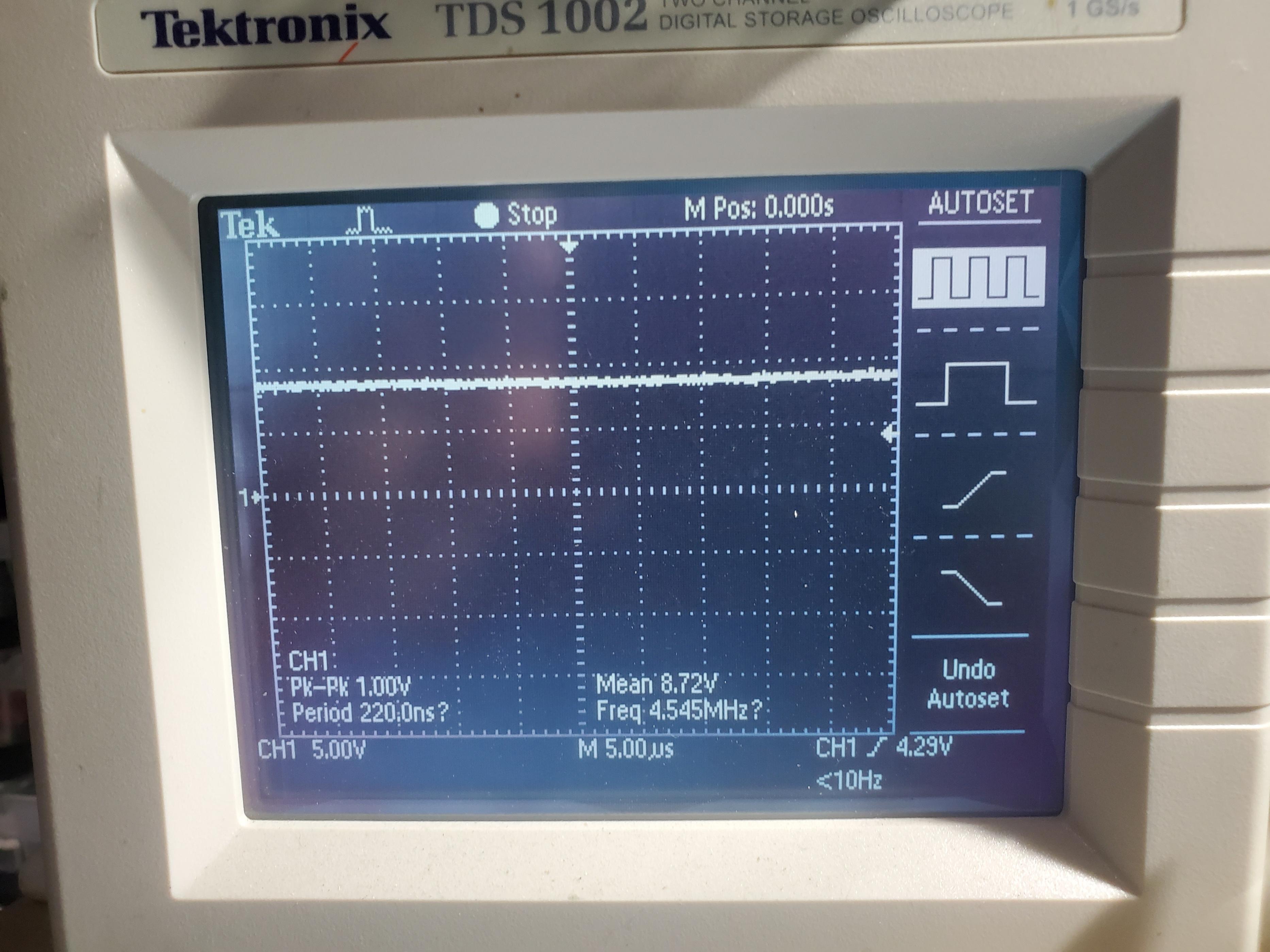

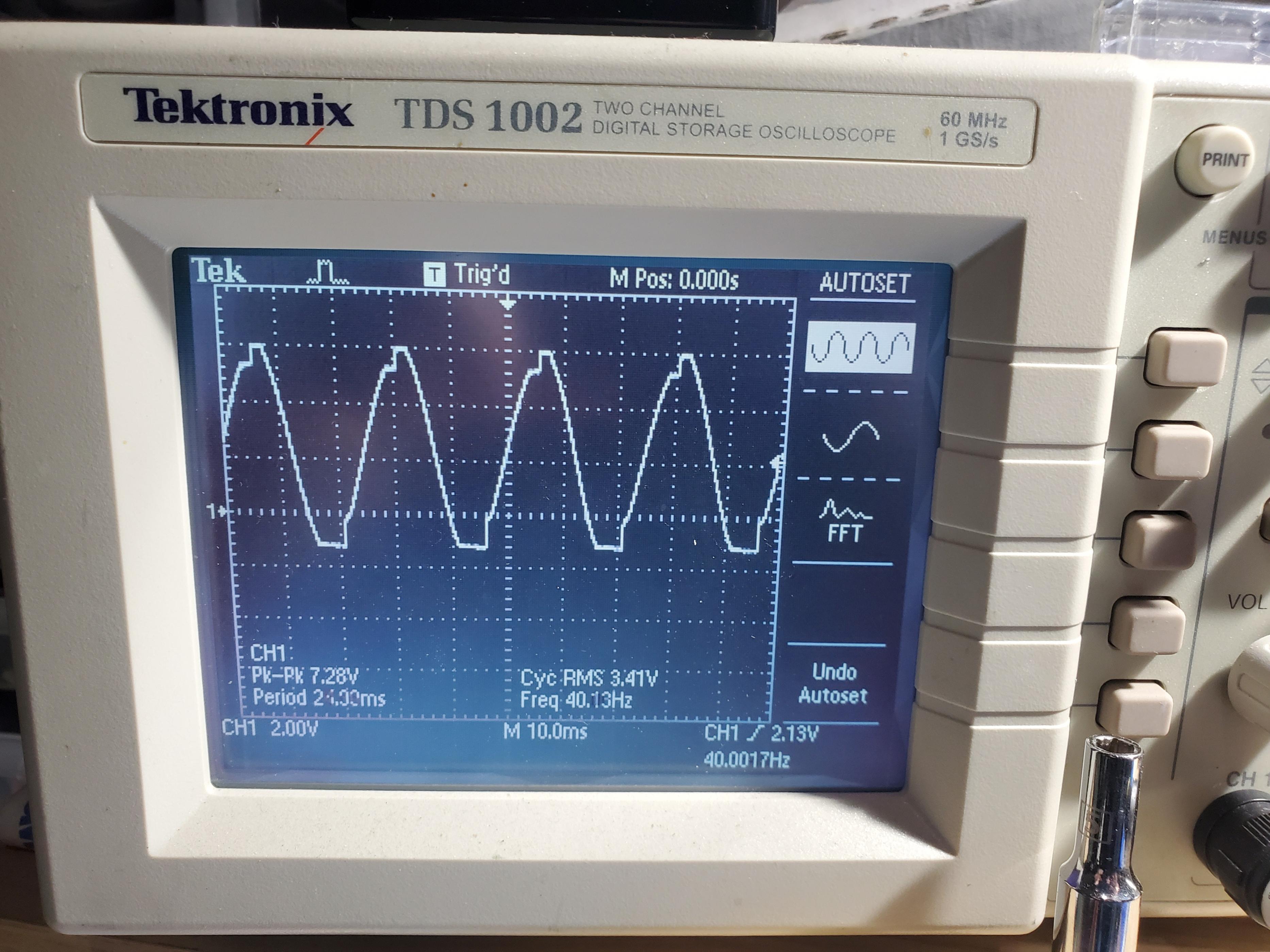

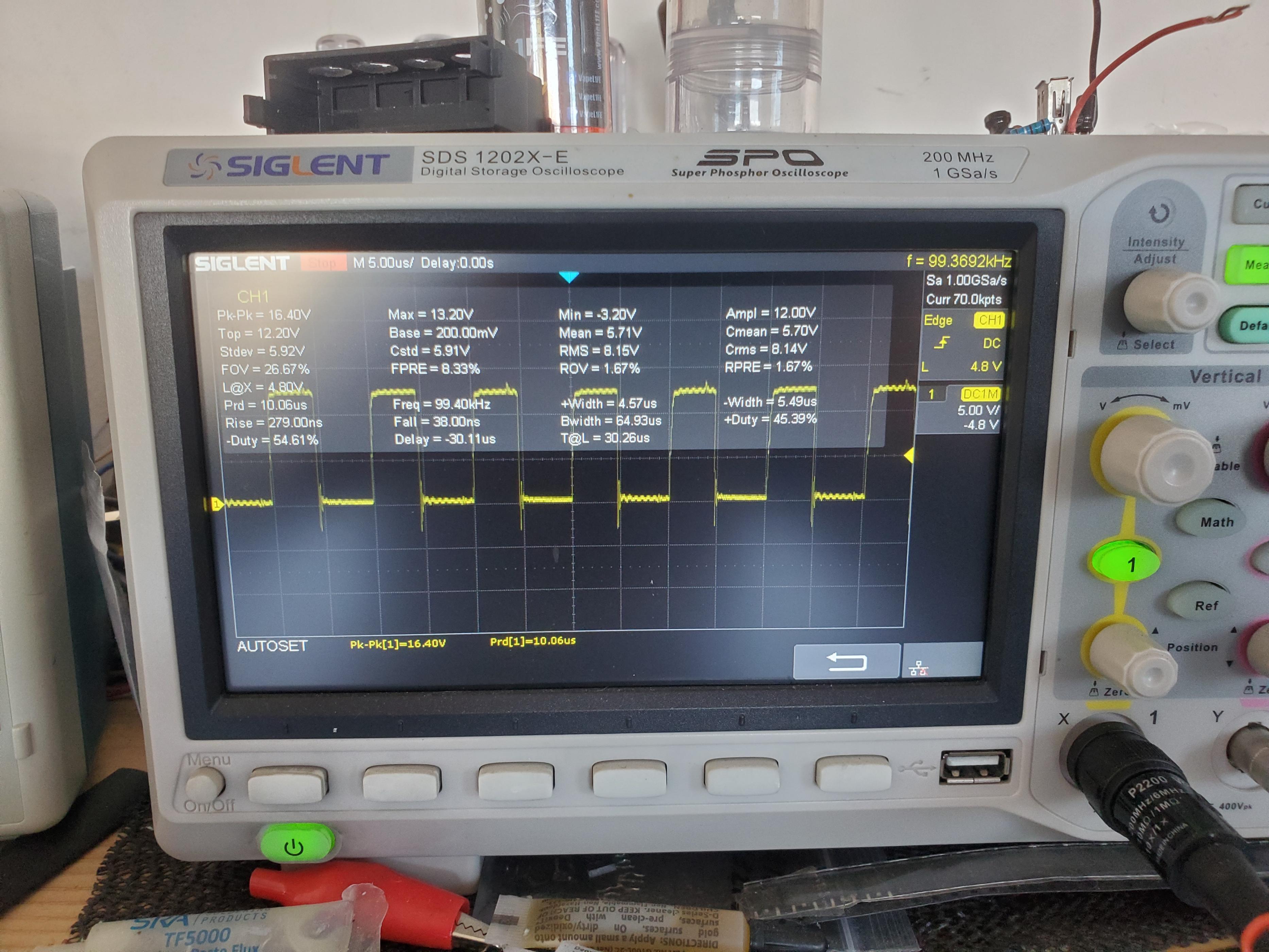

Confirm that the rail is ~74Vdc and that the drive at both output inductors (IRS20957 side) is 1/2 rail. Post screenshots for both Test Points. Also, Measure Vdc around both IC14 and IC15 and post.
Scope Pins 3 of IC14 & IC15 with and w/o signal and post screenshots.

If the drive is good there may be an issue with the preamp.
I realize this may be redundant, but I'm not getting a clear picture of the problem.
74.0vdc of rail.
36.80vdc at ic14 side.
14.43vdc at ic15 side.
changed ic15 same voltage is present after

c327 is short out of circuit. This maybe the problem. value of the capacitor? 22-25uF 100v?
This was the fix. back up and working perfectly. Every amplifier i work on with you i learn something. Its truly appreciated.
