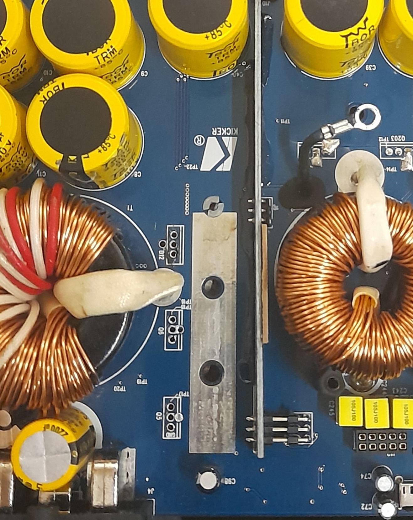

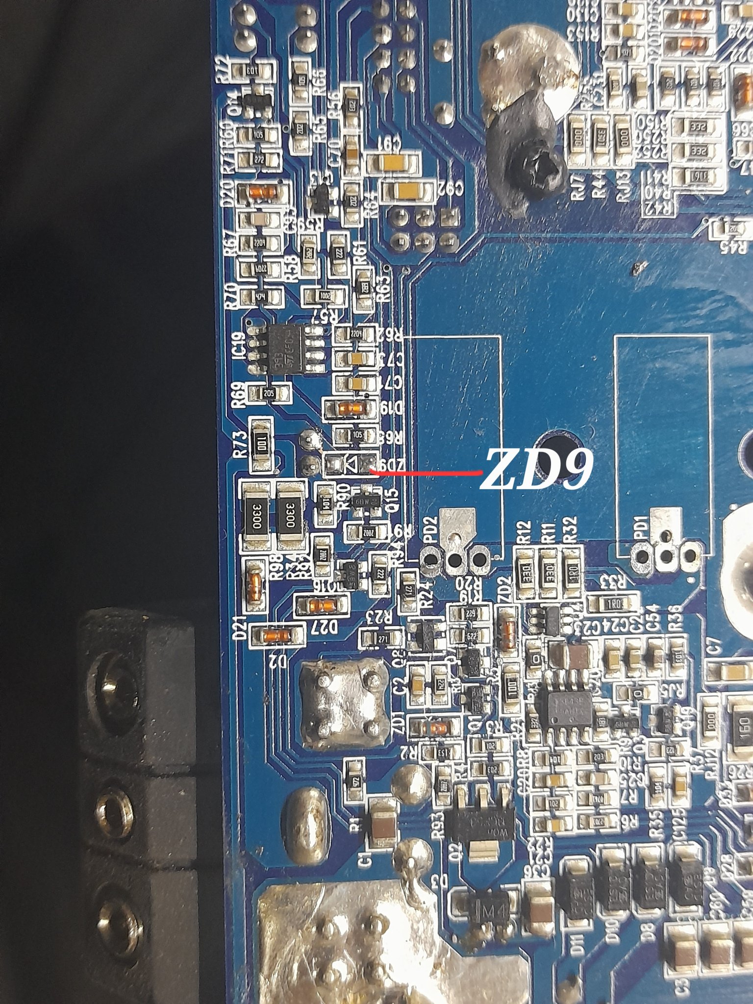

Circle it next time.. near bottom of pic, just right of center.
Are you sure it was even installed normally?
I removed it from pcb, zener was short circuit.Are you sure it was even installed normally?
Can you take a closer pic of just that area and possibly remove the mezzanine pcb on top board to get a picture of the same area on the top of main board?
Thanks, PapaZBill. Perry helped identify the part.
