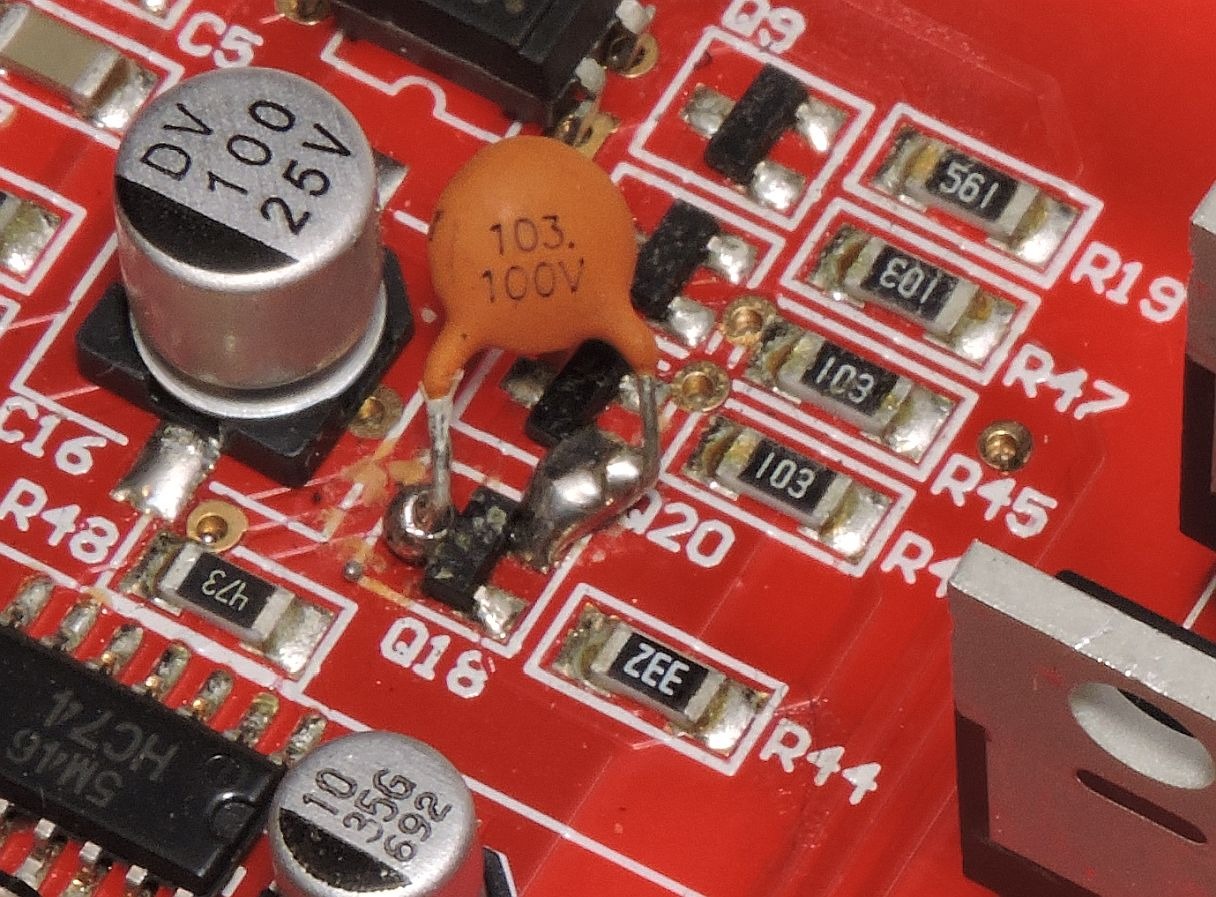

So I just got this Kicker 06 ZX1000.1 in as part of a partial trade towards other equipment. It’s “blown” is all I got, but power supply tested “good” via DMM on main terminals, charging caps, so I opened it up, safe to say I am the only one who’s ever opened this amp up in 16 years, all factory glue still intact.
I found the problem right away, you can see near recitifiers what looks to be “rods” near a hold down screw, found some stray wires near it and (yet again) looks to be the reason why this amp blew, making contact between those rods and the screw/heatsink. So far everything else tests good, removed all FETs and they all seem to be within spec. Inductor was bouncing around as well but still tests good at 200mH.
But I saw something I haven’t come across yet, so I asked other techs and was told it was prolly an engineer who did it, a “decoupler to reduce noise”? Per later board revision, components being unpopulated, and the fact all factory adhesives still instant, etc also pointing to a kicker engineer doing this.
My question is, is that little inductor marked 103.100v supposed to be connected from to pins on both of the BJTs as it looks? But it looks like it’s barely contacting one pin of the BJT the inductor is connected to ground. You can see in pic what I am talking about. Was the opposite inductor pin purposely attached to pins on both BJTs as it kinda looks or was it a quick job and the solder bled onto the other BJT as it also kinda looks like?
Any help or advise greatly appreciated, I’ll post more on physical board repair and other damage if I find any as I go through it. I only have JB weld on hand which it says it’s not electrically conductive and actually electrically insulative so going to use that. But ya this is a weird one for me, I only have maybe 10 boards Max under my belt and this is the first fine coming across an “engineering mod”.
Thx 🖖🏼
You can see the inductor in 1st pic, and the 2 pins it’s obviously supposed to contact, but is it supposed to contact the pin of the BJT the inductor is connected to via ground as well?
2nd picture is of damage, 3rd picture is the only one I could find that shows the area Undamaged, looks to me the rods just connect to that trace correct? There’s no trace on opposite side of board in that area.
Desolder the cap. Those 2 legs are likely directly connected by the board. Attached is a photo I have of the same amp.

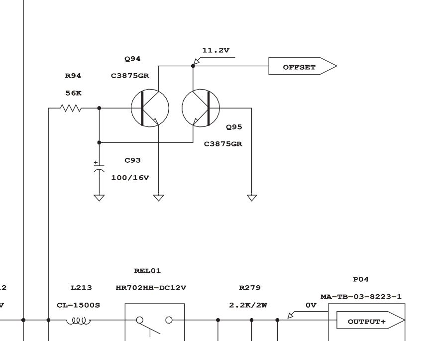

This may be the DC offset protection circuit. Attached is the DC offset protection from a different Kicker amp.

The added part marked 103 and 100 is a capacitor, not an inductor. 0.01uF @100v.

Ahh ok, so the it was intentional that one leg of the capacitor is connected to a leg of each 3875, it looks “barely” connected to one the legs, ty for clarifying with another pic.
