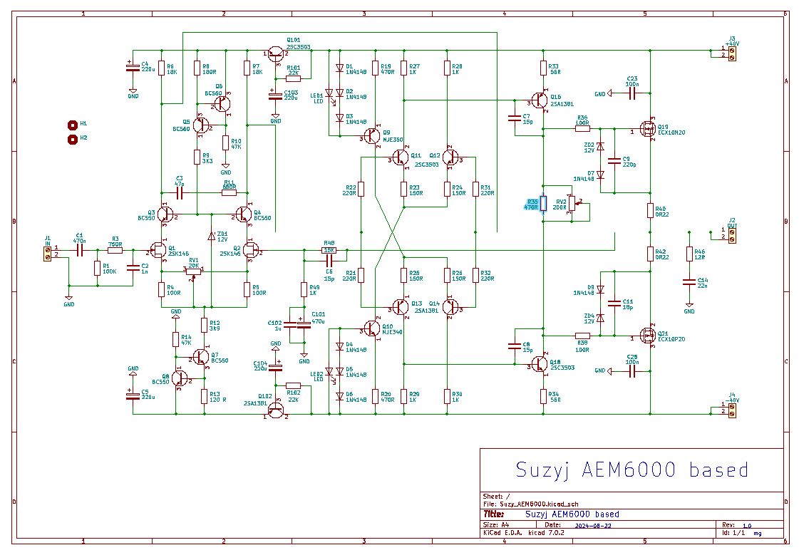

The only bug I find that annoys me, is that lines in schematics disappear on certain zoom levels. Only visually, but when I want a screen dump I often have to readjust the window. Different center point etc. No big deal, but annoying!

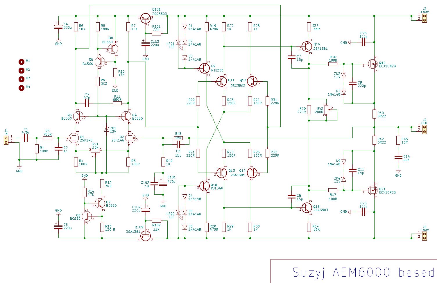

Jeff: The bug is not tailored to any spesific design. I happens all the time. I can produce it now, just a sec.
There are no missing lines in this schematic. DRC ok, and I am making a PCB now. Here is the one with no bug:

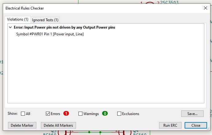

Can you advice how to turn off the search for simulation data in DRC?
Schematic Setup > Electrical Rules > Violation Severity. There's a big long list of violations there; any you don't want to see just set to "Ignore".
(Or the easiest way is to select an ERC/DRC error, right-click, and select "Ignore all 'xxx' violations".)
So easy!!! Thank you!
Now there is only one error that confuses me, see picture. May I use the same method here, or will that obscure other potential errors?
