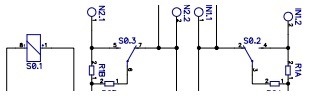

I'm learning how to use Kicad and have a jpg schematic for a relay attenuator where, for clarity, relays have been split into three sections, solenoid, switch1, switch2. Neat I thought. But how do I do something like this in Kicad?
A link to a site or tutorial would do. In part at least the problem I've had is knowing what terms to search for to find the information I want. I understand I could create the symbols myself, but don't know how I'd link them together so that for the pcb I'd have a single footprint. Or even if that's the right approach.
