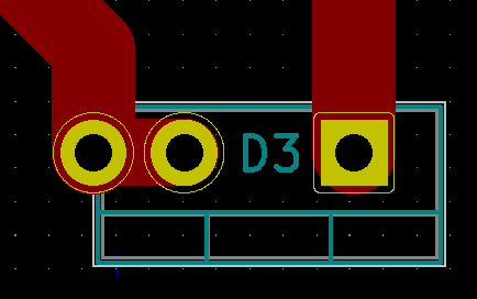

I am trying and failing to make a layout for a diode that can take both vertical TO-220 and horizontal like 1n4007 diodes. I've seen people do it on boards, but can't find an existing layout or come up with an easy way to do that. It is basically keeping one square pad and make a duplicate further away for the second round pad on the layout. Any suggestions?

Just make up a new component with both components in one.
Add pins for both then wire in a parallel when it comes to schematic and pcb.
Alternative just use two separate components.
Yes, separate horizontal and vertical footprints would be best when laying out a board.

Long ago in Tango I just made multiple components for TO220V or TO22H and then use what was needed.

One of the neat things about KiCad is that if you have multiples of the same pin in a footprint, KiCad is clever enough to connect the net to all of them, so for that one you just create a component (start with the TO-220 footprint) and add extra pads. Number them the same as the pads that are already there and they get automagically connected in parallel.
But no so good if you accidentally mis-number two pins the same ?
I would have thought even a basic syntax check would throw that out as an error.

And it's fantastic being able to have multiple pads with the same number. Now I can have connectors (like for example the Keystone 7795, which has four pads on the PCB for one connection) without having to build a specific schematic component. I just use a normal 1 pin connector in schematic, and label all four pads pin 1, and off I go.
