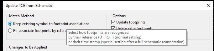

"The update PCB options gives you two options to update by reference - if you keep them the same. Or if you do re-annotate the schematic, say to tidy up the references if they are random after lots of changes, you can update by timestamp (although I think the name has changed, it's the other option), and then it will associate parts by when they were created instead of the reference."
But you would understand how powerful that can be if you use the software.
Not sure I understand this, maybe I am missing something. Let me explain what I understood.
If I change R4 to R56 and C34 to C3 on the schematic, I want that to be automagically reflected on the layout, and that is what I am used to and don't even have to think about. Same thing when I do similar changes on the layout, I want them transparently reflected on the schematic.
I can't think of any circumstance that this would work in a way that it doesn't update the other side but instead tells me a part's timestamp. What good does that do me??
But, again, maybe I misunderstood your description.
Edit - I think I get it. If you change a ref on the schematic, the layout part keeps track of what is what by looking at the timestamp. OK, yes that can work, and in the end it is all data base management anyway ;-)

KiCad lets you do that with Unique ID/timestamp update - if for example you re-annotate the PCB.
It also allows you to go through and replace parts by deleting the original parts, and put in new ones from the library - so you lose the unique ID. If you rename them to the same reference then update using reference they stay the same. I have used it before both ways, depends what works out quicker.
But if you try and do both on the schematic at once, so re-annotate and also change parts, you will break the PCB layout. But that would seem like a stupid thing to do, even on top end software I tend to take baby steps and save after each successful step (or undo, close/reload if not...) , otherwise it will go wrong, whether it's mentor or altium or anything else.

Well, I'm not entirely sure I understand what you're saying, but......
If you simply change the annotations on, say, resistors or capacitors, KiCad updates those fine with no layout changes. BUT if you made an error like I did, where I reversed the pin functions on my ICs, KiCad gives you new footprints to re-position and you must remove the old ones, put in the news, and re-route. I suppose if you could place the new footprints (with the corrected pin references) EXACTLY where the old ones were, you could just re-route those pin wiring connections; but I don't know how to do that, so I just removed the old traces to the IC, removed the IC footprint, and put the new ones in, and redid its traces. Anybody got a tip on how to do this better? I don't know what other PCB layout programs do, as KiCad is my first attempt at this.
"KiCad gives you new footprints to re-position and you must remove the old ones"
Depends how you update the PCB, previous link I posted (post 47), gives a lot of useful information.
If you change part annotations/references, and do an update, the default option now looks to update parts by unique ID, so it will work as you said.
If you change a footprint on a part, but you keep the same part on the schematic, you need to enable "Update Footprints".
If you deleted parts on the schematic, but replace them and change the reference to the old part, then you need to use the update option to re-associate by reference on the PCB. But if you also change the footprint you need to enable "Update Footprints".
If you delete a part on the schematic, and replace it with another - which ends up with a different reference, then it will put it in as a new part on the PCB. But if you do not enable "Delete Extra Footprints" the old component footprint will stay in the same place until you delete is manually.
Easiest way to work it out is take a copy of your project, and just go nuts playing with all the options. Then you'll figure it out.
