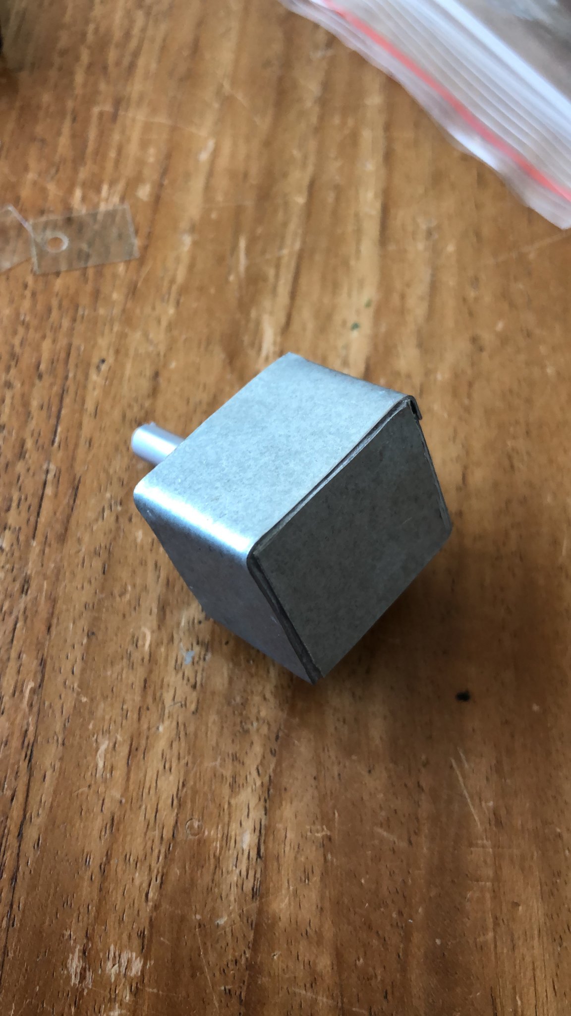

S santitrucco Member Joined 2004 2022-07-25 3:38 am #1 2022-07-25 3:38 am #1 Hi friends. I have this Khozmo Stepped atenuator. For what purpose is this connection? Attachments IMG_20220724_233825.jpg 89.7 KB · Views: 142 gary s Member Joined 2002 2022-07-25 3:59 am #2 2022-07-25 3:59 am #2 Connects the attenuator metal body to GND/Earth. jean-paul Member Joined 2002 2022-07-25 6:51 am #3 2022-07-25 6:51 am #3 Indeed. Not using it may cause a humming device. Some other potentiometers lack shielding but it can be solved DIY. Attachments 23B2A232-FDED-4D9E-A3AB-7D20215CFDC3.jpeg 266.2 KB · Views: 74 You must log in or register to reply here. Share: Facebook X (Twitter) LinkedIn Reddit Pinterest Tumblr WhatsApp Email Link
