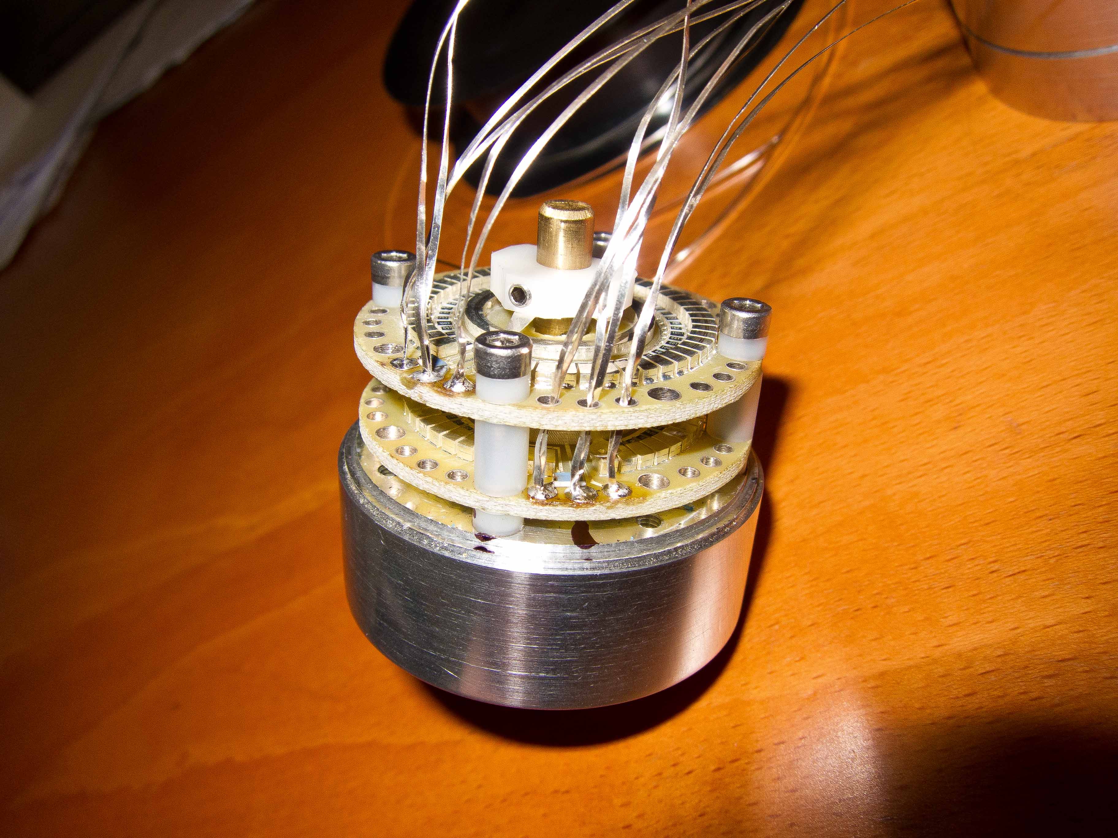

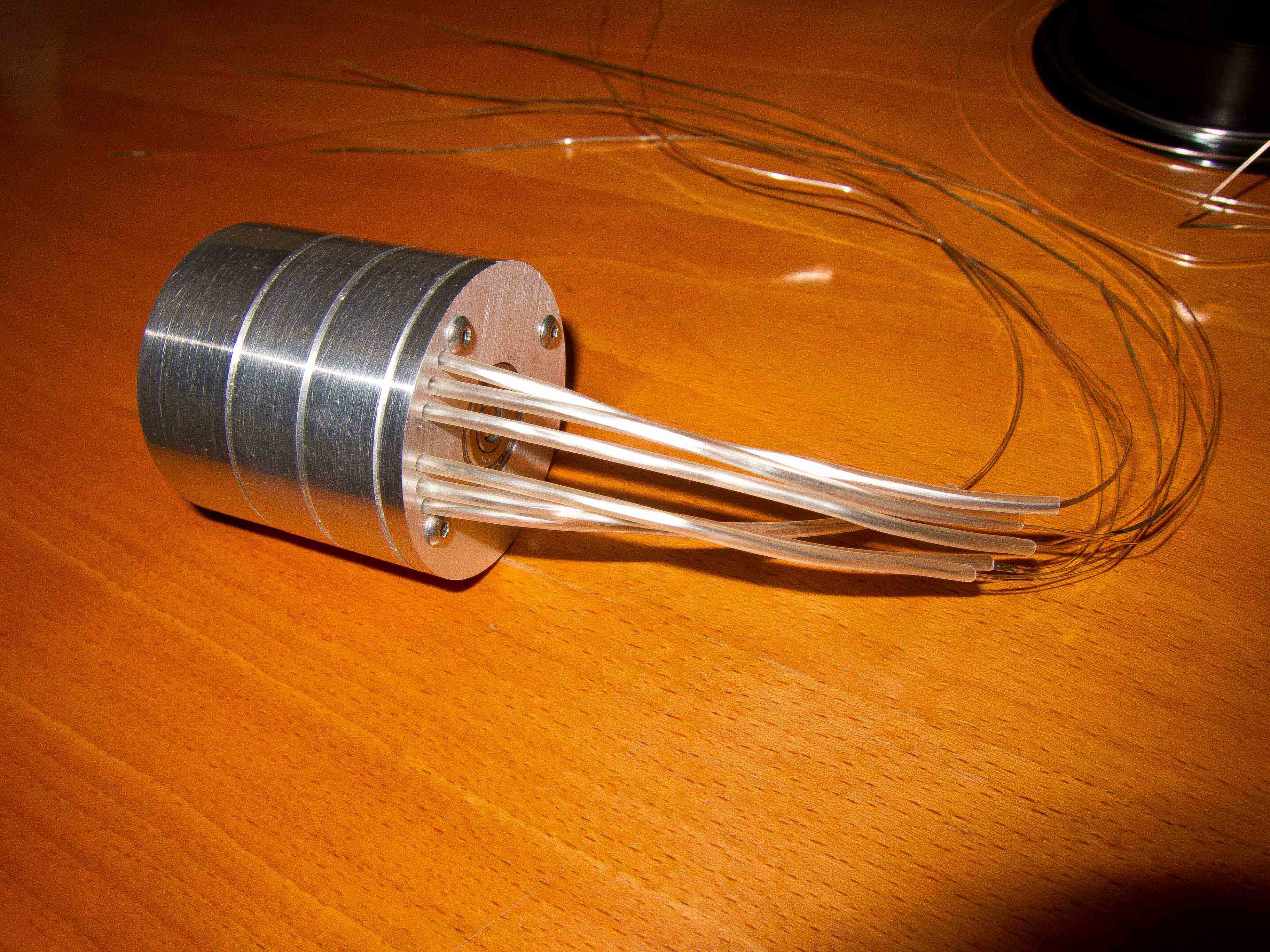

I purchased a 250K stereo from Partsconnexion around Dec 2011 but never get a chance to use it until recently. It sounds great when compares to ALPS but the clicking noise do border me when you turn the knob. Could this be an isolated manufacturing fault or it is the same across the board?

it is the same across the whole range, due to the single-point wiper contact... but the clicking noise does not give me (or my customers) any grief...
I have obtained great result with Khozmo shunt types used with pure silver ribbons as a hook-up wire. The wiper pressure and the contact angles can be adjusted as well to minimise clicking effect and contact resistance.

Check the photos I attached above. It is very easy to adjust the viper position, and the amount of pressure. Did you open the attenuator?
