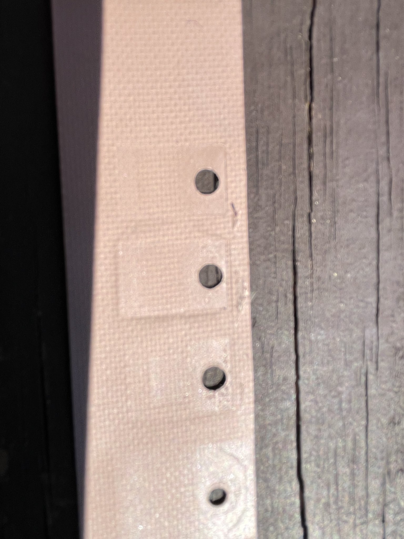

Keratherm or “dreck”?
This came from a a very large commercial UPS.
Had bunches of TO-247 and TO-220 devices
attached to a large heat sink. I doesn’t stretch
and has fibers (see photo) embedded in it. If it
is Keratherm would it be better than the Alumina
Ceramic insulators that I have on order now?
Sorry if this is in the wrong forum but I am in
process of building an Aleph J. I’m a little lost
If it doesn’t have a glowing filament inside it.
Best Regards, Mark
