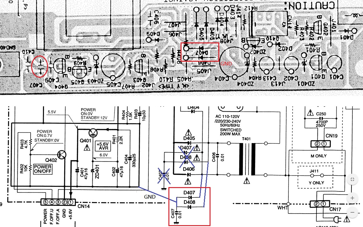

X xavirom Member Joined 2009 2020-04-05 11:29 pm #1 2020-04-05 11:29 pm #1 Hi. Can someone explain to me how this font works, I don't understand what the negative is. Where does the current return from the diodes D405 D406 connected to the secondary of T401? Thank you Attachments STD BY kenwood_kr-v5080_5580_6080.pdf STD BY kenwood_kr-v5080_5580_6080.pdf 189.9 KB · Views: 56 P patrick101 Member Joined 2015 2020-04-06 5:25 am #2 2020-04-06 5:25 am #2 It is a mistake in the schematic diagram. It is always happened, we have to double confirm with the PCB. Attachments t11.jpg 424.7 KB · Views: 71 X xavirom Member Joined 2009 2020-04-06 1:40 pm #3 2020-04-06 1:40 pm #3 Hello Patrick, it is correct, the circuit in the service manual is wrong, I did not imagine that this could be wrong. Thank you. You must log in or register to reply here. Share: Facebook X (Twitter) LinkedIn Reddit Pinterest Tumblr WhatsApp Email Link
