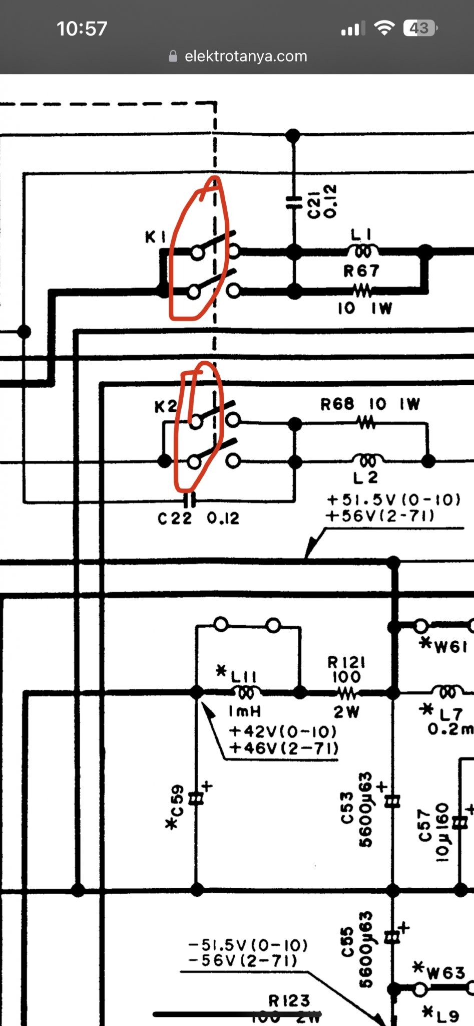

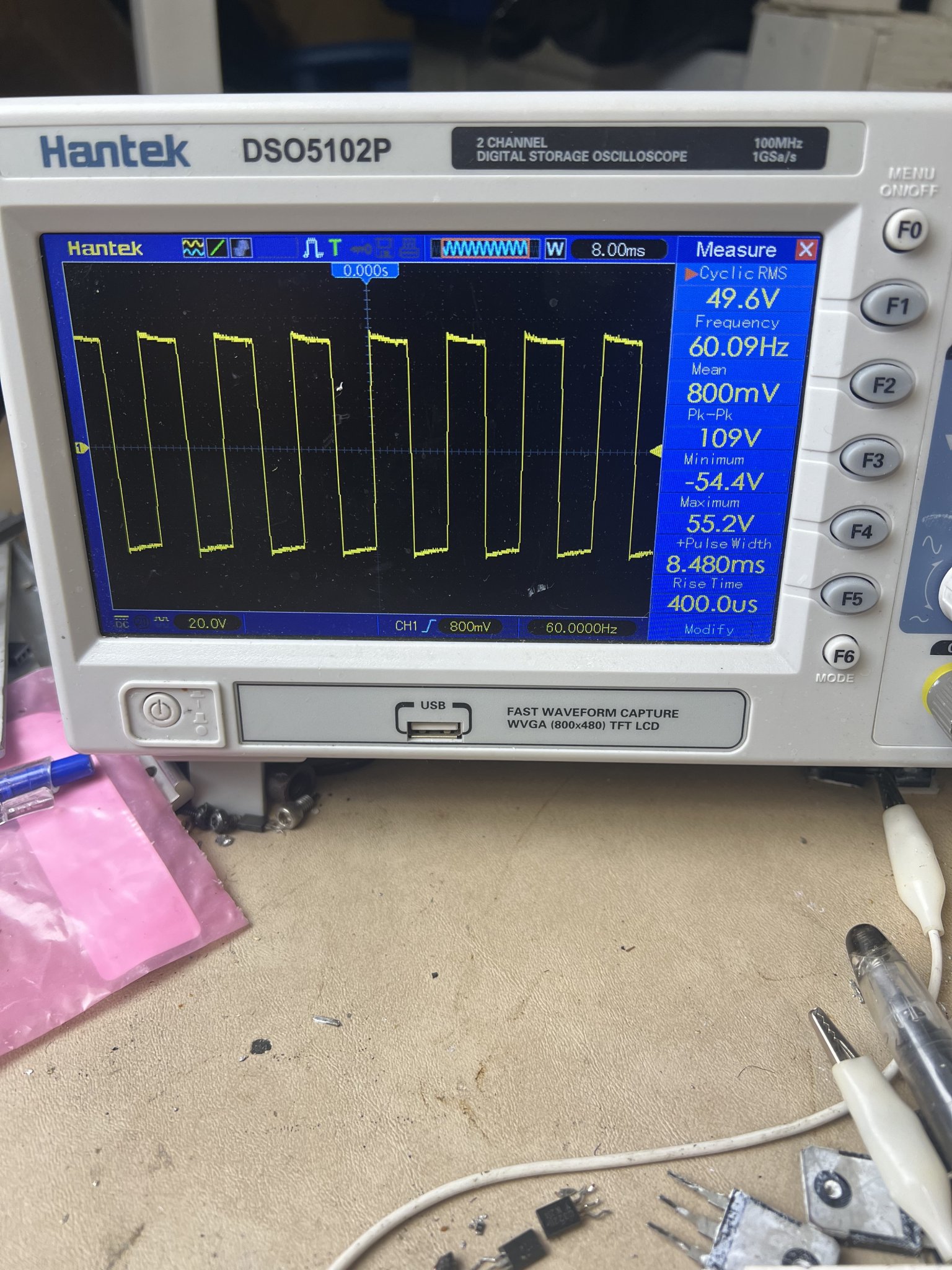

Im working on a Kenwood and repaired a lot on the crossover board and currently stuck. I have +-16, 20 & 55 voltage now and a perfect sine wave on left and right channel CEN3 but when I probe the outputs I have a square wave on them and nothing on the speaker terminals. The relays engage on turn on also. I think it’s a ground issue but can’t find where ground is missing. The attached image is what’s on the outputs it stays like this rather sound is playing or not.

No with the signal turned down the square wave still is present. I’m confused about 0hms across the speaker terminals. Are you referring to black probe on negative speaker terminal and red probe on positive speaker terminal do I have 0 ohms?

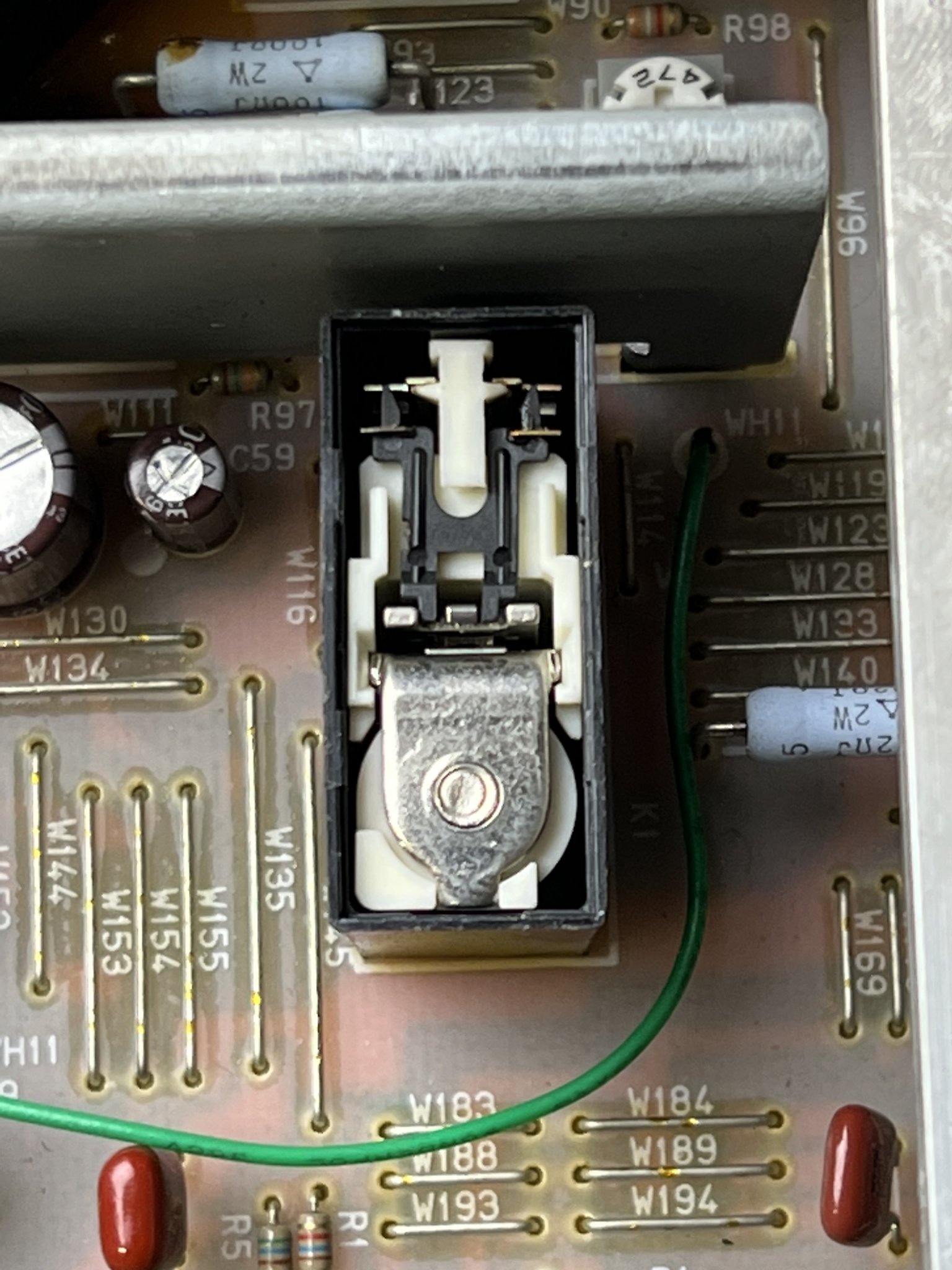

I just noticed a difference between the two relay coils. One relay has 50volts and 25 volts across the coil. The second relay has 25volts and 2 volts across the coil. I can’t figure out where the missing 50volts should come from.
