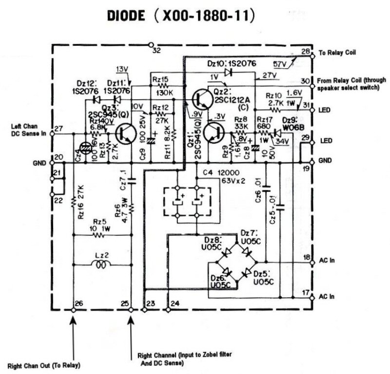

Check/ replace the diodes and caps on the relay circuit. You should be good to go. Both cause buzzing when failed/ aged.
That would be a start, but the buzzing is the relay not getting enough voltage to turn on. Two common causes are a weak driver transistor for the relay, and a failing protection diode that is mounted (electrically) across the relay coils to protect the driver transistor from inductive spikes as the relay is turned off.
The diode is mounted at the rear near the relay, so that's not a problem. The driver transistor is mounted on one of the boards that the four large power supply caps are soldered to, and is a major operation to get to and replace. If you go to this much trouble, it would be pretty foolish not to replace the three small electrolytic caps on it.
One last thing I just remembered is that the speaker select switch is part of the current path to the relay (on a working 9100, you'll note that the relay turns on and off between speaker selections when moving the switch). It is possible that you might be losing a bit of voltage through this switch...clean it.
Here's the board the driver transistor and protection circuit is mounted on...

Thanks also for the circuit schematic. I'm saving it for future reference.
