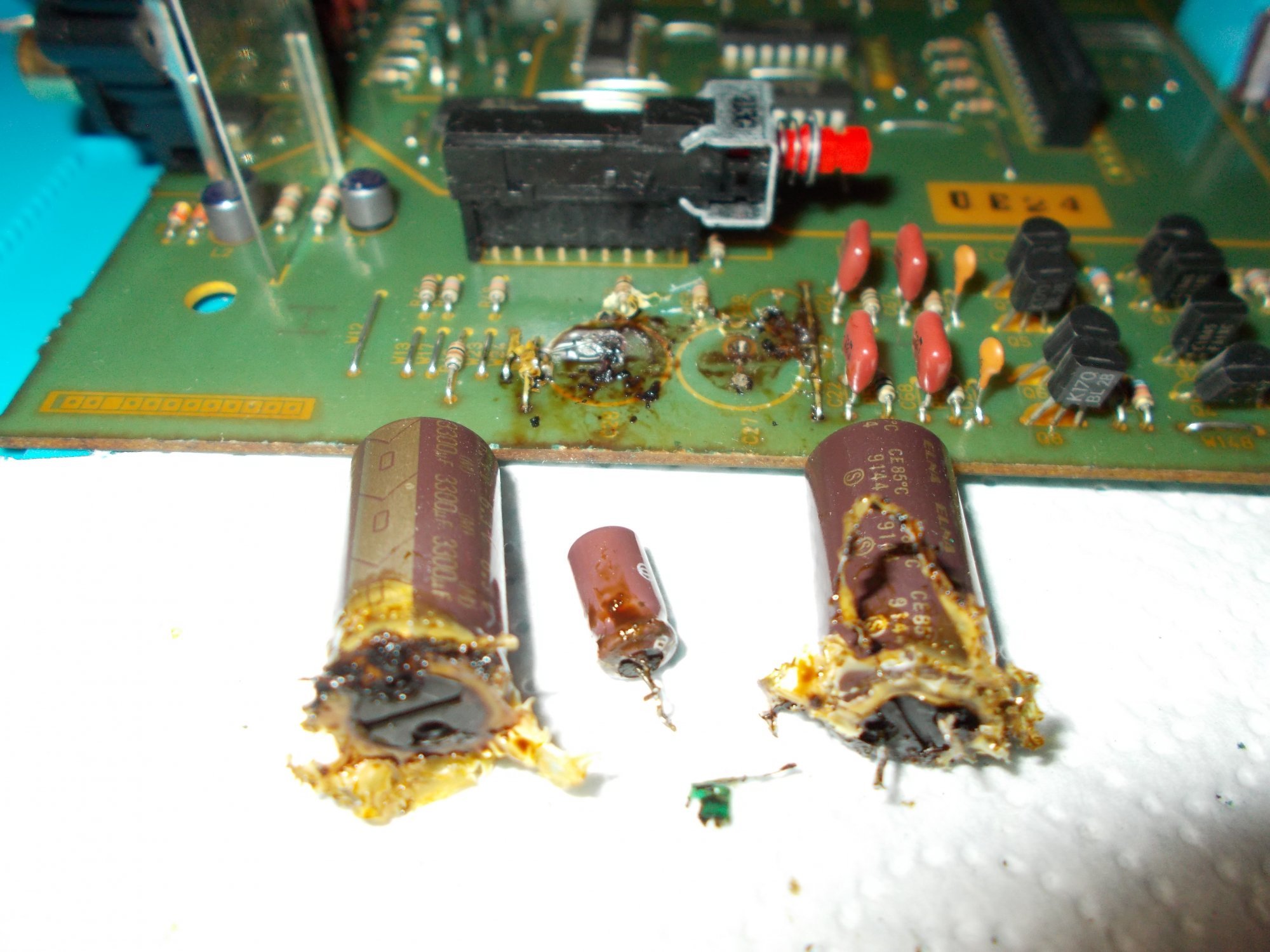

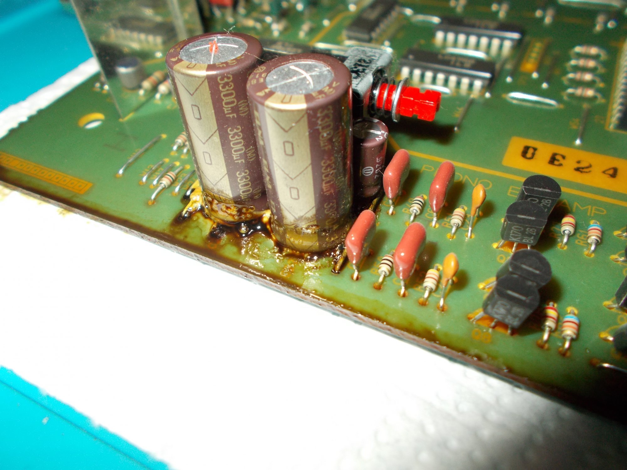

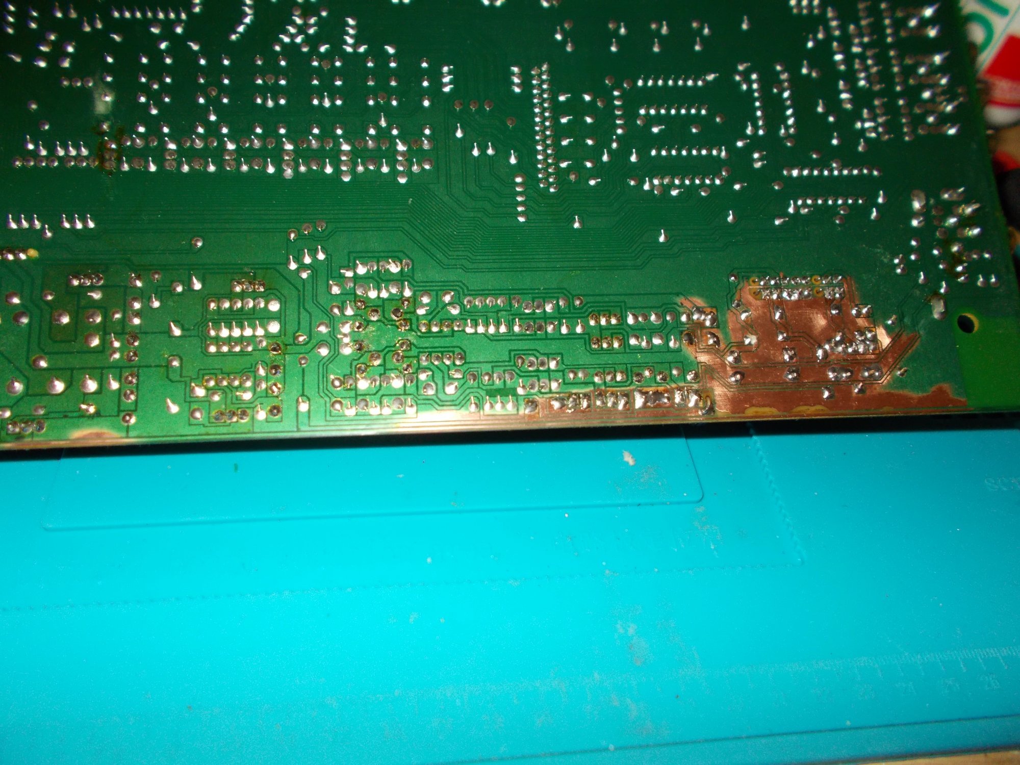

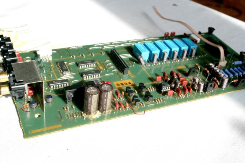

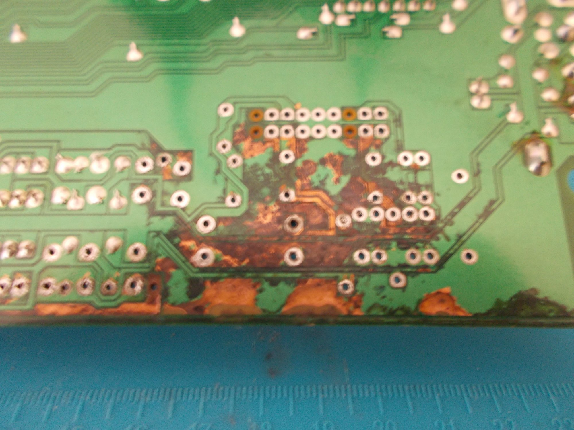

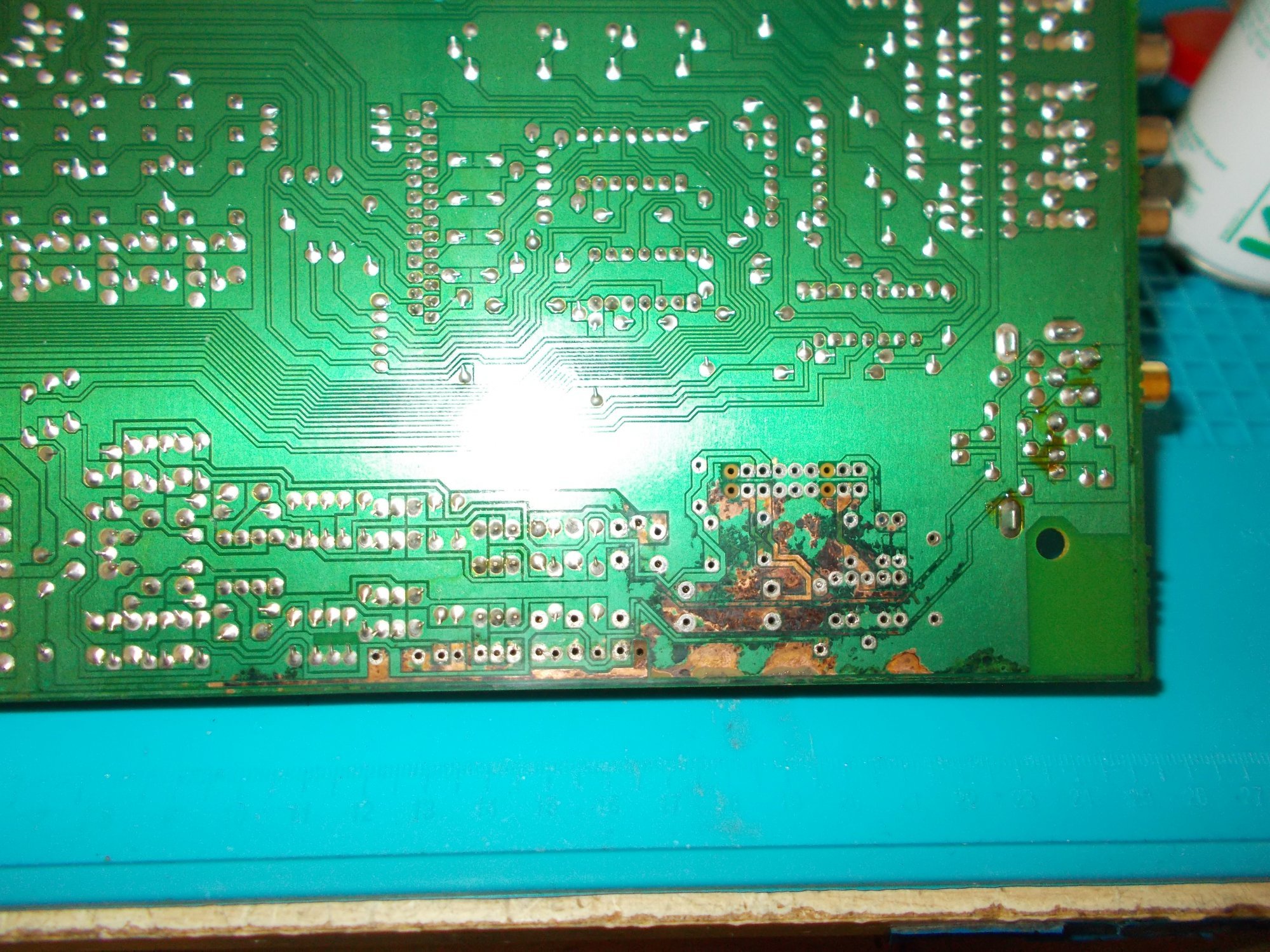

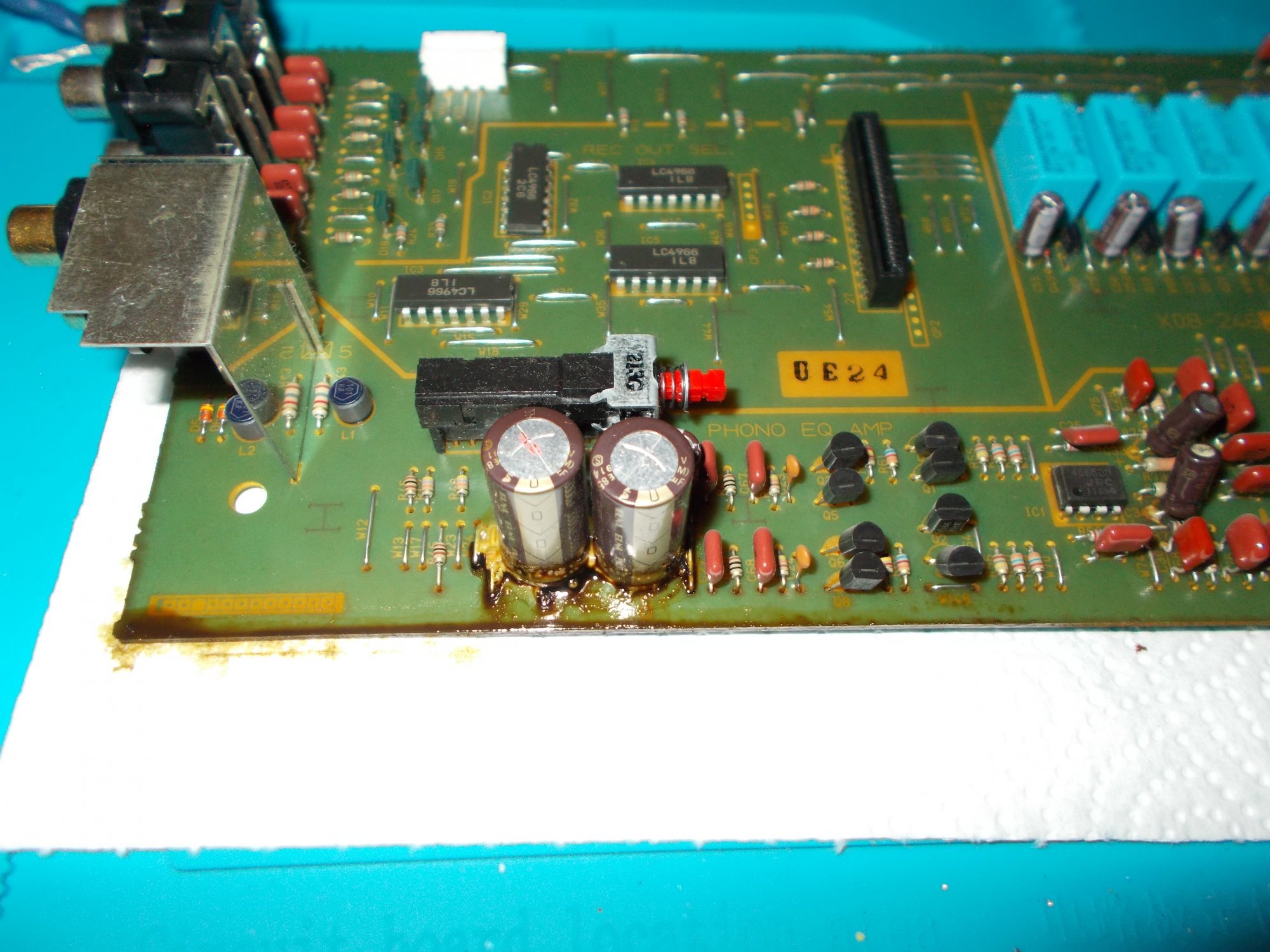

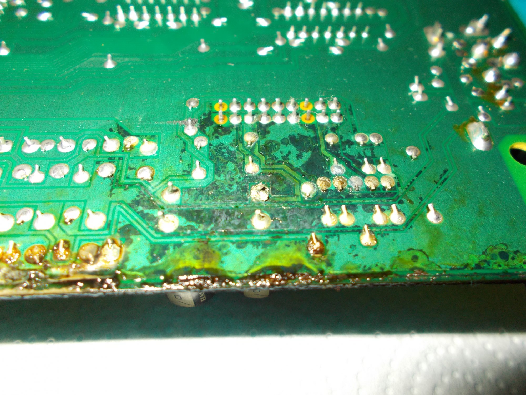

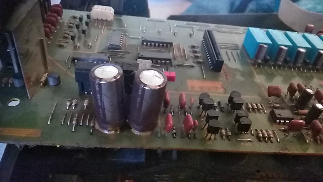

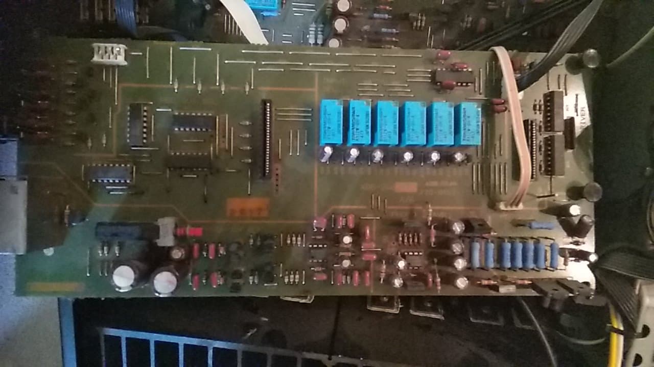

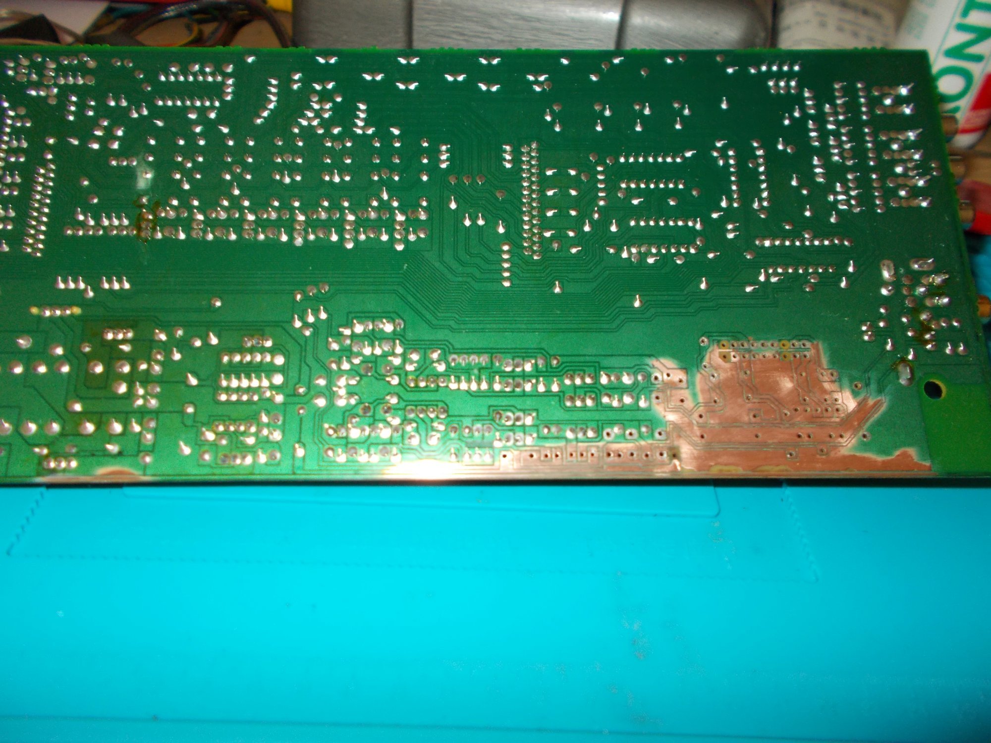

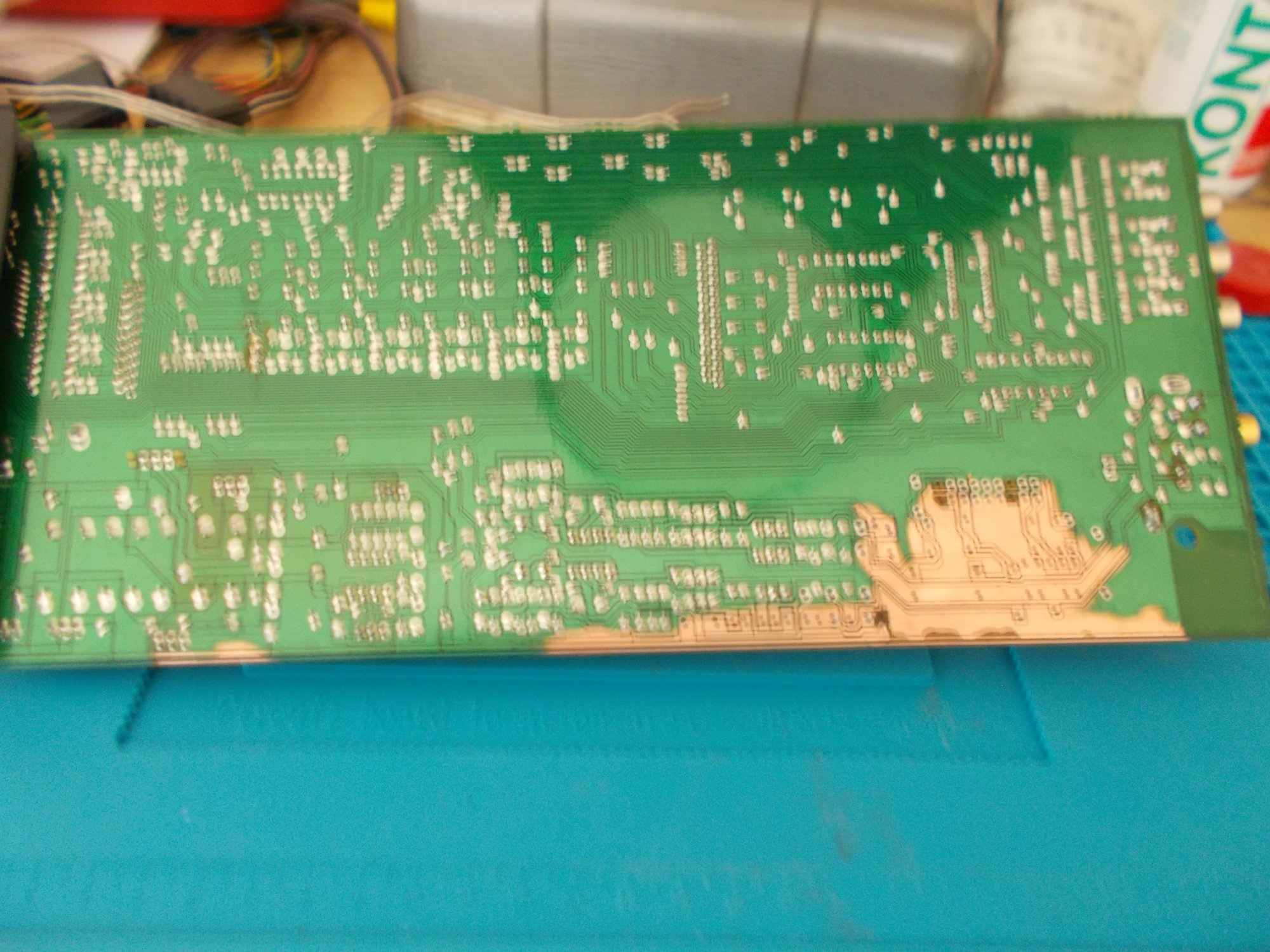

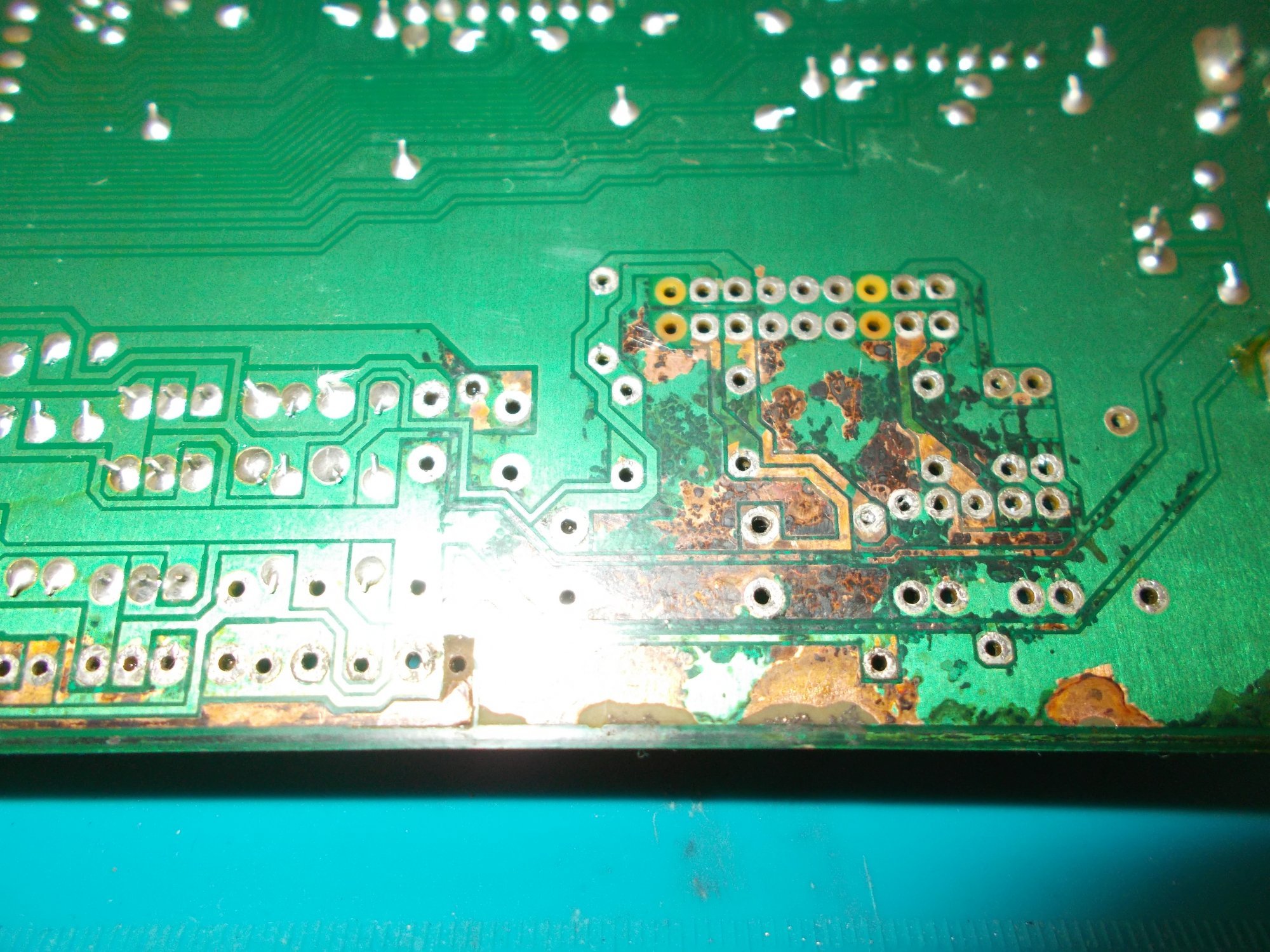

Description of a refurbishing procedure and various images concerning replace of bad caps (leaked caps):
https://ftbw.de/xp/amplifier-xp/kenwood-ka-5040r-02.html
Does anyone know why these ELNA capacitors started leaking?
Unfortunately many brands were equipped with these ELNA capacitors such as CD players, DCC, cassette decks, MD players and amplifiers, also the SONY ESPRT series.
