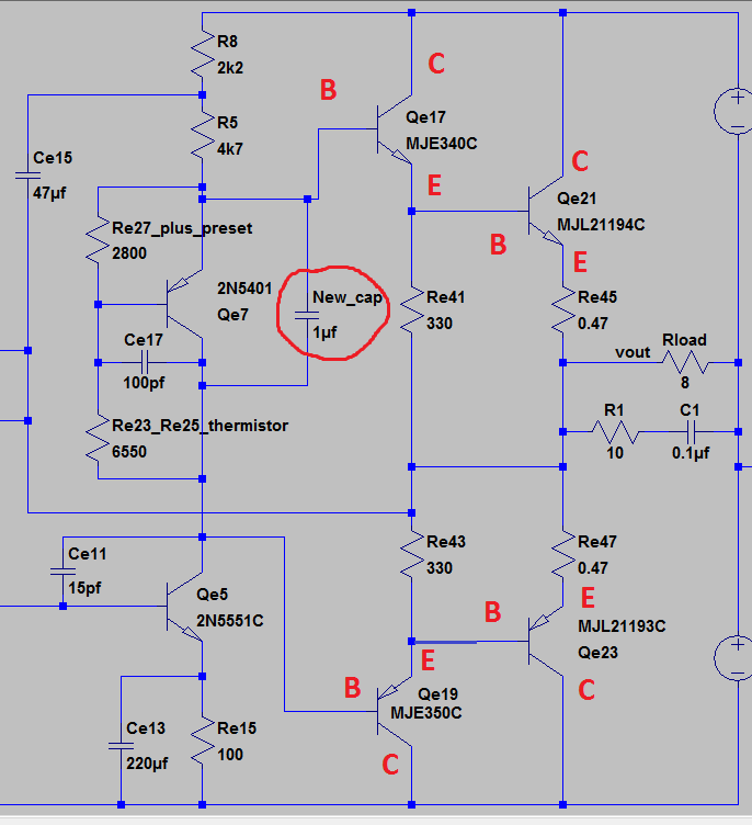

So here is the plan.
I've had another think on this and come up with some slightly different ideas. We will get this to work 🙂
1/ Isolate, and then test your output devices.
For Qe21 (the NPN) and Qe 23(the PNP) there should be no reading between C and E with the meter leads either way around. Do that test on a "high" ohms range (that is the range you might measure a 1 meg resistor on). That will show any leakage that the diode range may not. If you now switch the meter back to the diode check range you should read around 0.5 to 0.7 from B to E and from B to C on both devices. The NPN will read when the red lead is kept on the base, the PNP when the black lead is on kept on the base. Reverse the leads and there should be no reading.
If they both pass those basic tests we use them. The outcome of that depends on what we do next. Obviously if they fail then we have to fit the TIP outputs.
Question...... how many of the TIP devices did you get ? Was it one or two pairs ?
Also do you have any small low voltage electrolytic caps say around 10uf 16volt (or higher). I'll assume yes to that 😀
3/ So depending on what you have parts wise, here's the plan...
If the original outputs are good... then I'm going to go with my instincts and suggest we get the TIP devices to function as the drivers replacing Qe17 and Qe19.
You also add the electrolytic across Qe7 between C and E. Just tag it on to the print under the device. Positive end to E (that's Re19) and negative end to the collector (Re23 end). The value of the cap is not critical, 1uf, 10uf, 47uf, all should work the same. Its function is to maintain a low impedance at AC between these two points and aid stability.
Bias preset set to 1k, and again we test by bringing the voltage up slowly. NO SPEAKERS attached. Assuming its OK you check the DC offset (voltage across the speaker terminals) and confirm its below 100mv. As before, use the bulb tester at all times.
If that is OK then its bias time again 😀 See if the bias adjusts... if it does not then again we check the voltage across Qe7 (same as across the new cap) and confirm it is actually altering with the preset. If it is then its the same routine as before. We drop the value of Re27 by degrees.
That's probably enough to be going on with for now. 10 minutes work tops 😀

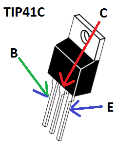

This shows the pin outs for the TIP41C (the TIP42C is identical) Be aware that the metal tab is internally connected to the collector so don't let it short to anything.
The other diagram shows the cap location.
The TIP41C replaces Qe17. The TIP42C replaces Qe19.
Check and double check that they are in correctly. Refer to my picture of the pinouts and confirm with your meter on ohms that each pin goes to the correct point on the circuit by measuring to one of the components it is supposed to go to.

Yes, the TIP's are output devices but can also be used as drivers. I did some more work on the simulation of the amp to see how it all looked............. we can come to that later if need be.
I would still fit the cap I mentioned even with the 2N drivers fitted.
Then its test as before. No speakers and just see if the offset is correct and if the bias adjusts OK.
