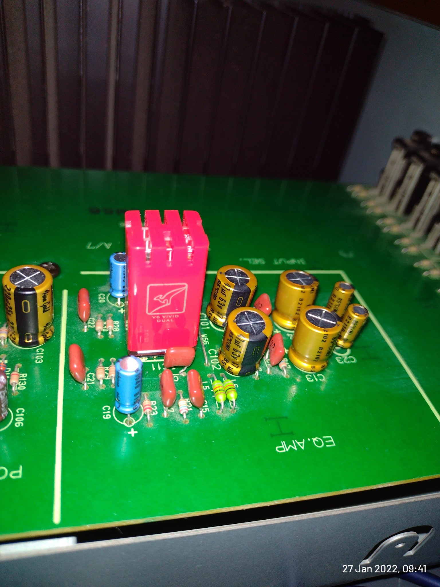

More info regarding the Burson. I've done a noise floor test which shows this has the lowest so far of the opamps tested.
This can only be a good thing.
To my ears this opamp provides the best balance, clarity, soundstage, depth & musicality so far, albeit at a cost.

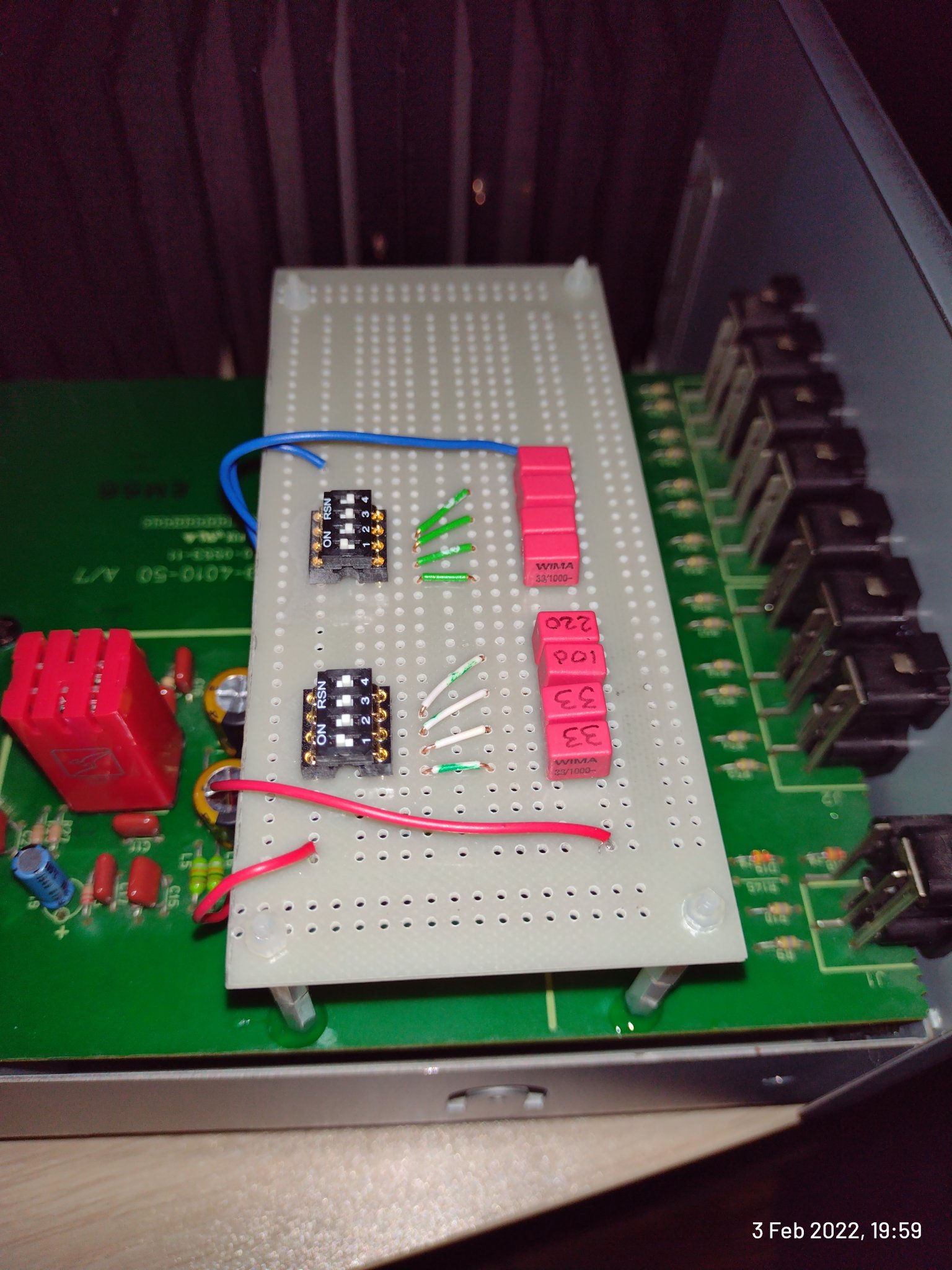

Decided to add a switchable capacitance board to the phono input, in order to be able to fine tune for different cartridges, see below.

The Burson V6 vivid, where do I start.
The improvements over the previous opamps are quite remarkable in every sense.
The detail that is revealed is quite astounding, especially in quieter tracks, probably down to the lower noise floor.
It appears to be far more musical in its presentation & slightly on the warm side which is how I prefer it.
It takes a good half an hour for the sound to settle into its stride which I guess is down to the components reaching optimal temperature.
Aa a side note, I did not notice any change from the burn in process.
The bass is very clean & punchy.
Mids are full & engaging.
Treble is clear & sharp without being over taxing.
The soundstage is broad & full.
It provides increased depth & dynamics therefore making the music more involving.
So in conclusion, this is a cracking modification even with its fairly high cost in comparison with IC opamps.
It definitely requires a decent source to provide it with the goods to work with.
At the end of the test I have done a bit of testing by changing the load capacitance seen by the cartridge.
The Shure can sometimes be a little bright on some tracks, by lowering the capacitance to the lowest value of 33pF in the amp.
Testing the leads & tonearm cabling which came to 88pF, this gave a total of 121pF. This appeared to cure the over brightness on those tracks.

I will return the amp capacitance to 100pF for the Sparkoslabs tests, which I will do next.
