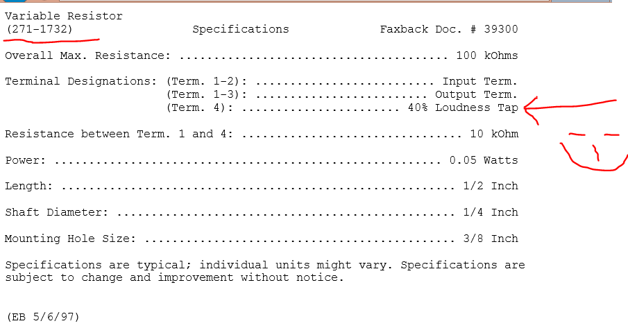

This is a typical 100k stereo volume control with a loudness tap. The only question is the mechanical fit.
It could be hard wired to the pcb since the two sets of terminals are on opposite sides of the control.
Radio Shack has an Alps that is very close, other than the terminal placement. The knob may even fit properly.
100K Dual-Ganged Stereo Volume Control - RadioShack.com
As rayma says, you should be able to make something else fit - even if it looks a little messy - the Radio Shack one looks pretty close though.

The Radioshack component looks a good replacement, with a little wiring to the board and a bit of filing etc it might well fit 🙂

Had a look at the schematic from the link supplied by Rayma (thanks)
Kenwood KA-3020 Manual - Stereo Integrated Amplifier - HiFi Engine
I wish I'd had a better look earlier because it states the volume pot (VR4) as 100KB ...linear 🙁 ... I'll start looking for another one 😉
Either way I'm confused as to which terminal is which.. and where to connect them ?
