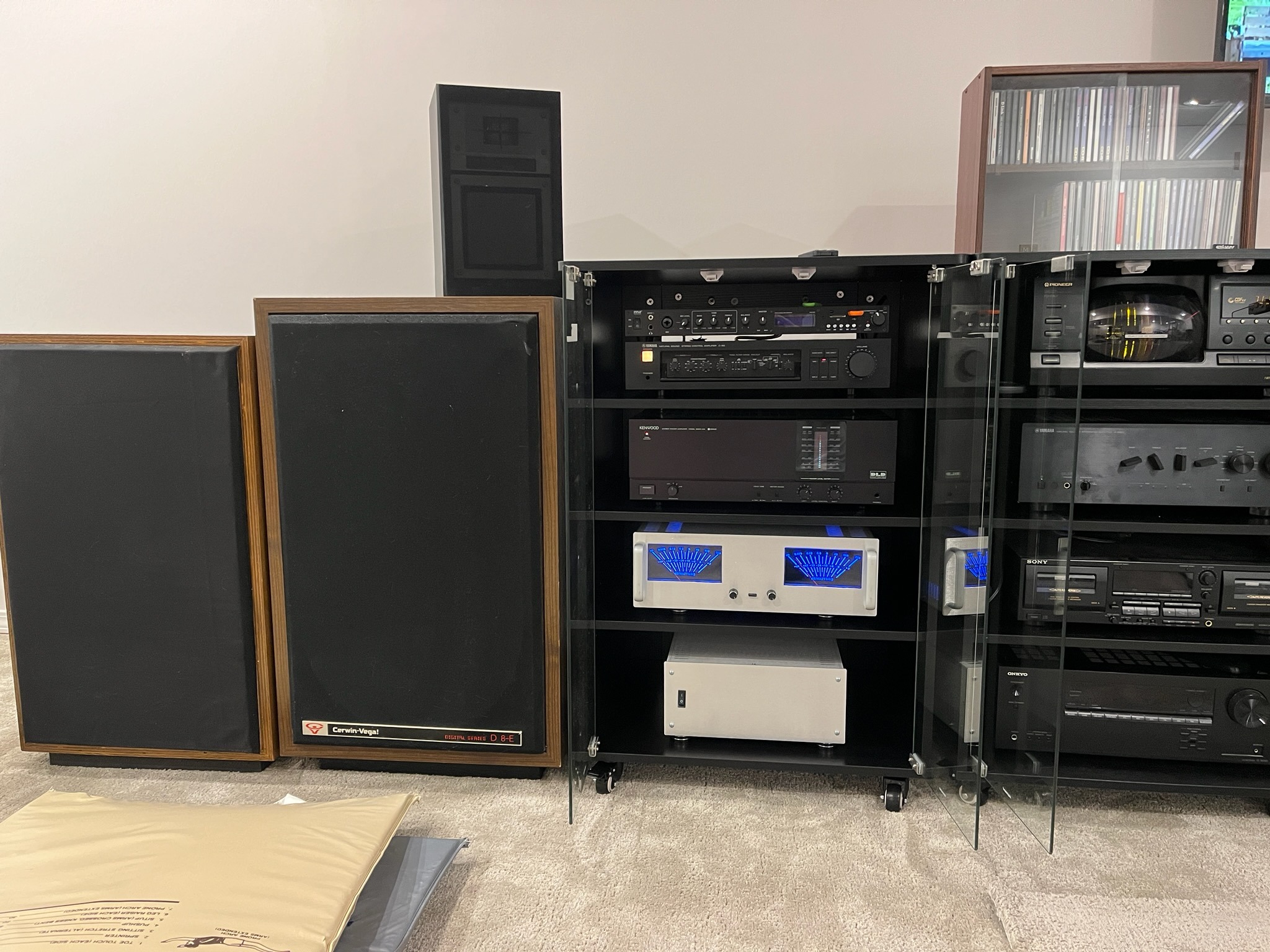

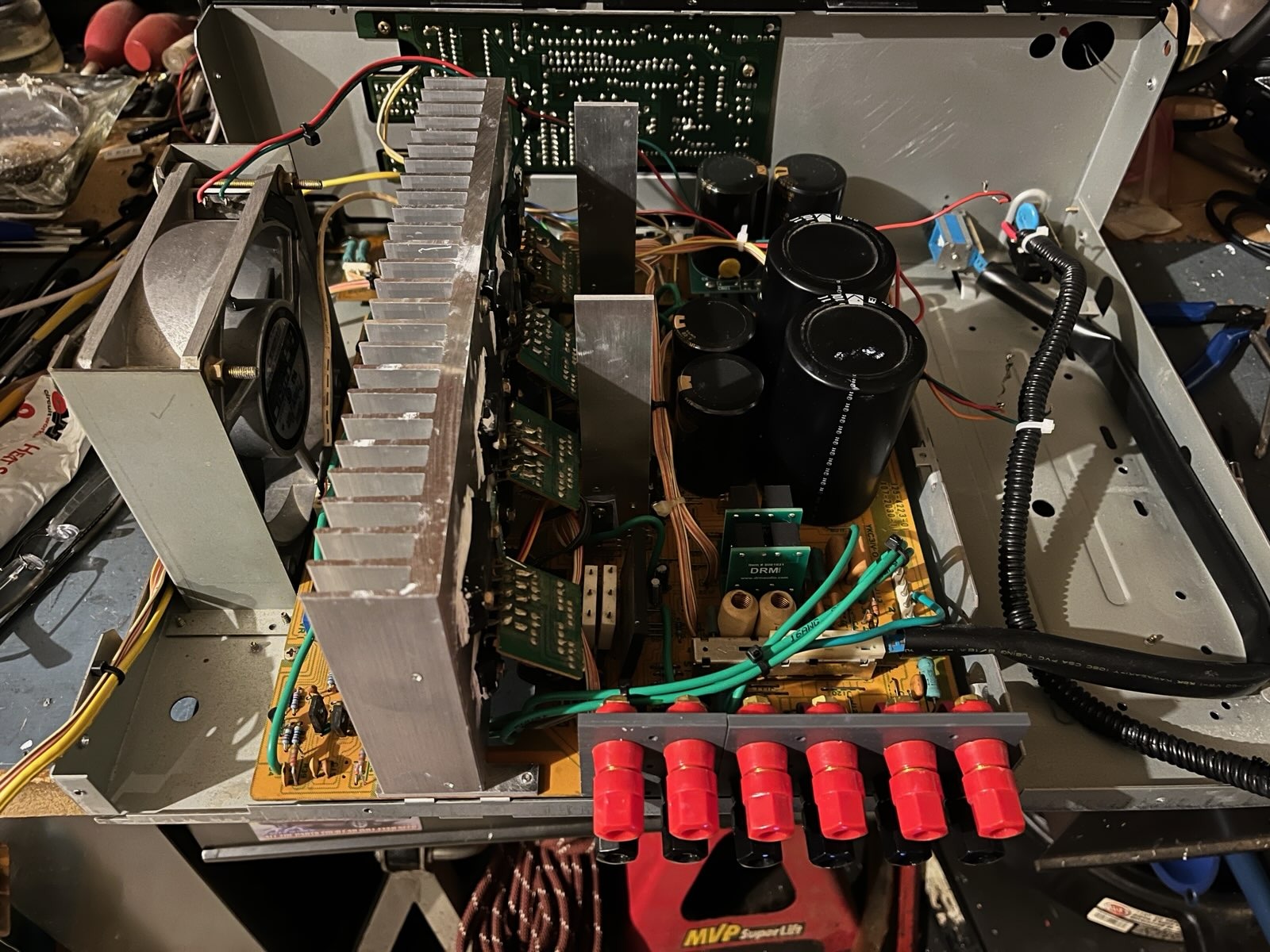

After finally setting up my listening room and using the Cewin Vegas, I really don't like the sound of the new NJW1302 and NJW3281 devices and the new 2SA1943 and 2SC5200 devices DRM used in this kit. I decided to use the new heatsink and drill/tap new holes and put the original output devices back in. They are the DAT1018N, DAT1018P, DAT1521N and DAT1521P. I also put the original Large 100v PS filter caps back in.
It now has a way better sound and not so harsh. Maybe with a better selection of replacement devices, it may have been better but It sounds fantastic with the originals back in. Glad I went through the pain of doing it...
