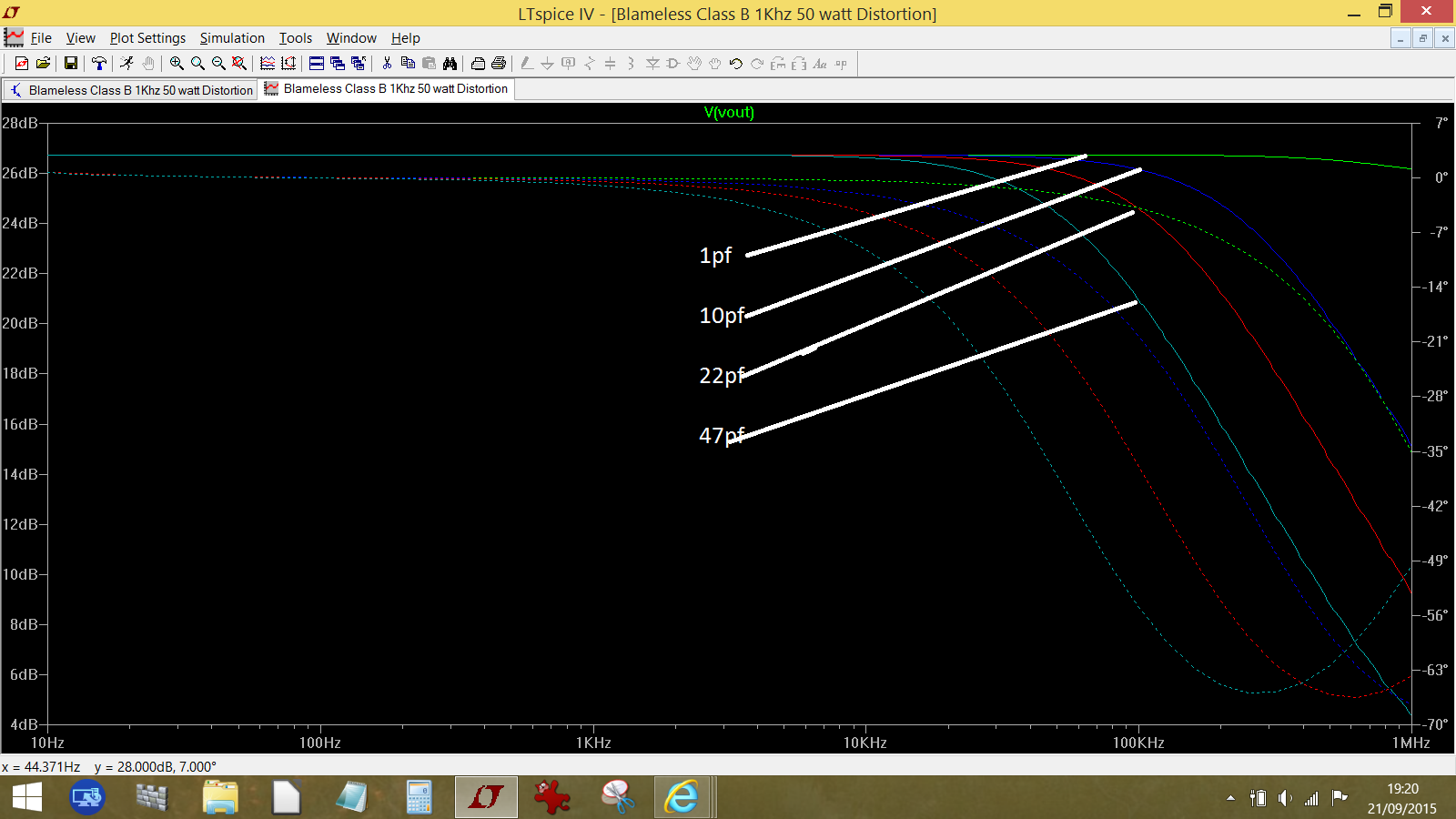

That all reads as if the stability is very marginal and totally dependent on the exact semiconductors being used. This is something that crops up a lot with older Japanese gear unfortunately.
This shows an amp with the same feedback components values as yours and the response with 1, 10, 22 and 47pf caps across the 56k feedback resistor. This is a wide bandwidth amp, yours may or may not have the extended response of this one in which case the effects will all tend to be much less as the bandwidth is limited by other aspects of the design.

Awesome..thank you
does this imply that if I put the circuit (or the driver and output part at least) into LT spice I can simulate the conditions?- and LT spice is something I am learning-

Yes, trying it in LTspice could be instructive as a means of exploring the stability margins. The current limiters have zero effect until they are triggered.
Does this amp use a zobel network on the output ?
Miller capacitor C9 looks like it is too small to do any real good. Especially if you've changed drivers and/or outputs for something that has a different Cob or Cbe.
Making this cap small is a trick to get high slew rates, but that comes at the cost of having to keep a close eye on all the non-dominant poles. Without really good models, good luck in nailing those down. The whole reason for making the Miller pole dominant (that is, low in frequency) is to reduce this sensitivity.

Excellent stuff :up: It does indeed sound to be very sensitive regarding its stability margins. Simulating it would certainly let you see the effect of altering the caps though, even if the basic instability didn't show. Worth doing I would say.
