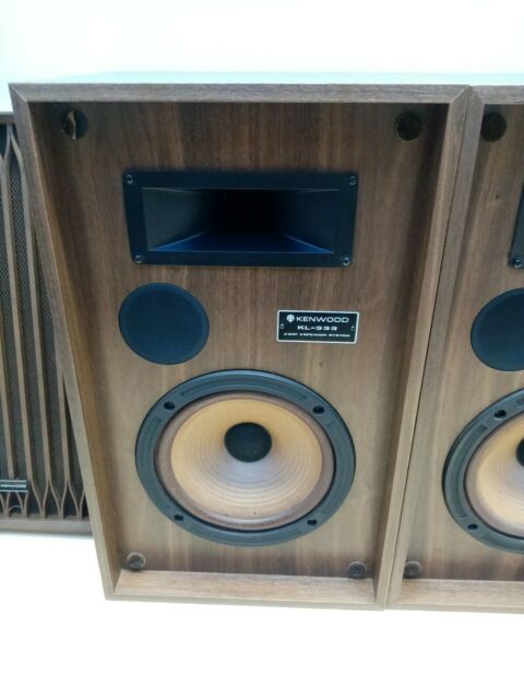

It seems that there is only one pair of cable to the "woofer":
here's the crossover, the red & second black cable are for the TW:

From the pictures it looks like the woofer is being run full range and the tweeter has a second order high pass on it. I couldn't get the exact part values from the photos, but it's something like the attached thumbnail.
Attenuating the tweeter would be a simple matter of increasing the value of the series resistor.
You may want to give some thought to using exotic parts here as they could easily end you up with a crossover that's worth more than the speakers.
Maybe consider an inexpensive off the shelf 2 way crossover at about 3,000hz?

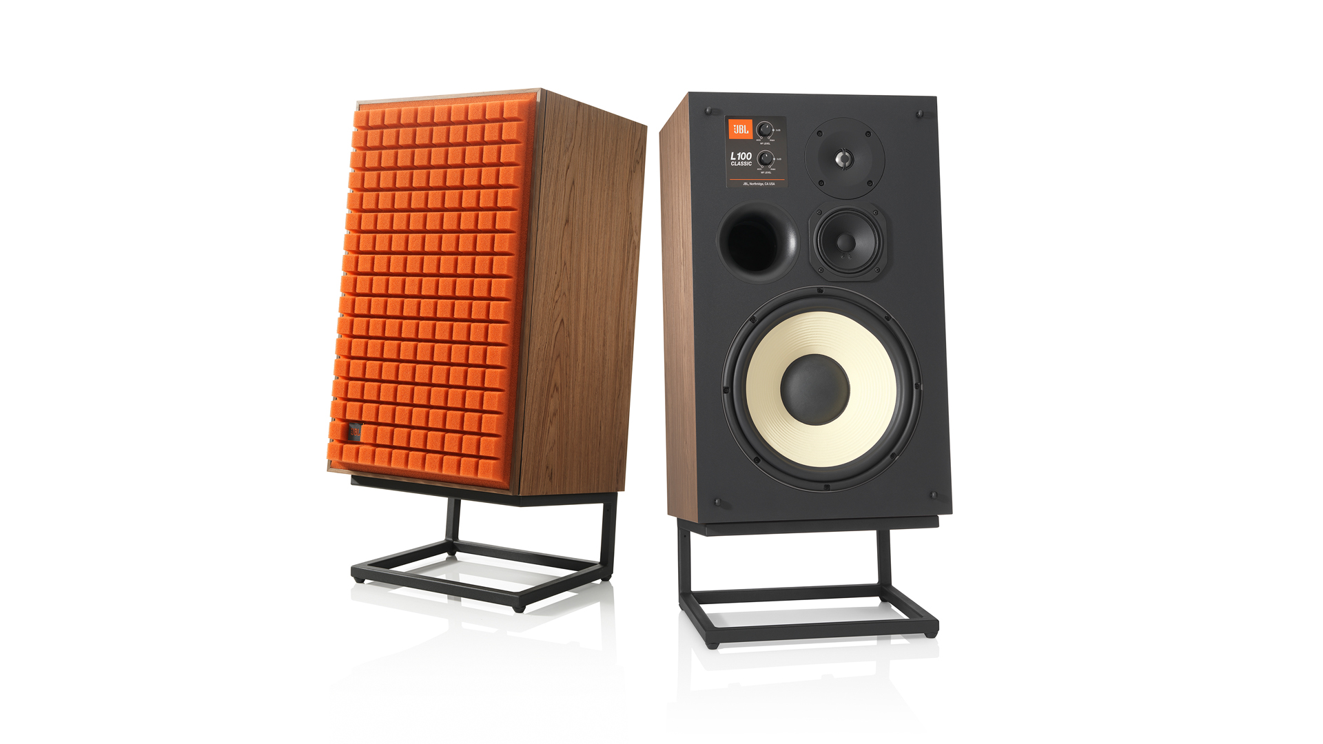

The extra expense of variable L-pads will account for the fact that few manufacturers incorporate them, but pay £4,000 for JBL L100 Classic speakers and you will get them!Even garbage L-pads are already too expensive.

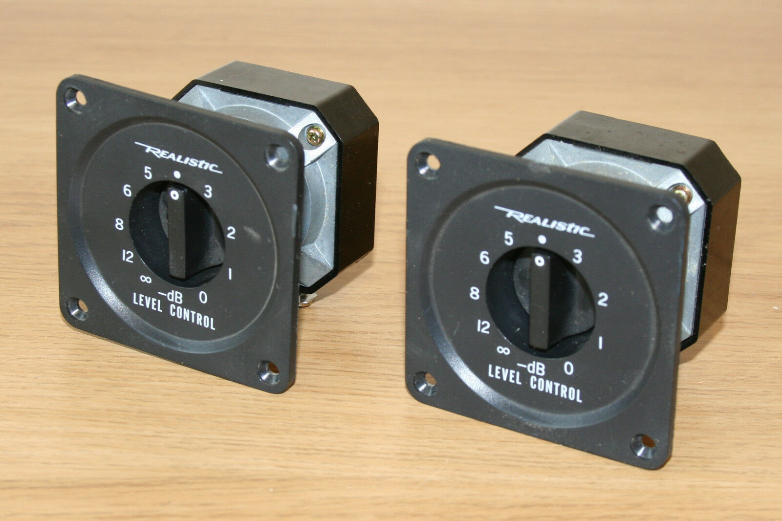

Another negative point is said to be the fear of intermittent wiper contact. However, I've been using L-pads on my tweeters for over 30 years without incident and, horror of horrors, they are branded 'Realistic' from Radio Shack!
I've used the realistic ones myself... never had a problem.
Yes, back in the day my L-100s had them.
I've also used 10 position rotary switches with resistors strung from one contact to the next...
