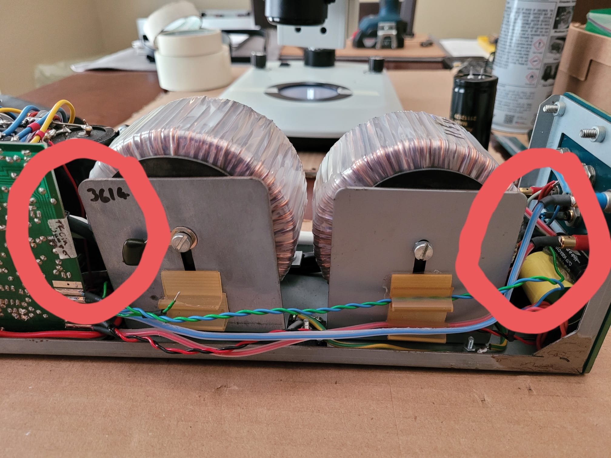

Crimson 640E I should have said. Installed new replacement slit foil 10000uF 80v yesterday, the Kemet branded. The sound is absolutely scrumptous. But also upgraded the input cap (huge) and shielded the transformers (4x in this case) (huge). All told, incredible sound is now coming from these 🙂 But how the slit foil compares to conventional, I can't say unfortunately. I do measure that the rail voltage increased from ~63v -> 67v now.
I do have some Mundorf 4T in the final PSU stage of my proto-amp but again, have not done an A/B comparison. Think I'll start using slit foil more as well, based on the 640E experience. T

The space is really tight and you manage to have everything organised. How did you shield the transformers? Did you wrap some foils around the circumference?

Very tight indeed. The shielding barely fit, but it's in there. Each toroid is wrapped tight with 2 layers of high saturation magnetic shielding material. Similar to a band shield toroid that you can buy.
I plan to cover it all with a different layer of shield material. Expect the magnetic field probe to be mostly quiet by then too.
I had to chuckle at Crimson touting the magnetic induction rejecting design on their website, tee hee. Perhaps they typo'd and meant "magnetic field injecting" 😉 At the circled points in the picture I mean 😉
I also did an experiment, reversed the field direction (polarity) in one toroid to see if I could create and detect mag field cancallation at the trouble points (the ends). There was in fact a slight reduction. But not nearly as much as the shielding.
The Kemet are exact same as the original BHC, I assume. I was a bit surprised to see rail voltage increase by 4v.
The sound is pretty amazing now, truly. Especially with the incredibly good input caps now (main cap w/ a bypass). It took me a long time to determine that recipe. But well worth it, if you want to break out of the "normal" sound zone. Which is determined largely by the passives in fact, IME. T

Layout is very efficient I must say, something to learn from.
Not familiar with saturation magnetic shielding material, I was thinking of getting those transformer covers from eBay.
What's the large yellow film cap? Is that the input cap?

With this thread inspiring me, I've just completed a Hafler XL280 power supply upgrade using the ALS10 in the 10000uF / 80V value, two per side. Since I was replacing the 30 year old original 7800uF caps I would think almost any cap would be an improvement but I'm experiencing much better bass extension and definition, and as I get more time on the amp it keeps improving. The XL280 is now my main 2 channel amp, until my DH500 gets upgraded. I'll probably use the ALS10 in that chassis too.
Have not come across ALS10, I tried some ALS30 screw terminal type sometime back and they were very good too but expensive to get here.
