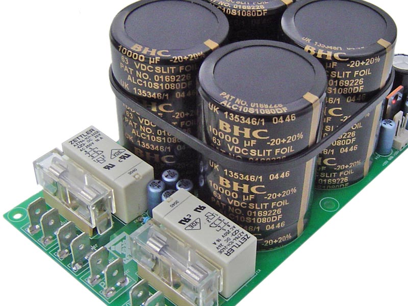

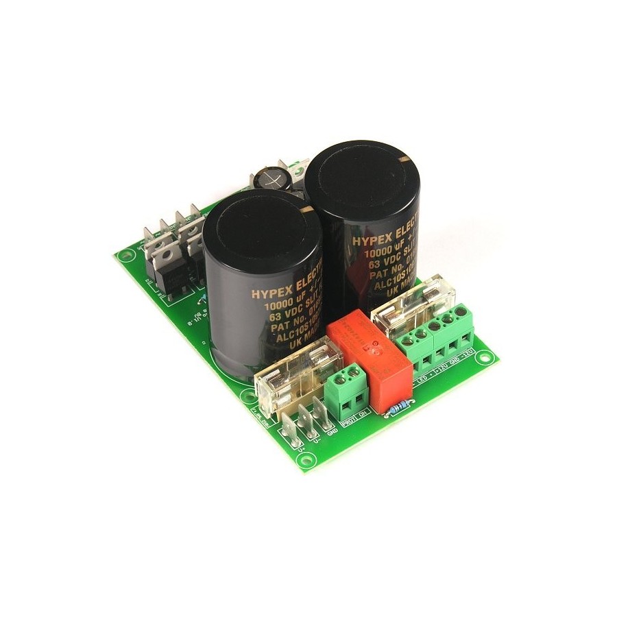

I hear you, but I have to remind that ALC10S was recommended by many (for example in the UK based forum) for Cyrus and Naim recaps, and also Hypex used them in their power supplies:
The 'Kemet' ALC10s are still the same BHC SlitFoil capacitors - and it says so on their website info.
Why anyone would think that a capacitor designed specifically for amplifier power supplies (by Denis Moorecroft) would be unsuitable for that job now that "Kemet" is written on the case is a misunderstanding, I think.
