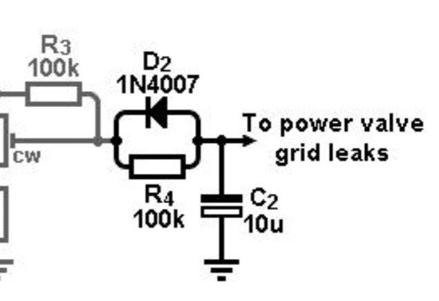

My post was not 100% accurate,The lighted power switches are available in a 120v version, no rectifier for the led needed...
schematic was adding another capacitor and diode before the last 100 uF cap..
For anyone who might know less than me (doubt thats possible lol)
UL/Pentode switch....
I also added a 500k resistor to the lighted power switch to dim down the bulb...
And the neg bias, added a diode and resistor before the last cap which also required one more tag strip...
I can't speak towards a full horn rig as i donk know much about there efficiency, but my Elsinores are 96db at 1w and the amp is dead silent, even putting my ear to the speaker i hear nothing... none of my previous amps came even close...beautiful work ! - when I first saw the "120" it made me think of my days with a pair of Dynaco MKVI and their wretched 1-bias pot for 4 expensive output tubes. Are they quiet enough for a full horn rig?
