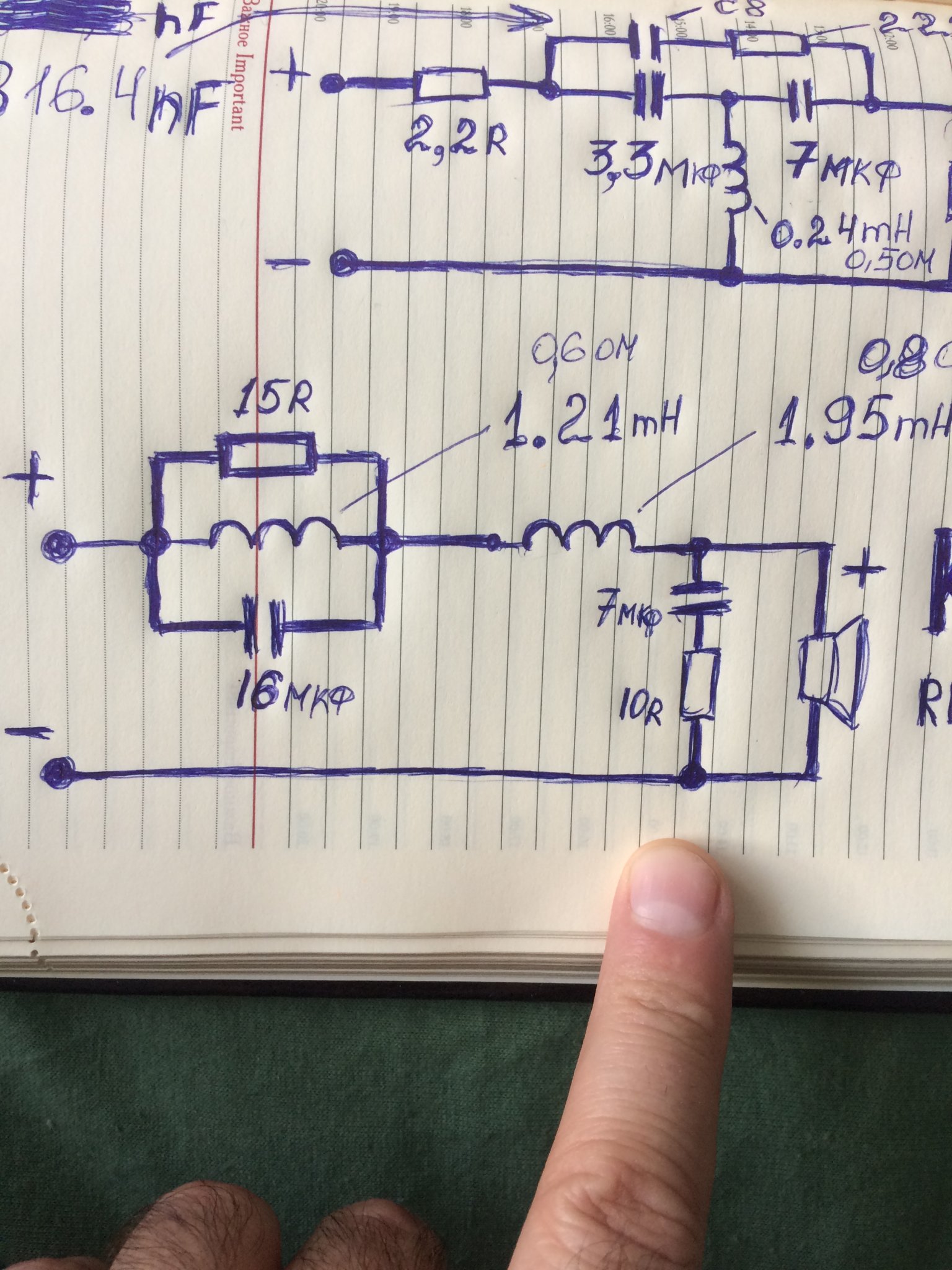

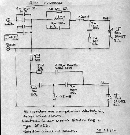

Having the opportunity to compare their Kef 101 with Linn Kan acoustics, it turned out that subjectively Kef has the middle range in the background, and Linn sticks out forward. The difference is big! Hence the question, does anyone have an original Kef-101 crossover circuit? The circuit, which here on the forum differs from my circuit by the nominal value of the inductor, I measured the inductance of the coils in my Kef 101 crossovers, it turned out as if the 1.8mH and 1.2mH coils were mixed up in places. Soldering seems to be factory, I want to figure out where it is right.
Sorry, I'm writing through a translator

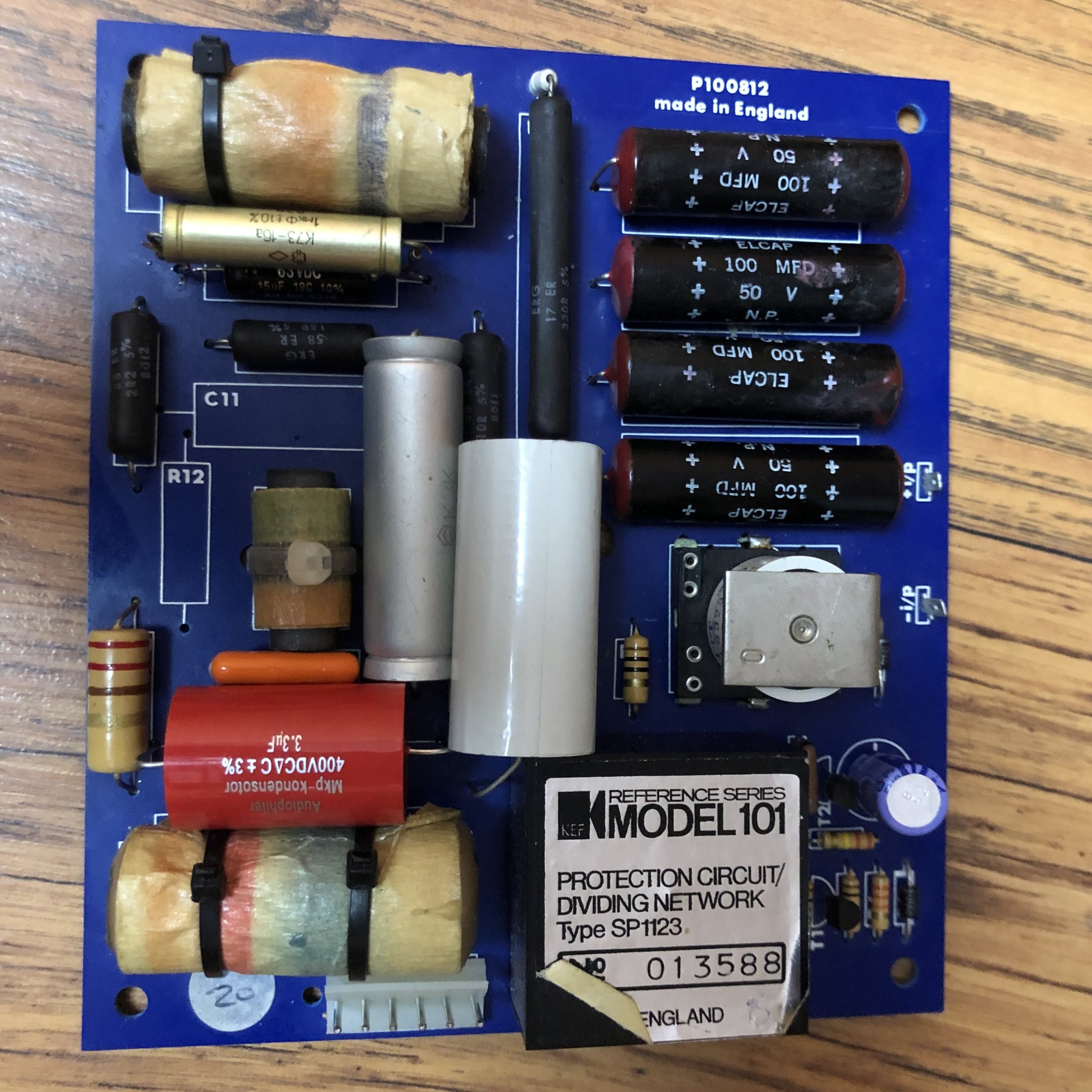

Hi AD,
Although the soldering may look factory, those axial film capacitors aren't! I'm talking about the red and white ones.
I have a pair of 103/2s and they have the soldering flux everywhere just like yours so I see your point about it looking factory!
The additional film caps may suggest someone has had a play around with the board (unless it was you) and so do the black cable ties holding the inductors, as the original ones are white. So, if the inductors have been removed and swapped around in error, it would change the frequency at which the notch filter operates and also cause a dip from the midrange upwards in frequency, which could explain your observations when comparing with the Linn speakers.
But if both boards are the same it would seem a bit strange...someone making the same mistake on both would be unusual.
Stuey

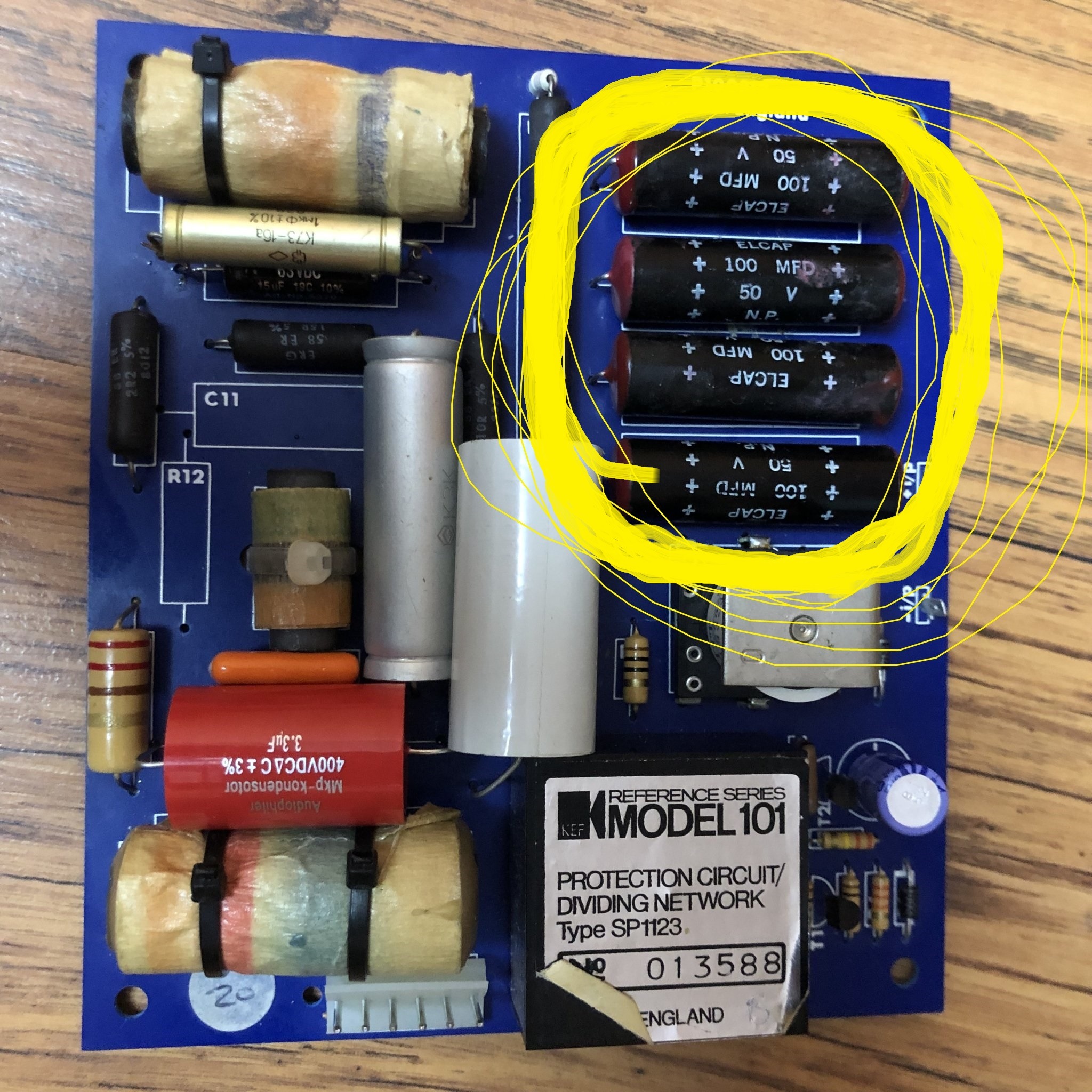

i'm in he process of having my kef 101 recapped.
Would it be prudent to also replace he 4 caps in the protection curcuit?
Does the quality of caps matter for the protection circuit?
I'm going to use the alcap cap set from falcon , but hhey don't include the caps for the protection circuit.
Also some of he resistors for the protection circuit seem to have a white powdery coating.
I guess this isn't normal?

Hello! The capacitor in the protection circuit will not affect the sound. But at the entrance, 4 pieces must be changed! In my kefas, the nominal value deviates from the norm. old age. The quality of these capacitors affects the sound!Имеет ли значение качество колпачков для схемы защиты?
