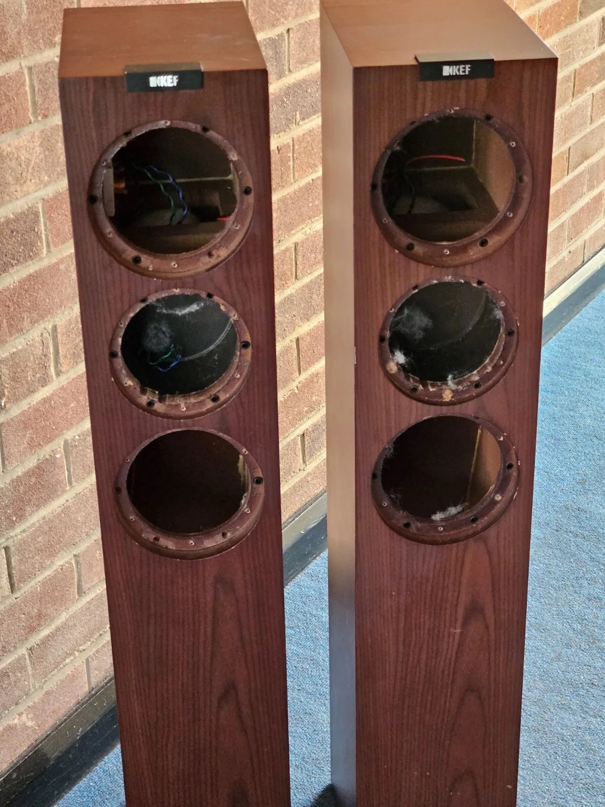

Here are some R500s, so smaller bass, but the same uni-q
Notice the screw holes, and the pvc tubes. Some tubes flush. Some squashed flush. Some raised. Some missing. There job is actually to take the trim ring. Much like some speaker grills are fitted. The basket has cutouts to miss them. It doesn't happen though. I leveled all mine off.
You can see the magnet is so tight, there are notches for the wires. The holes is quite rough, so sliding in some wadding would be a lot of fun. I see these may show the wadding glued to the back of the tube, where my wadding was stuffed. Also, where the rough holes are grabbing at some that still hangs from them. You can also see the lack of fixings, or room to make a repair once the mdf is ruined by repeatedly replacing the screws.
If we draw our mind back to the uni-q units, the area I would like some wadding, is the hole in the baffle, and just inside. Meaning the driver is in, before I could remove any shoehorn. I don't think kef managed this on the production line. It's just not at that level.
I did put my hand in the top hole, down past the tube at the back, and here I found the shelf/divider under the tube, didn't reach to the back baffle. In these, you see a sloped plank through the bottom hole. In the R900 there is also a slope, but behind it an empty cavity in the drawings. The 900 uses 8" bins, so the top enclosure needs no extra volume claimed from below. They do keep the sloped board though, at about 45 degrees.
This horizontal board and 20? degree board obviously join just back from the tube. This is where my eye falls, when I listen to this noise. It's this board attached to the front baffle, where I'm not getting the same knuckle rapping sound. It's an angle join, which suggests room for ill fitment. I really need to get in there, as I can fix a problem there quite easily.

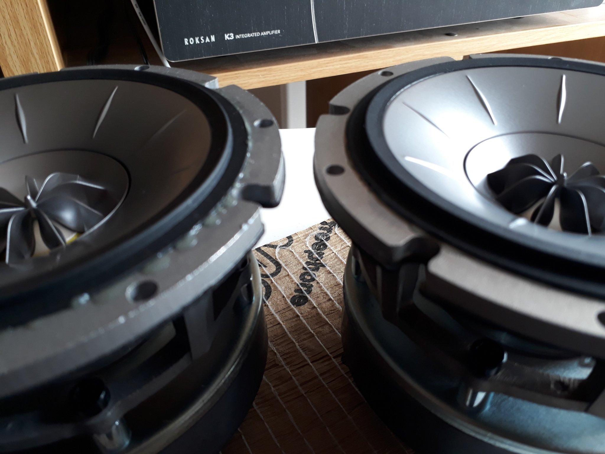

Some people will be quick to dismiss quality complaints, regarding construction. So here are those drivers again
First, the glue. I would be ashamed.
The baskets are different colours. One is grey, and one golden.
The serial numbers are quite different.
These were sent as a pair, and any question they didn't match, brushed off. I had to buy a third, asking it be from either batch, and it came from a third.
Some might say I'm overly critical, and I will accept they have a different opinion, but they are wrong 😀
