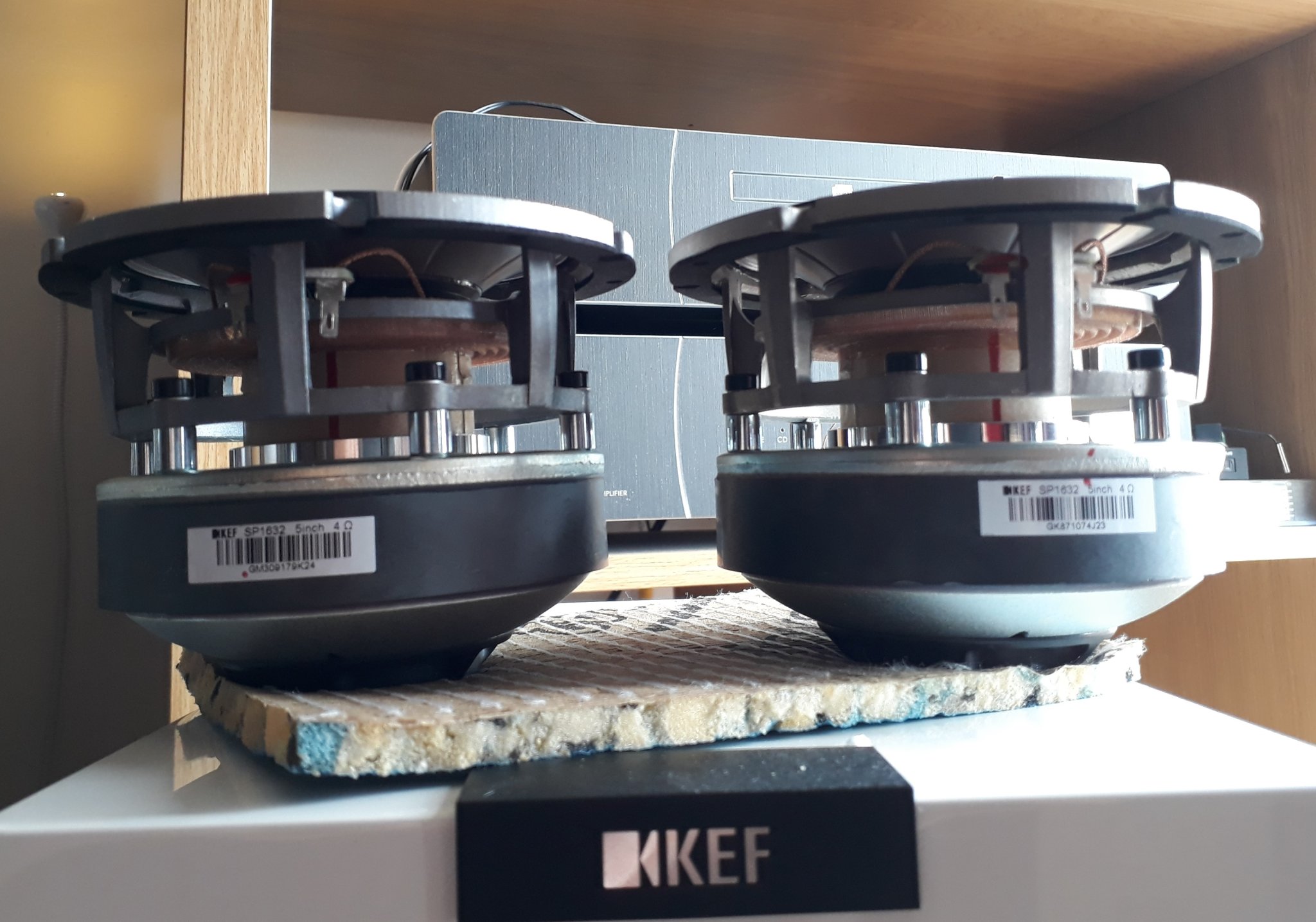

I have some R700s and the carpet roll tube for the mids is bothering me. These tubes for mids never sound good to me, with voice particularly. There is barely half an inch of space anywhere around the driver. Upon inspection, I found double the wadding in one, than the other. Kef have no idea what weight is right. However, I doubt my ear will ever be happy with this compromised design. I'm starting to think about the R100 as it's full range. I imagine it's the same drivers, with different suspension. In a proper box, that won't suffer the small cavity problem. I guess I need someone that bought the R100 as surrounds, with bigger R-series mains, to sum them up. I do have spare bass units from these R700s and some spare mid/tops to start a fresh build. I tend to sit at my computer using them, so some R100s might just work for me, with a sub.
I don't know anywhere better to get a subjective review of these, or cardboard tube use in general. Perhaps Mine are just badly wadded. I had to take some out of one, to screw the driver in. It was that compressed at the back. While nothing exists in the air gap, around the basket.

OK. Cardboard tubes don’t sound by themselves. The amount of stuffing in a midrange enclosure might not be critical at all. A small midrange enclosure has benefits to a bigger one. Enlarging the mid encosure screws your crossover setup. If you please.Perhaps I wasn't clear enough. Or you just want to make out I don't know some things, that you do. Without sharing them. In any case, there is no need to reply again.
Changing the size of the mid enclosure may or may not help and may or may not require a crossover change, hard to say. I can say I much prefer the current LS50 meta and R3 meta over the earlier options.

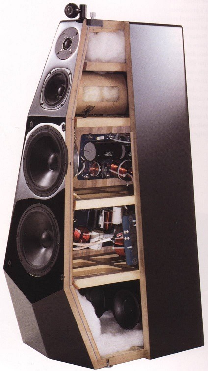

Sealed mid dedicated enclosure like this one should be stuffed to the max. At least this is my experience with 'high end' design from 80's/90's and from many discussion here with people like Earl Geddes and other experienced users.
I once asked to more experienced designer than i am (Scottmoose) if there is a limit of amount of absorber than can be put in an enclosure like that.
The answer had been there is a limit ( a point where the diaphragm start to be 'loaded' too much) but in practice i doubt it could be achievable.
Anyway the point is to kill/absorb the backwave/ internal reflections and such can only be with a lot of absorbing material effective in the reproduced range of the driver.
Which lead to enclosure size: too large an enclosure and you start to shift the internal resonance ( standing wave) lower in freq. Which might be an issue relative too absorber capability.
I understand the OP concerns relative to the enclosure size and shape but once stuffed with the right material it works surprisingly well. It's been my experience with my 'big' three way ( Technics SB-M2) with the mid driver located into a small subenclosure overstuffed with material ( close to what is availlable as Metisse product in France).
Tryed with and without and in my opinion there's no contest in results.
Compromised design i don't think so. A compromise in the design choice of course but what isn't in loudspeaker design?

Basically what I tried to say and I didn’t know about the malfunctioning speaker.I understand the OP concerns relative to the enclosure size and shape but once stuffed with the right material it works surprisingly well.
Good memory, and understanding of the problem. The tube is so close to the cone, that reflections are a problem. Noise from the back of the cone should be lost, not allowed to come back and mix/cancel and such. The application is floored. The R100 (or R50) Take my uni-q driver, and put it in a proper box. No tube. I feel this must sound better, but I'm unlikely to find any in a shop around me. It's not the actual same uni-q in them, as it has suspension that allows it to play bass.Hi,

On a personal note, I like the dark sound of the kefs. I sat with 5 uni-q drivers to pick the darkest sounding pair. Hence I have 3 on the shelf doing nothing. Along with a couple of cones that are marked. I never figured out why the boxes sound different (except it is the boxes) and they're not available from Kef.
I could do a better job with the wadding I know, but feel not having speakers of this type, is probably the better option. I don't mean to hack up the kefs, as some have thought. They don't offer me anything, if the R100 looses the rear wave better. It must do, right?
Edit: The wadding in one of the tubes is different to that in the main enclosure. The other tube has the same wadding as the enclosure. Which is slightly less dense, but they used two pieces. Cut and rolled the same way. But just shoved to the back in each. I shared it out, but it's in the wrong place. It's unusual history. Though this is just a side note really.
Well, i disagree the application is floored: someone probably messed with your loudspeakers so all bets are off about what Kef initially did.
I repeat, my experience is the principle of sealed+stuffed to the max is in practice totally ok if done as it should.
Ok. May i ask a question?
You say you feel this must sound better, but have you tried to verify your hypothesis?
It's a bit of work but should help define if the shape and side of enclosure are culprit to what bother you: build some test box maybe 2,
one with the actual volume seen by the driver in the R700, another one with 10 liters internal volume ( approx what R100 have).
Put one of your spare driver as a guinea pig in them, and play with the volume of absorber material used in each one.
Then send a filtered pink noise to the mid driver ( 500hz high pass, 2,9khz lowpass it will mimic what the mid driver experience in the R700) and listen to results, resonance will be obvious and effectiveness of absorber to damp them too. Better have 'good' headphone as reference to compare to.
You could run an impedance measurement too as any issue will reflect on the curve as 'wiggles' on graph. With the right amount of stuffing the 'wiggles' will disapear.
Repeat with larger box and draw your own conclusion.
No need for fancy material for the box or absorber to be used, it's just to verify your hypothesis the issue is box shape/volume and absorbent related.
We could explain what will happen right now, but you'll be biased. Better do the experiment first and then discuss results afterward in my view. But if you really want to know what to expect other members or I can do but you will be biased...
