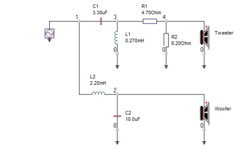

That SEAS Loki circuit looks almost exactly what Goran got after a 4 ohm conversion:
690416d1530871068-kef-ls50-crossover-seas-loki-crossover-png
Goran's 20uF doesn't really do much, but helps things along a bit on frequency response. A waveguide tweeter gains about 5dB below about 5kHz, so the input capacitor on the tweeter filter is smaller than you would use with a regular dome.
www.audioexcite.com >> Concentric Three – M5
A two way LS50 style two way would get about, er, 1mH and 15uF on the bass section. Goran's treble section with some level adjust. And positive polarity as I thought. But it won't go loud. Laws of physics.

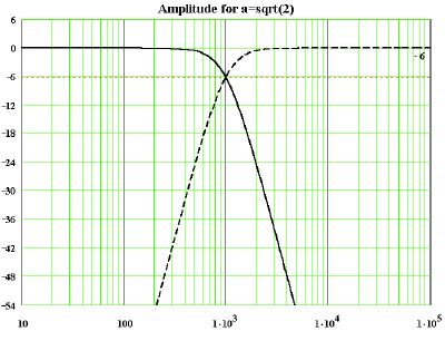

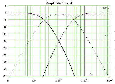

This thread has turned out well. Why? Because you have Goran's 3 way circuit. 2 way or 3 way, you now only have to adjust for anything you change from his idea. Fundamentally just the bass section if you have a different woofer setup.
The theory of three ways (or two ways) says once any section is defined, you just adjust the other two to fit around it. Bafflestep is an added issue, but match the acoustic slope of the new bass to the original one by adjusting the bass filter, and it works. A simple problem for most simulators which can optimise.
I could do this in Visaton Boxsim with similar drivers. In fact I did.
Standcouplet WG – Boxsim Projektdatenbank
Thank you both for your input, I really appreciate it.
Due to a misunderstanding (my fault) my intentions might have been misunderstood.
In the end I want a 3-way crossover:
- tweeter (KEF coax): 20 kHz - 2700 Hz (audioexcite)
- mid woofer (KEF coax): 2700 Hz (audioexcite) - 200 Hz
- woofer (t.b.d): 200 Hz - 30 Hz
The baffle step appears at 1100 Hz (343/0,31) (1700 was typing error).
