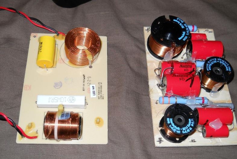

Thank you, but thats just the crossover part for the low midrange woofer. I was hoping for the tweeter part of the crossover 🙂
It's always want, want, want here! 😀
Oh well. I'll bite. Looks to me like the circuit on the left is the LS50 original. Suprisingly simple.
That's just a bass coil and a second order tweeter with a resistor for level.
Must be 3kHz crossover. Why do you want to know?

I did look at the links yesterday, but found it all very difficult in German. 😱
But maybe some progress. The left section is a third order bass then.
That makes sense for a good speaker. The tweeter filter looks like a glorified second order in the image below. I can't guess the polarity with this coaxial.
And the section below that, called "Neu" might then be a new bass section.
Which still leaves me scratching my head on a new tweeter section. 😀

I am familiar with the German thread and even had contact with the guy who posted it. But unfortunately, he only knows the part of the crossover that is responsible for the mid woofer. And due to copyright, none of the images show the whole crossover.
@Steve: Neu means new -> it only shows his modified part of the woofer crossover

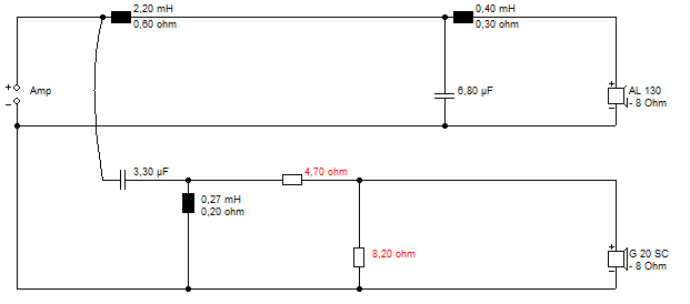

How hard can this be, really? SEAS make the coaxial Loki with a 6" bass.
SEAS Loki MkIII
To make the bass third order, you would split the 2.2mH bass coil into about 1.8mH before and 0.4mH after the capacitor. You often put a little resistor across the 0.4mH. Which might be 5 ohms here. It ends up similar.
The Loki is a 3kHz cross to the tweeter.

My intuition, based on what I have seen here is something like below might work. 3kHz crossover for a 5" metal bass.
I really have no idea about polarity, but this can't be way off. The tweeter is effectively horn loaded, so the input 3.3uF capacitor is always smaller than you might expect.
I haven't attempted an 7-8kHz bass notch on the breakup.

The KEF drivers in the LS50 are 4 ohm. Definitely! Also although the drivers are coincident in X and Y, they aren't quite in Z. I measured them. The tweeter is connected in reverse polarity.
I said I wasn't too sure about polarity. We don't know what KEF are doing here. My feeling is time alignment is not too big an issue with a 5" bass anyway. Can only be a couple of centimeters out even with a regular tweeter on a baffle.
It could be a BW3 alignment on the filter, which is very KEF, and that works in either polarity.
But 4 ohms is a game changer. I hadn't researched that. But usual stuff on the circuits to adjust, smaller coils and resistors, bigger capacitors. In fact, 1mH series and 10uF shunt (maybe with a bit of resistance like 2.2R added in series with the capacitor) on the bass might then do, with 3.3uF and 0.33mH and an attenuator on the (8 ohm?) tweeter.
Acoustic centre is usually the middle of the voicecoils, so you can work Z out for the Coaxial. But it's tiny relative to 3kHz wavelength of 10cms. The good news is that 5" bass is an easy speaker. So I'd get on with it.
