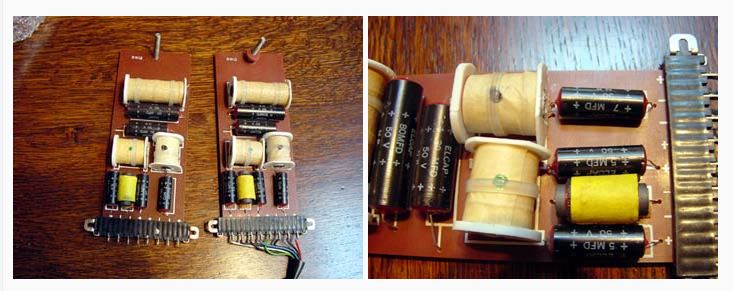

KEF Concertos:
And the crossover:
I'd replace those tweeter capacitors with 4.7uF polypropylenes:

I thought I would start the research in advance of actually taking the speakers out of operation until I had a plan going forward. I have two sets of speakers I am considering putting in their place. One set are ESS AMT 1 pedestals, and the other set are Wharfedale Dovedale 3s. They are very different from each other, but the location I will be placing them in is very limiting. It will be interesting which pair I like better in that location.
How did past recap projects on the Concerto deal with the larger capsand positioning them in the cabinets?
.....I would confine myself to upgrading the top end here, as mentioned earlier, along with renewing dried-out electrolytics elsewhere. That treble filter IS a bit messy. It would be more usual to use a 4uF and a 12uF for a smoother rolloff. 4.7uF/4.7uF is a bit peaky, but may be a zingy treble sound you like.
3-Way Classic
I agree....just do the tweeter filter (4.7uF + 4.7uF, and/or try the 4uF + 12uF as suggested also), and then the mid filter.
For the mid two 15uF in parallel and a 4.7//2.2 uF for the 7 uF cap.
I would use 100V Polypropylene caps..higher voltage get too big and too expensive, and you wont need higher voltage rating in this application.
I have heard Concertos done this way and the result works out quite fine.

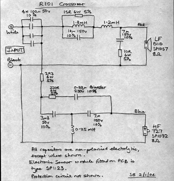

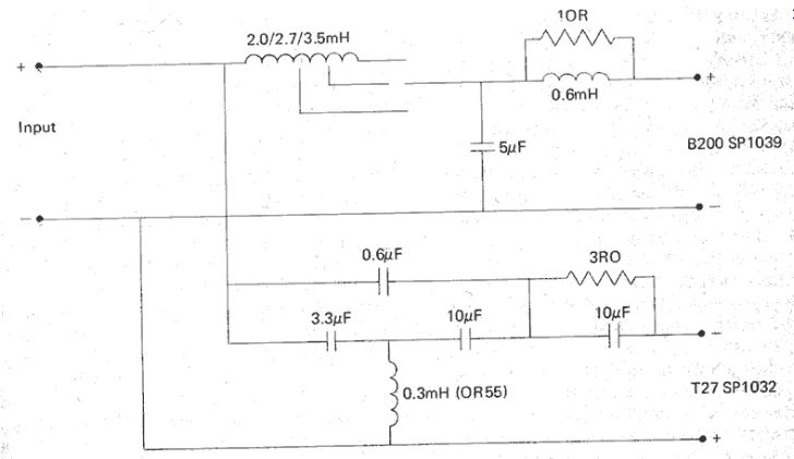

Has anyone seen any Concerto crossovers that were different from the schematics? Just curious if they did adjustments like Celestion did in their crossovers..
Unless you are a filter specialist, these may not mean a lot to you, but KEF did much more complex things when they used computer modelling on filters. I think they were getting a bit too obsessed with perfecting/flattening their curves really. Lynn Olson talks bout this stuff:
The Art of Speaker Design
The KEF R101 was the best small speaker KEF made at the time. Almost LS3/5A in concept. The KEF 104AB (acoustic butterworth) used the 8" bass unit.
Bigger improvements were found by Spendor and Harbeth with more advanced speaker materials IMO. :)
I can read them no problem, but no, I am not a filter specialist. Just learning. The second looks like the 104aB filter network. I used to have a pair of these, but I much preferred the Concerto's. I know they aren't the best, but I just really like how they sound. Interestingly, I found the 104aB's complimented the Concerto's, only the Concerto's have a much deeper bass! Much deeper! Most music types shine on these speakers, even Hip Hop!
Those crossovers show 2 unique features that KEF pioneered. The bridged T of the tweeter was integral to the Acoustic Butterworth approach. It allowed a controllable notch in the tweeter drive that let you get a combination of electrical and acoustical that were still straight Butterworth rather than having a strong inflection point in the curve at the electrical resonance.
The series capacitance was part of the overall LF shaping. The rule of thumb was to start with a sealed box with an overall Q of 0.9 and size the capacitors to create a flat third order. Works quite well and actually flattens and extends response slightly, plus helps power handling.
The R101 was meant to be an "LS3/5a done right" but it never had the prominance in the market that the BBC unit had. A couple of years later we redesigned the LS3/5a, but that is another story.
David S
