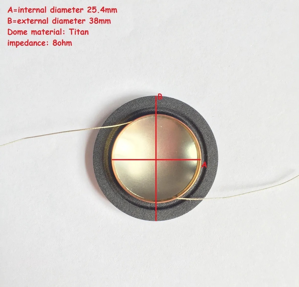

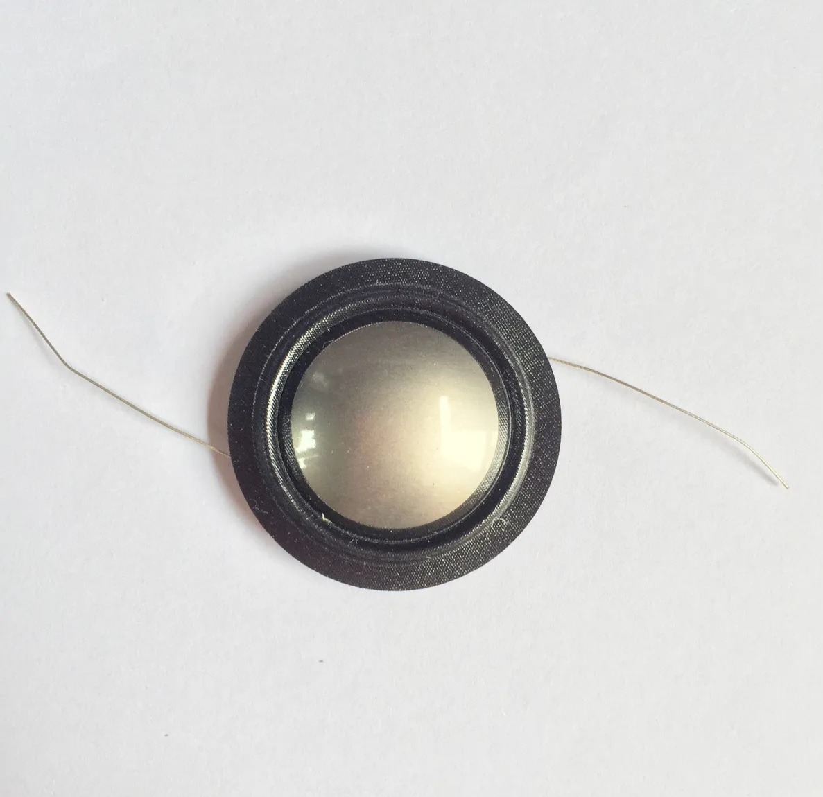

I have found a tweeter diaphragm that fits the newer model q950. Possibly this can fit in SP1596 8" since the q950 is also an 8" driver. They are 38mm and 8ohm. Not sure how many ohms they are in the old Q900 as both mine are blown.

No, don't have anything yet. Just thinking out loud while looking for a tweeter that might fit. Looks like the Q950 has a much smaller coil diameter. The strange thing is that there are many diaphragms for sale to Q500/550, Q700/750 and Q950 but not Q900. Maybe there will be a diaphragm for the Q900 soon.
