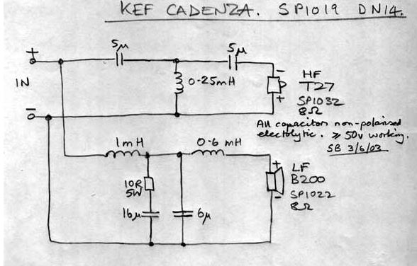

I have a pair of kef cadneza's, which to my ears are sounding a bit wooly these days. Not to mention looking tatty. The drivers are all immaculate (SP1022/T27/B139PR).
Whilst replacing the crossover with new components - same spec, as per system7's drawing below, I'd like to see if I could make some new more compact cabs for them.
I'm wondering if a sealed 20l box (deep), with the radiator at the back, would not mess things up with the standard kef XO.
(The old Kef spec sheet for SP1022 states "Enclosed 20-30l. Bass Reflex 40-50l")

Of course you cannot change the internal volume because of the woofer and the passive radiator and the relation between them -stereonomono: KEF Cadenza
I'd keep it frontal, the PR, because I did a box ( a pair of boxes) with PR on the back and I don't like it.

Since you are a self-declared 'noob', I'll back up pico's statement that you cannot reduce the enclosure's internal volume without totally changing the way the loudspeaker system functions.
Locating a passive radiator at the rear of an enclosure may require the enclosure to be located further from the wall in order to reduce bass 'boom'.

The radiator is a form of bass reflex. Whether the radiator is at the front or the back does not change that. If you are going to 20 litres, a closed box would work better (as Kef box size recommendations suggest). It would be interesting how it sounds like that (less bass) The xover could well work in a closed box, but I would suggest a very rough prototype to try it out.
