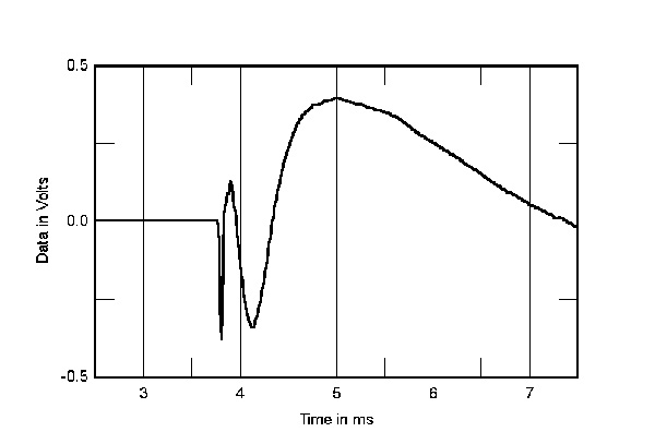

Necro thread. Timing might be right with the new Blade 2 Meta. https://www.stereophile.com/content/kef-blade-two-meta-loudspeaker
I was eagerly awaiting this review just to see one single graph.
Belies KEFs claim of virtual point source. With active XOs i wonder if that is fixed in the LS60.
KEF has to be appauded for their dogged promotion of push-psuh woofer alignments, which have very significant value conceptually.

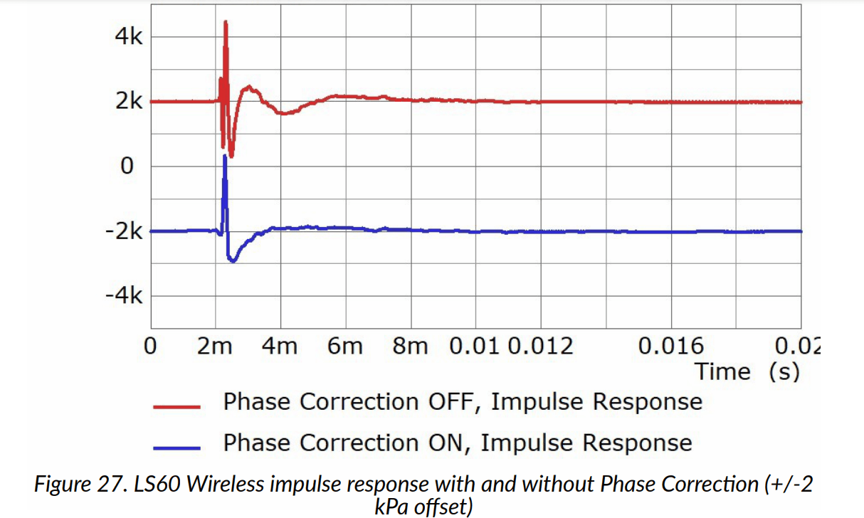

Thanx. I have the white paper have not digested it.
Phase correction on looks way better, nice except for the tiny downward bit before the rise.
