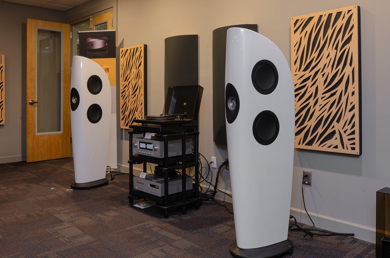

Not really DIY but today I was at a demo of the new Kef Blade "50th aniversary" loudspeakers.
Boy what a bad loudspeakers these are. They sound like plastic, are very resonating in the lower mids. Bad definition in the low end. Mids and highs very polite plastic hifi sound. Shut in sound. In others words quite the opposite of what I'm used to at home. Oh man never been so happy to here my own DIY system again. Listening to them from outside the room was plain terrible. In fact that was what drew my attention in the first place. When I went over to see where this terrible sound came from they invited me in at the demo

Back to the Blades: those woofers sure are far off the floor and based on the photos in that linked thread, in fact they look to be equidistant between the floor and the ceiling, which I thought was a design no-no as far as good bass response was concerned.

Assuming they are at half floor - ceiling height, then that would mean they would minimally excite the 1st floor to ceiling mode circa 71Hz for an 8' ceiling.Back to the Blades: those woofers sure are far off the floor and based on the photos in that linked thread, in fact they look to be equidistant between the floor and the ceiling, which I thought was a design no-no as far as good bass response was concerned.
I don't think they're that high as that would make the centre of the coax too high for most people in typical seats.

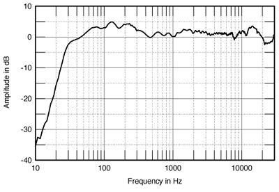

Both of them are superbly designed speakers. Stereophile measured them both. Here's the Model Four:
Ref4 On-axis FR:

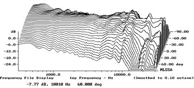

Ref4 Horizontal map:
Overall, I daresay, better than 99% of speakers sold as new in 2012, at any price. But not better than the Reference 201/2, which not only has flatter overall FR but also has smoother overall horizontal measurements and maintains consistent directivity even higher in frequency.
(The Ref4 is a much bigger speaker, and a 4-way rather than a 3-way, so it will be more efficient and go down lower. Especially since the bass drivers are loaded in a bandpass cabinet.)

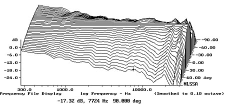

201/2 horizontal map:
