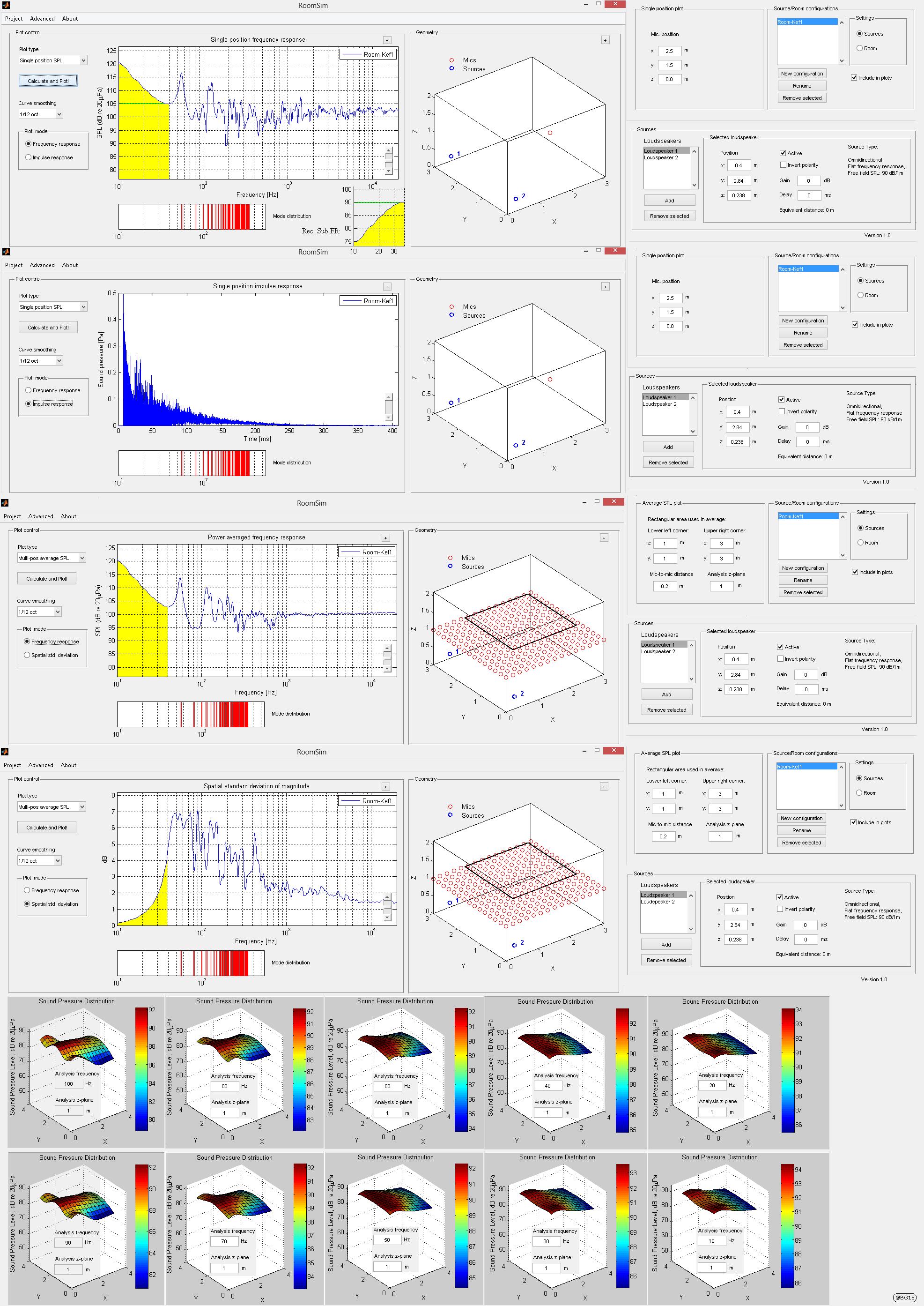

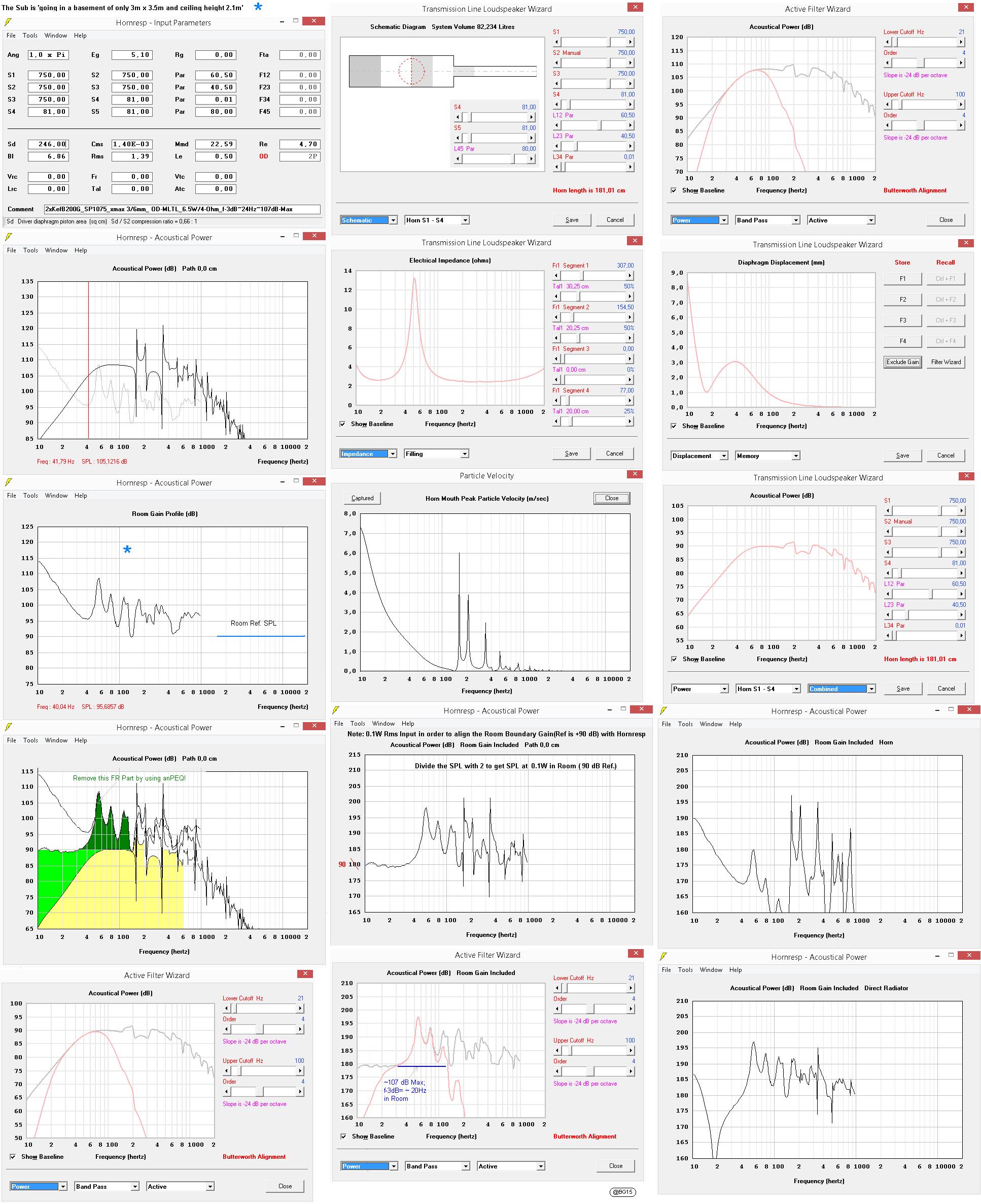

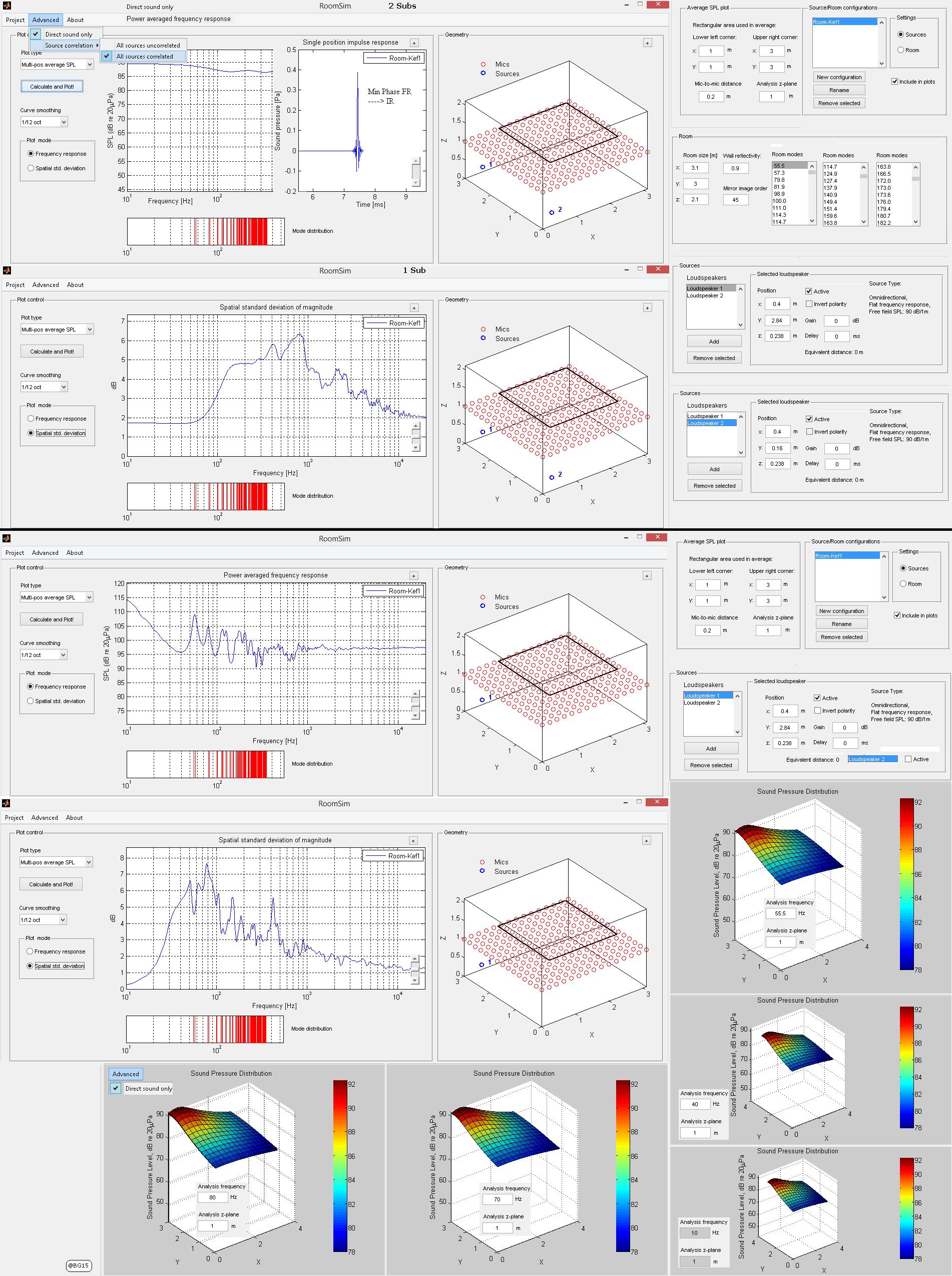

Late addition: Your Room seems to have a large Cabin- Gain:
b🙂
