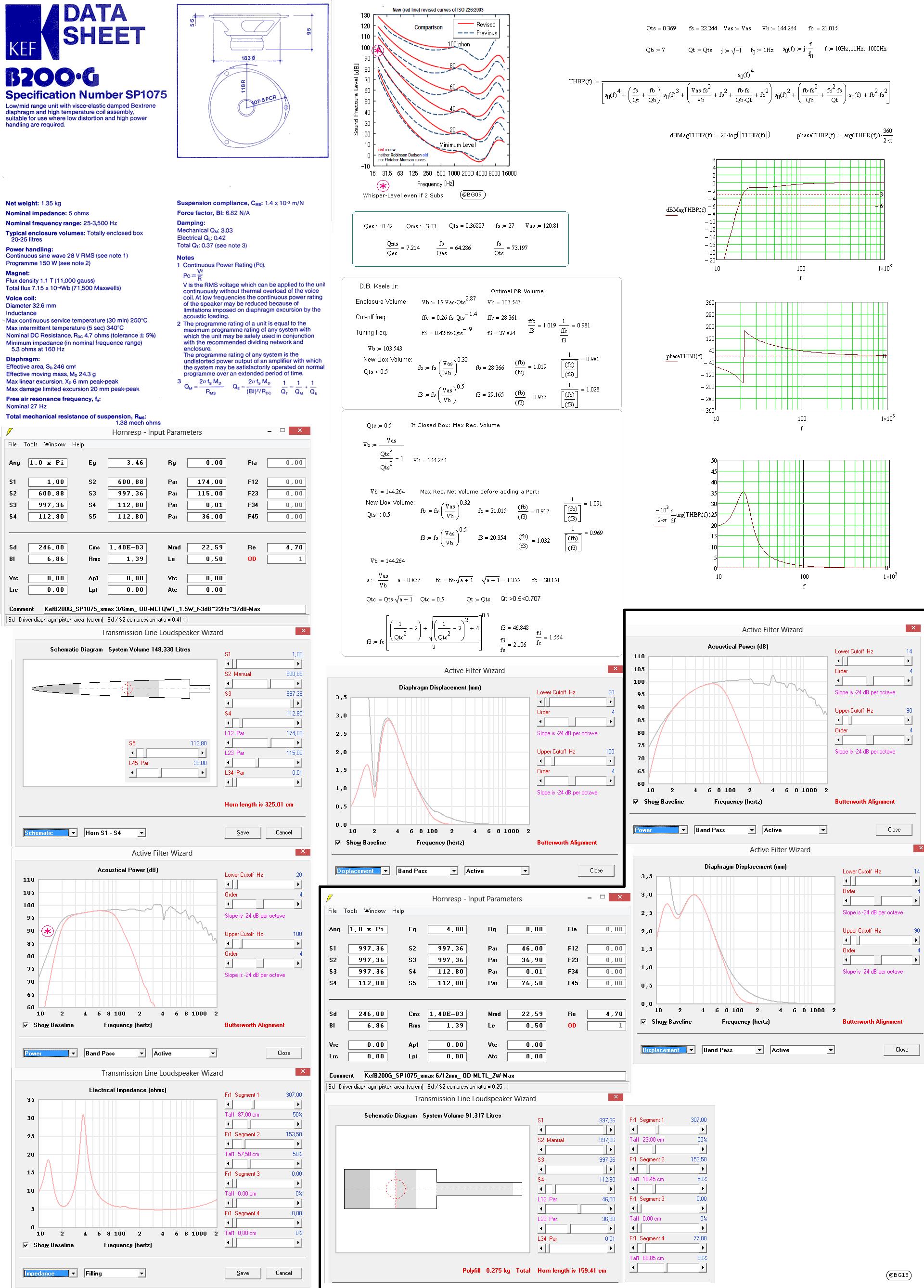

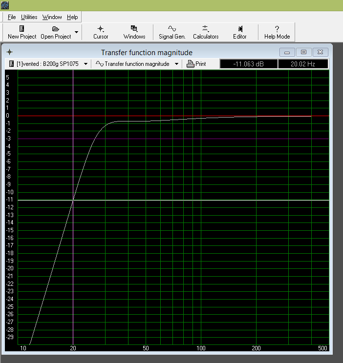

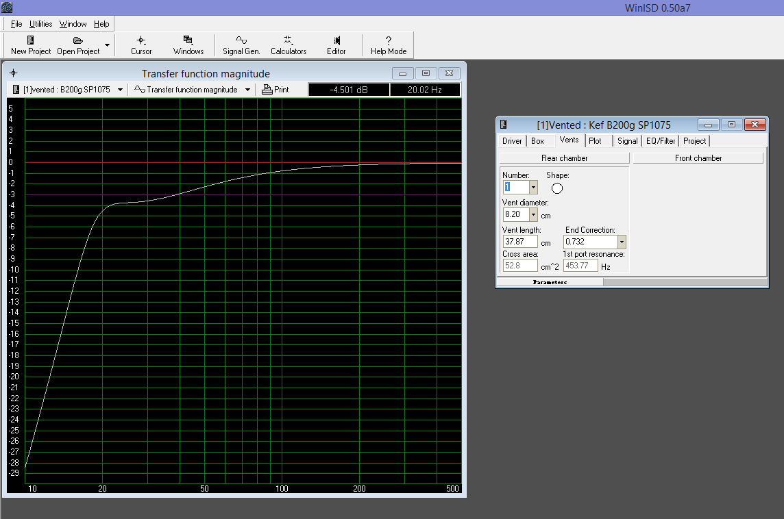

Basically I have two spare 8" kef sp1075 bass drivers and was wondering if I could utilise them in a box to use a subwoofer for my ht system.
I was told decent ht subs go as low as 20hz. These speaker's specs say they can go as low as 27fs and after playing with winisd for the first time I modelled 20hz at -4.5db in a 90l vented enc with two of these drivers in an isobaric config.
can someone take a look at the graph and tell me if this look right or if there is something I can change to improve the freq response please?

They can be made into a sub, but it depends what your expectations are. They don't have the excursion and power robustness of modern sub drivers, not the ideal of parameters.
I think you will find that the perfromance of that sub will be disappointing, take a look at the power handling graph. You are trying to push it too far with too low tuning and too big box.

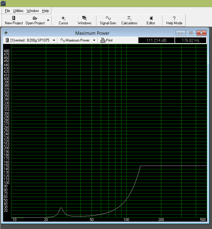

yes, I put in what I think are the excursion figures and now I see a power curve. it rises to max power at 20hz then dips before rising again. is this not good?
According to this, it's 3 mm Xmax, 10 mm Xlim: KEF B200G SP1075
Yes, the dip is showing you were it's exceeding Xmax in 2 pi [half] space, so add a couple of dB if up against a wall and a few more if in a corner. Technically, it would be more, but most rooms have pretty lossy construction.

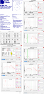

I've attached the max power chart though i don't yet fully understand what i'm looking at.

been playing some more with winisd....if I go back to using one driver in a 120l vented enclosure I get almost max spl for this driver at 27hz?

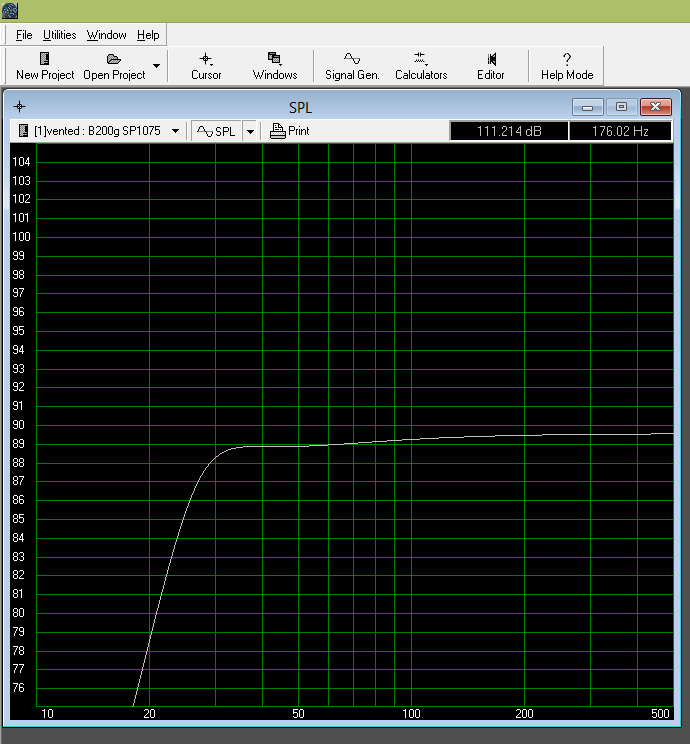

ok had another play with winisd this am. 120l vented enclosure with one driver tuned to 27hz. graphs attached. vent is 10.20 diameter and 20cm long. what do you think? does it look worthwhile doing?

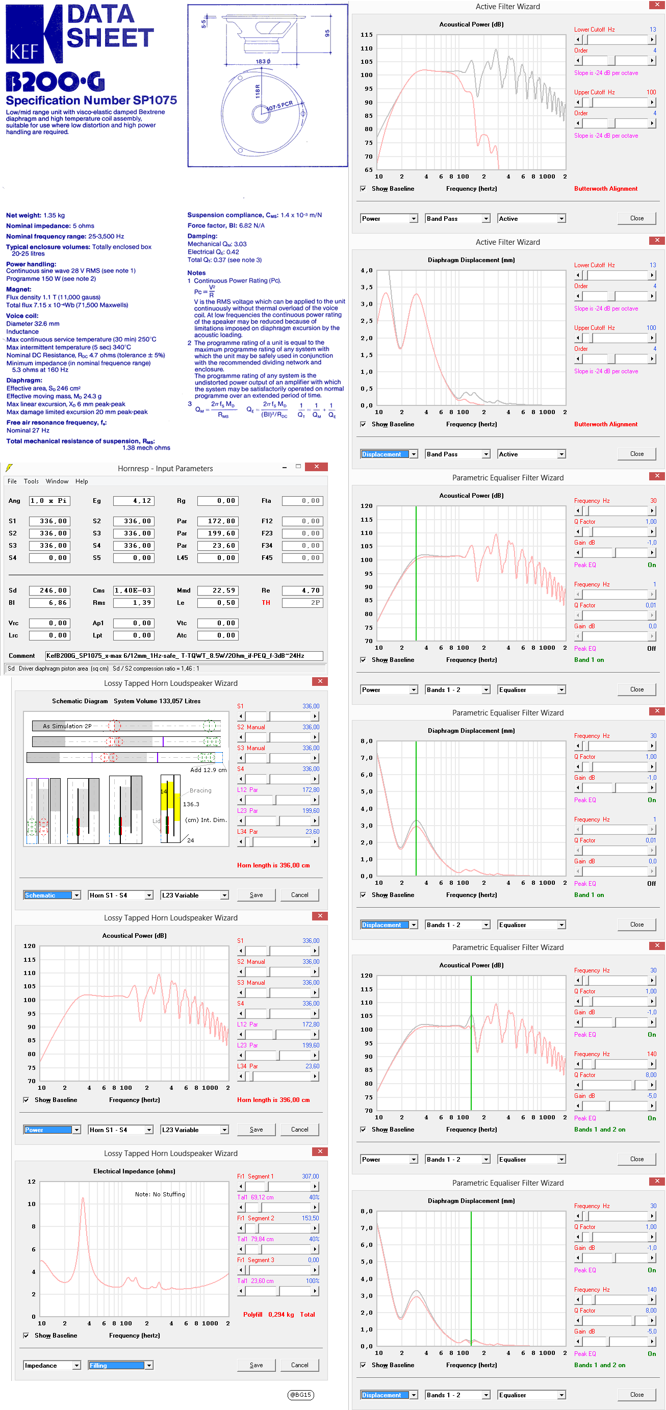

hey thankyou I was just about to give up on the idea but wow I have no idea what a lossless horn tappy is but the graphs certainly look good!
firstly thankyou for your time! having a quick google on the above. am i correct in thinking this a three section enclosure using both drivers in a series config? also what are the external dimensions of the cabinet?
that is some seriously good spl at that tuning!

'am i correct in thinking this a three section enclosure using both drivers in a series config'
Hi avnewbee,
Correct.

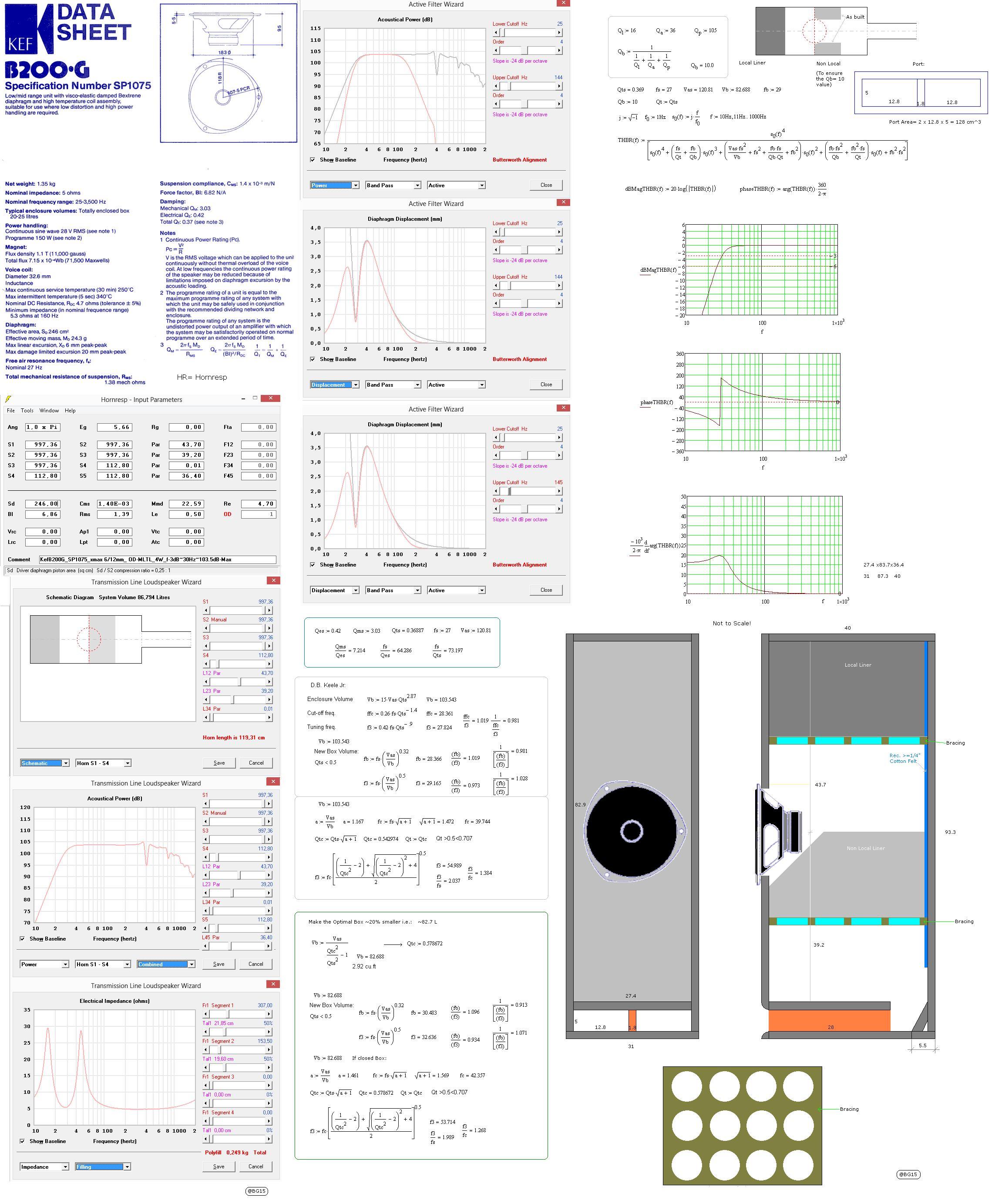

Here is the requested ML-TL:

Wow thankyou very much! Am I correct in thinking the freq is cut off at 25hz due to the excessive diaphram displacement? So not likely to hit 20hz?
The box looks easy enough to make but what it a local liner?
I think ill make two of these enclosures, especially as it seems I get more spl from this design with one driver and smaller enclosure though sacrificing 5hz bw. Which was prob asking too much from these low excursion 8" drivers anyhow.

... Am I correct in thinking the freq is cut off at 25hz due to the excessive diaphram displacement? So not likely to hit 20hz?
The box looks easy enough to make but what it a local liner?...
Yes: xmax is only 3mm Peak!, 20 Hz is too low for one Driver to handle.
A Local Liner Damping is determined by a one Axis(Dimension) Pressure Differential that cause Absorption opposed to a Non Local Liner that at least operates using 2 Dimensions.
b🙂
PS: Your Room will add Boundary Gain, i.e. No need to chase 20 Hz!
