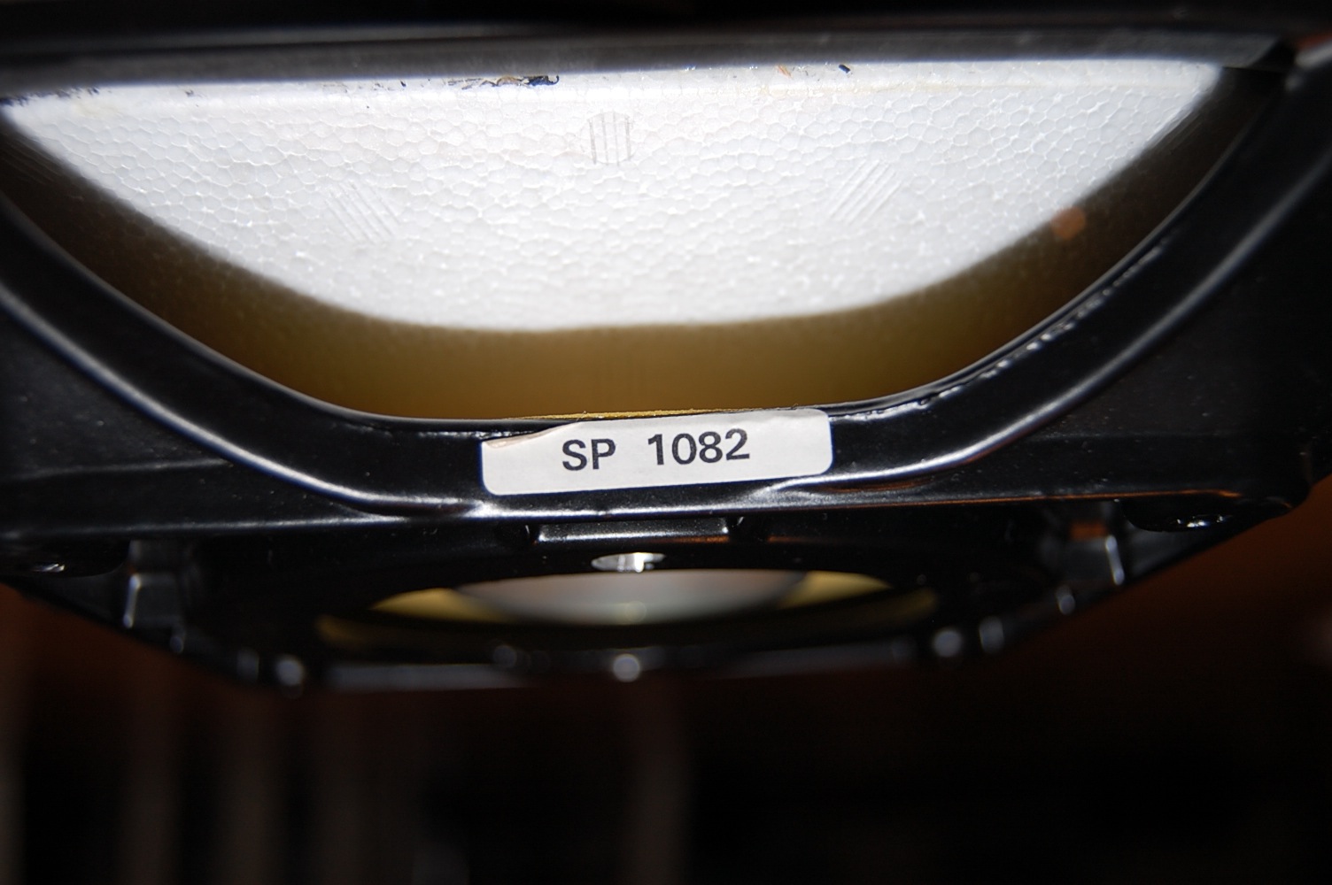

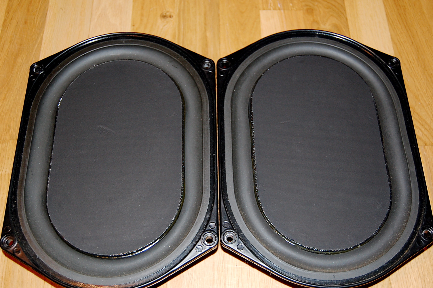

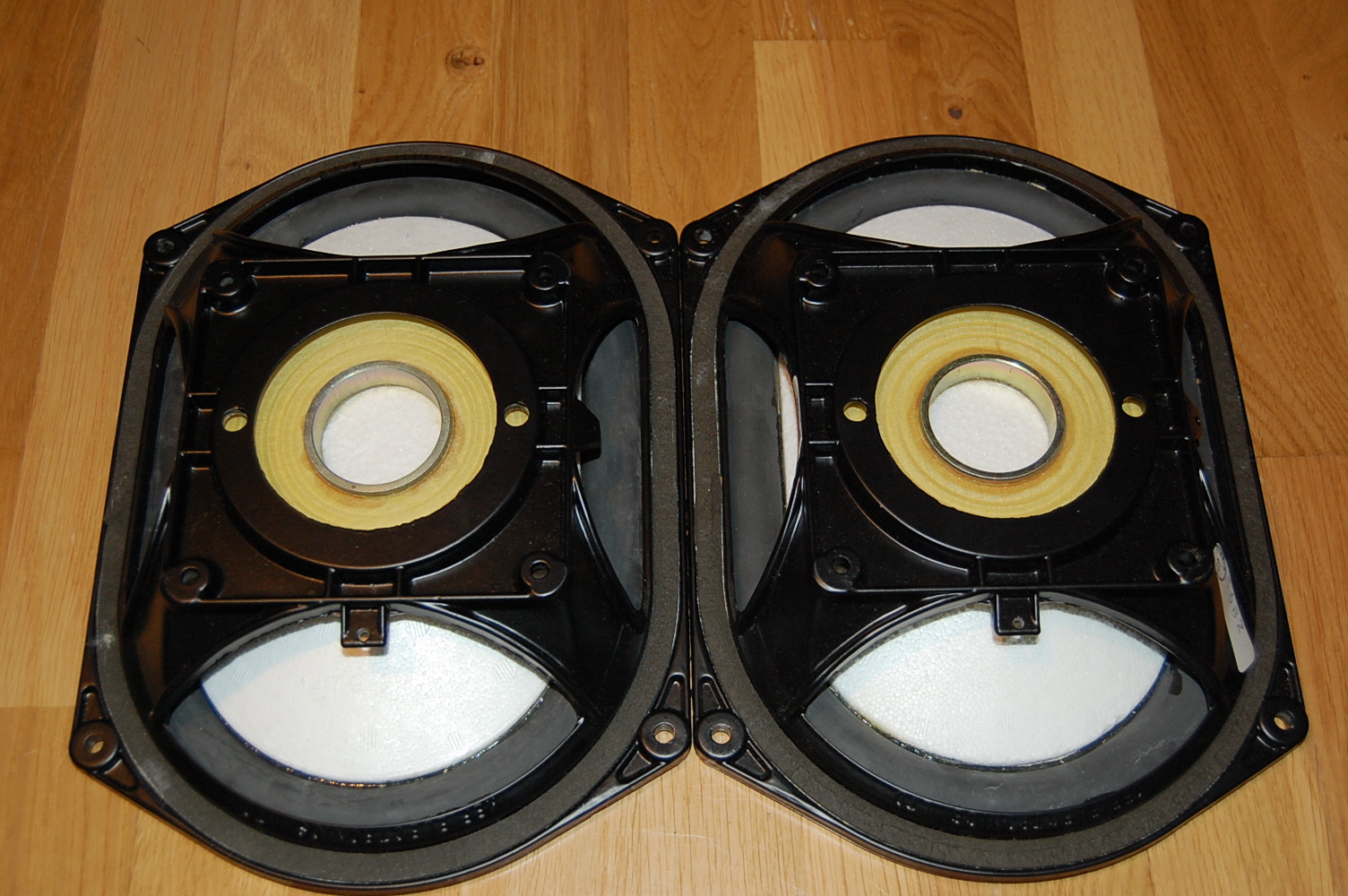

KEF B139 passive radiators
Hi everybody, this is my first post on this fantastic forum, anyway, I´ve been here for while, lurking in the "dark" 😀 and digesting all those tips, ideas and knowledges...
I have a pair of KEF B139 SP 1082 passive radiators, anyone interested?
