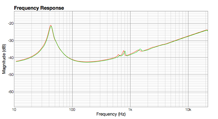

Just measured two KEF B139 SP1044 I had found in the basement:
Looks like fs is 43Hz. That's pretty far from the specified 25Hz. Is it time to let them go?

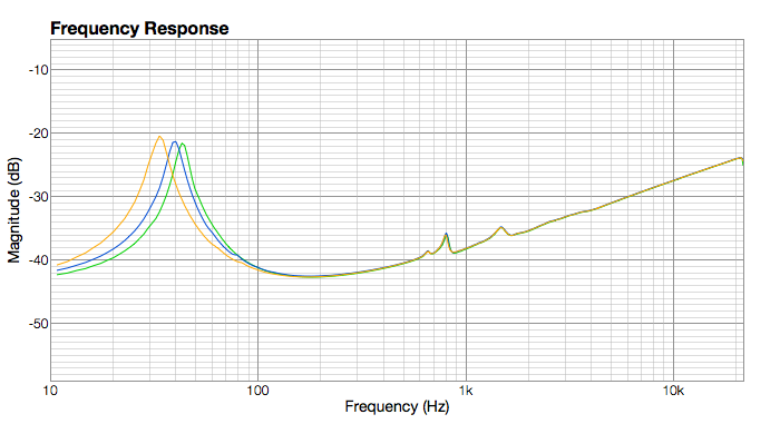

After applying glycerine to the upper part of one of the rubber surrounds, fs dropped already by 3Hz. Only 15Hz to go 🙂

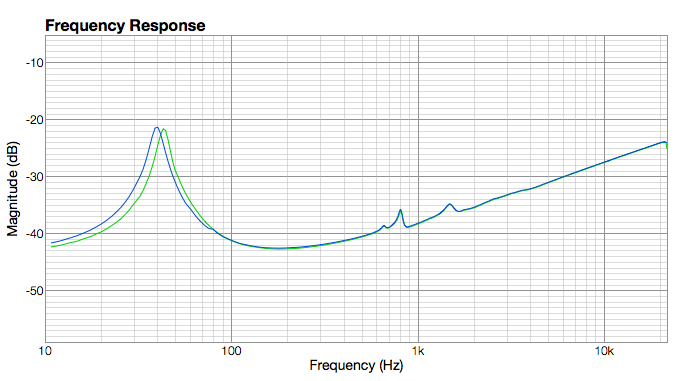

Just cleaned the rubber surround of the other driver with a damp cloth. Just water, no glycerine. The effect on fs is nearly the same. So I guess it's not the glycerine causing the lower fs.

Looks like mine settled around 33Hz after the glycerine treatment. Not the advertised 25Hz but about 10Hz better than a week ago.
