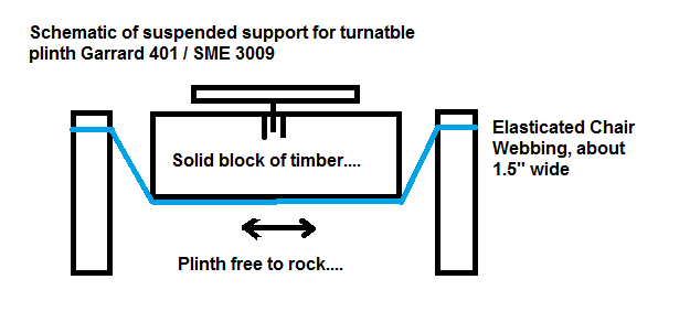

The Garrard 401 is quite familiar to me. People used to build them into cabinets or make their own plinth from a lump of wood. SME made a goodish suspended plinth, but the best I ever saw was suspended on furniture webbing within a simple box frame so it rocked gently backwards and forwards while tracking securely. The flimsy SME 3009 9" tonearm wasn't really all that good in hindsight, and people fitted heavier ones with the more demanding moving coil cartridges.

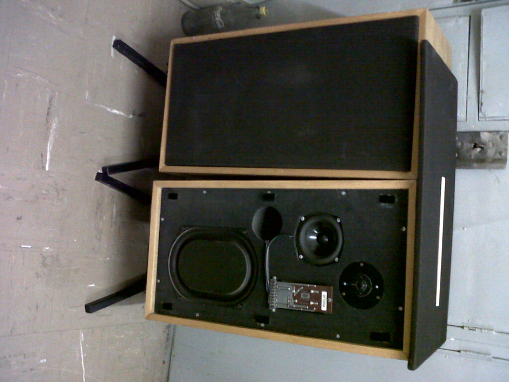

Here are two photos of the old girls. They are on some open-frame stands I got with them. The veneer on both has become very tatty and loose, in fact I got a nasty splinter from the one the other day, so this is also part of the motivation to build new cabs. I did a quick calc, and I'd be able to put the Leaks in sealed cabs of about 75l - 80l. Maybe more if I extend the depth a bit. What do you think?

Falcon Acoustics do a £35 replacement crossover (No. 5aB) which is claimed to make a significant improvement to them.
Alternatively Dr. Bailey published a DIY transmission line design for them in Wirelesss World in May 1972 which is supposed to sound fantastic.
