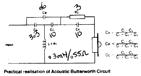

KEF 104B crossover schematic needed !
Hello everybody,
I want to find some construction information on the KEF 104B speaker.
This speaker was a 2 way design that used a T33, a B200 and a 139B passive radiator. I need the box dimensions and the crossover for this speaker.
Thanks a lot in advance.
Greetings Ilias

I happen to have analysed the 104aB filter as a start of my 'career'. The LF filter is simple and consists of a 3rd order filter with a resistor parallel to the second inductor. The values are:
L1: 2.7 mH switchable to 3.6 and 2.0
L2: 500 uH (with 10 ohm parllel)
C1: 5 uF
The HF filter is as shown above. with the following values:
C1: 3.3 uF
C2: 10 uF
C3: 10 uF
C4 (the one pareallel to C1 and C2): 600 nF
R1 (parallel to C3): 3 ohm
L1: 2.4 mH
The inductors where rather high resistance iron core ones. It seems that the speaker doesn't improve with better components but I never tried that. Theh capacitors I could not identify but where not much better I suppose.

KEF104aBcrossover
Make sure you have the correct specification Kef drivers.
(Tapped inductor is some form of contour control built into 104aB's.)
If you do not have the correct specification drivers then its likely
better to use a KEF crossover for that specification driver.
🙂/sreten.

Thanks! I've just stumbled on the same diagram from www.hifiloudspeakers.info/Anatomy/Crossovers/AnatomyCrossovers.html and also got a schematic of the contour control from Mr Watson (!) from KEF (I was going to attach it but it's too big - e-mail me if you want it), via Neil Smith from Wilmslow Audio - very helpful people. They do a manufactured pair for £120. I can see that the 3-position control knob will sit on the positive supply of the circuit diagram, selecting between 2/2.7/3.5mH inductors that feed the B200 mid driver. I guess a simple 3 pole switch would do. Just about to bid for a pair of 104's......
David
the extra components on the T27 section were the famous "acoustic butterworth" components of that time. The T27 fundamental resonance was around 1.2 kHz and even though about 30 dB down the slope of the crossover spoilt the sound. The extra AB components nulled the effect of the resonance and did give a better smoother sound through the crossover region than before. Kef did a reasonable trade in upgrade kits of the crossover for self fit since the 104 was a popular speaker of that era.
I forgot, the outside of the box was 63 cm by 33cm by 26cm deep. It was made with rather thick flooring grade chipboard, braced around the middle with internal volume of 35.5 litres filled with heavy grade foam. You do need the later higher power B200 since the crossover lower section was designed for it. Also the passive B139 ABR suspension was tuned for the volume so you would need to stick fairly close to the original if you have the same unit.
another thing 🙂 the contour control was flat or + or - 2 dB very shallow hump or dip centered at 1.5 kHz and could bring the sound forward for close mic or rock impact or back for classical or concert hall ambience etc etc... or just to compensate for bright or dull rooms.
