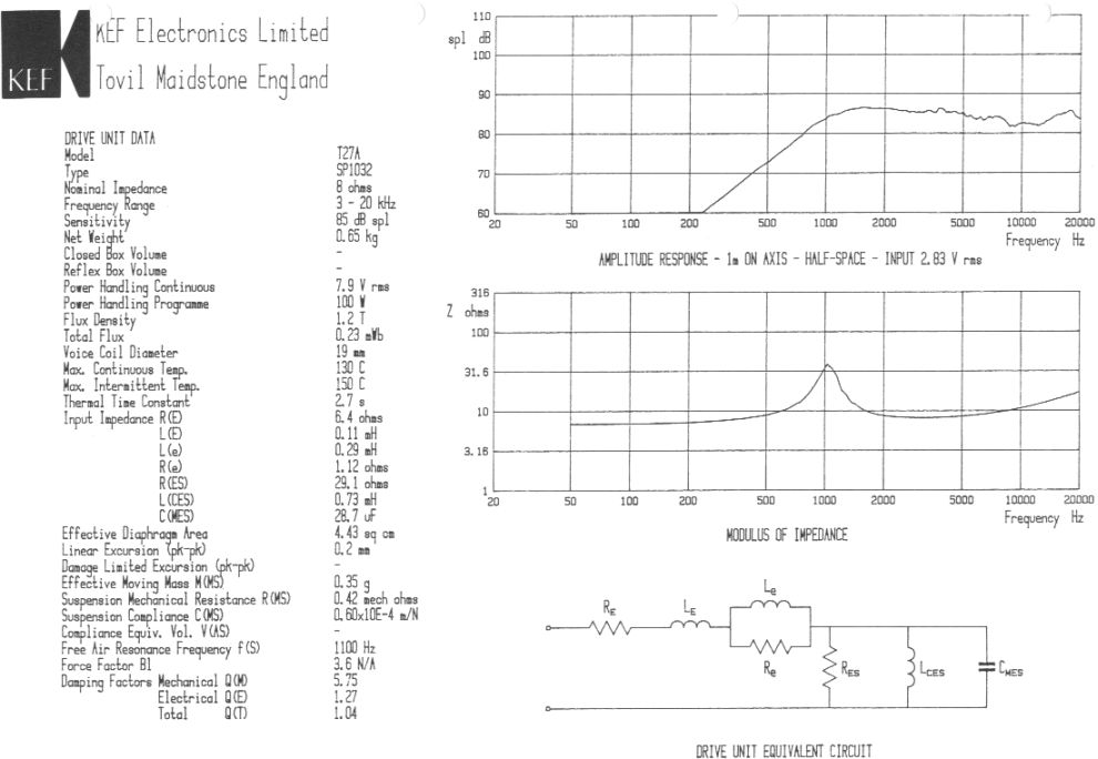

Hello Lee
Thanks for the suggestion. Nice work on the JBL L100. Good job and great pictures!
I have heard the JBL L100 (with super tweeters); it sounds fabulous.
With regards to the KEF104aB, if there are adequate supply of KEF T27A, I would gladly go for them. However, due to their fame and shortages, prices are getting ridiculous. I rebuilt the KEF 104 in 2003/04 period, and it was already very difficult to get a decent pair of KEF T27A at a sensible price. Recently, some offered me the T27A pair in the region of US$250-300. I would rather buy the Hiquphon OWI really for that sort of cost.
The T27A slowly deteriorate over time. I have a working pair of KEF104 and KEF LS3/5A. My 25 year old KEF LS3/5A sounds more dull than newer pairs of LS3/5 or equivalent, so I may be driven into T27A hunt again. With so many pairs of old LS 3/5 around, the T27A will become more and more difficult to source. It would be prudent to start looking for a decent replacement. I have heard many speakers, and unfortunately, I have yet found a pair that would make me part with the 104.
There are difficulties in retaining the original sound of the T27A with modern equivalents. Better technology does not necessary mean better sound. I have already heard the LS 3/5a using the Morel MDT29 as replacement. It may not be easy for many to spot the 'difference' (especially after some whisky 😎). Anyway, I always have a pair of 'standard' 104 to fall back on. Apart from the tweeter change on the 104aB project, the speaker cabinet may take another few more weeks to restore.

Despite some similarities that Eton tweeter is not sufficiently similar to a T27 to enable easy substitution.
The give-away is visible in the Impedance Plot.
See that chair shape from about 1kHz to about 2kHz.
In it is the flat region between 1.3 and 1.7 kHz at about 12 ohms.
This region is very different to a T27's impedance, which has a peak at about 1.1kHz, but then smoothly falls and has no flat-chair area.
The 12 ohm flat area of the Eton would require different crossover components to allow the Eton to cross at 3kHz, because the Octave below the crossover point does add to form the final response.
The Usher 9950C-15 is very like the T27 in its impedance shape, and only a resistor is need to get the magnitude optimum for the crossover components.
Also, the Eton is higher Sensitivity in part of its frequency range - see the Frequency Response plot.
I would use a ScanSpeak 950000 in preference to the Eton, but I suppose the Scan is above your budget, and really its Sensitivity is higher than optimum for use with a B200, unless one wants to drive it very hard.
Kef T27 is NOT 80dB Sensitivity, that 80dB is result of a particular type of specified test.
T27 is between 84 - 86dB Sensitivity, varying across its bandwidth.
Unless another brand/Company have something, it seems the Usher C-15 is the one to use.

I have consulted some friends who attempted to repair the T27A before. I managed to remove the voice coil from the main assembly using the 'kiss' method. Under a magnifying glass (my eye sight is still good, but the wire is too thin really) I can see that the (+) end has thinned down considerably, either due to age or it was driven near destruction at one time. There is no way to solder it back, even using a thin bridging wire. The (-) end is going as well. I would say this T27A born Jul 1977 should RIP.
As I was about to order the Dayton units, I stumbled upon one driver. The Eton 19SD-1 , a ¾” Soft Dome Tweeter with a response to 30 kHz. What really interests me are electrical equivalent circuit, as if a brother of the T27A:
Znom 8 ohm (T27 = 8 ohm)
Re 6.3 ohm (T27 = 6.25 ohm)
Le 0.018 mH (T27 = 0.050 mH)
fs 1100 Hz (fs 1200hz +/- 200hz)
Mms 0.16 g (0.37 g)
Sd 3.9 cm2 (4.52 cm2)
Xmax - 0.75 mm peak (?)
VC Ø 19 mm (T27 Ø 19mm)
Sensitivity 1W / 1m 89 dB (T27 = 80 dB, USHER = 88db ave various F)
Mounting wise, slight woodworking on the speaker cabinet should be fine. After all, the chip board is somewhat falling apart after all these years.
There may be more work on the speaker cabinet itself than working on the crossover/new tweeter.
Flange 110mm (T27 = 108mm, USHER =104mm)
Cut-out 74mm (T27 = 75mm, USHER = 75.3mm)
It looks like the Eton driver (Madisound) is not only a close approximation to the T27A, it is also very similar to the Usher 9950C-15 (also from Parts Express). Close German origin (I was told the T27A voice coil was originally made in Germany until KEF bought it). Eton or Usher should be the one.
Thanks and regards
Jonathan

Hello Allan,
Thanks for the detailed examination of the Eton/KEF impedance vs F plots.
With regards to the sensitivity plot, it could be by dissipated power or by applied rms voltage. Whatever it is, two different designs/make will certainly have a different response curve/sound. Strictly from a measured characteristics point of view, it is not possible to find an 'analog' of the T27 as you mentioned before.
I have no intention to repair the damaged T27. I have heard repaired units before (fixed by bridging wire(s)), it will sound different. The compliance maybe changed. Sometimes, it can sound broken. The damaged T27 I have shows a visible reduction in wire diameter on the (+), so its a goner.
Still no sight of a decent replacement pair of T27. Not sure I really want something that was EOL so many years ago. And at what price?
The Usher 9950C-15 sounds 'good'. I no longer own any SPL measuring tools, so I have to rely on listening tests if I were to use it. I appreciate your recommendation, as I do not want to end up changing tweeters after tweeters.

P.S. - I have that T27 data sheet you posted.
KEF 104aB characteristics

OW1 not with Kef's crossover
Hi Jonathan,
Hiquphon OW1 will not work well with either the Kef 104 or 104aB crossovers, because:
its middle of bandwidth Impedance is a bit lower than a T27,
and its Fs is lower in both Frequency and Magnitude,
thus it will need some changes to the crossover or you will be losing a significant amount of signal in the 3kHz <--> 6kHz region at least,
and maybe broader band loss than that, but with a little louder in the higher treble region.
The aB crossover was specifically tuned to the 1100 Hz Fs of T27A/SP1032 version, and with respect to the magnitude of the Impedance maximum there.
This crossover will only work with a tweeter that has its Fs close to 1100 Hz {1.1kHz} and with a similar Q of Impedance and SPL magnitude there.
The earlier 104 crossover did not ideally match the SP1032, but was likely the closest Kef could get to ideal then at reasonable cost with the limited options of readily available capacitor magnitudes then.
It seems to have been developed from the very similar crossover Kef used for their earlier 900 Hz Fs T27 type 6535.
OW1 has a lower Q of Impedance and SPL magnitude at its specified 850Hz Fs, and as such it does not need a tuned notch in an aB style crossover for the 3kHz crossing.
A simpler crossover of:
Capacitor - Inductor - Capacitor { 3rd Order filter as in original 104}
plus two resistors in L-pad format around the tweeter to get its midband impedance to a suitable magnitude for your Tube amp, and it SPL to match the B200, is sufficient.
I'll post values for all those components if you want to proceed with OW1.
If you convert the crossover, it would be a good idea to add the aB version's resistor of 10 ohms in parallel with the .6mH inductor in the bass/mid filter, because that was part of Kef's revision to get the crossover point to be exactly 3kHz.
The actual crossover point seems to have been a little lower than 3kHz in the original 104, and with not as smooth response through the overlap region where both drivers contribute as was achieved with the aB revision.
If you have sufficient number of T27A now, may as well stay with that.
