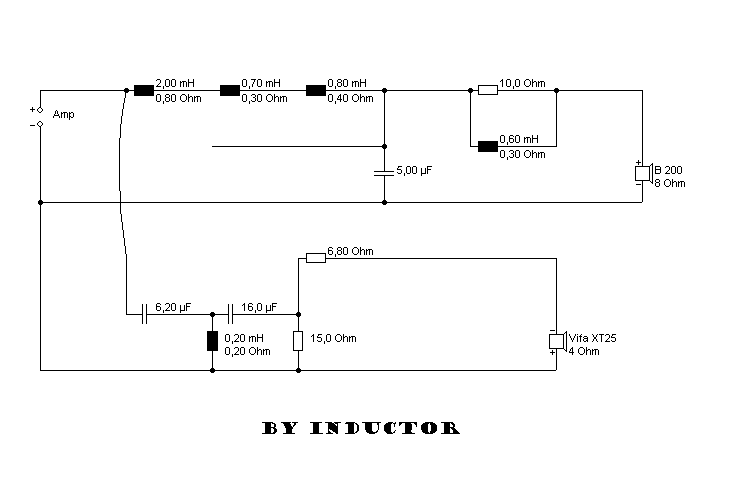

Can anyone tell me by looking at that crossover how I might do that? I have just started into this area and quite simply are in over my head. I have been running things through "crossover calculators" on line and trying to make sence of it. It does not help that this crossover has three positions for the HF filter.
In regards to the XT25 I feel that I have moved a little bit further along by doing more searching around the web. I found this crossover on the zaph audio site.
http://www.zaphaudio.com/ZD5.html At the very least I can take the Zobel network from that and apply my own crossover frequency. I think that is accurate enough for me at this point.
I wish I had the same information for the B200 SP1039 so I could do my best to flatten it out with a Zobel if need be and apply a simple LPF to it. From there try and sort out phase by tweeter placement. Well thats all ive got for today.

First of all your substitute Vifa XT25 has a Rvc of 3.0R and your original Kef T27 is 6.25/7.1R@2.3K. As you see you have to completely change your xover. For some more closed equiv.:

I did see that page before I bought the XT25's. I was feeling bold at the time and was willing to dig into a bit of a project. I am now wondering if I have made the right decision. If I can get the specs that Solen need then I will most likely just get them to build it.

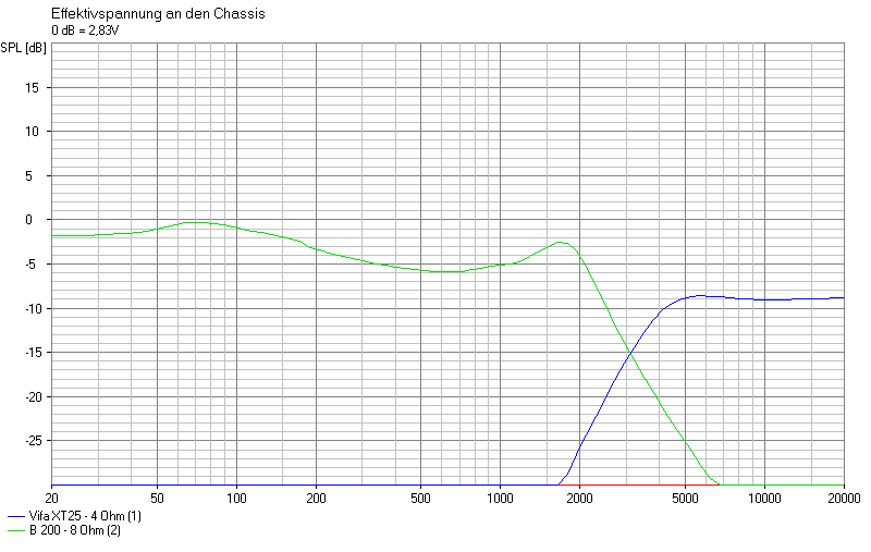

I'd say the biggest problem is the sensitivity difference T27 at 80dB vs XT25 at 90+. Not sure if the KEF noise method is equivalent but 10dB is a lot.The impedance mismatch will shift the XO frequency.
I'm currently using XT25 ring radiators (not Tymphany) and I like how they sound. Excellent on-axis, smooth off-axis roll off, low distortion. With their low F0 I'd say they were an excellent replacement - just need to fix the XO.
Inductor has a good solution but I'd break it into 2 parts. Start with the level correction which is the 2.2ohm and 3.3ohm resistor (in Inductors schematic) divider right next to the tweeter.
You can make it adjustable by using an 8ohm L-pad as a potentiometer instead of the resistors. Play with the balance between the highs and lows but try to keep the L and R values similar. Some kind of calibrated scale would be useful especially when adjusting levels between XO circuit A/B testing.
You may find that balancing the levels is good enough.

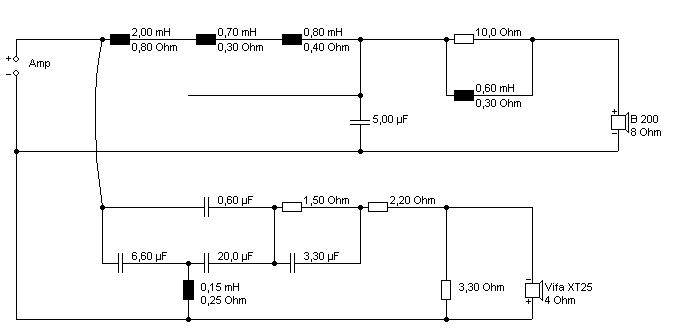

Mike,
where are you up to with your tweeter substitution ?
If you want a simple modification to try first so that you can listen to how the Vifa tweeter sounds with the old B200, then try this:-
Connect a 3.9 ohm, minimum 5 watt, preferably non-inductive, resistor in direct electrical Series with the tweeter
- between the tweeter and the old cross-over.
A 10 watt rated resistor would be better if you intend to play the speakers loudly.
4.7 ohms is close enough if you cannot easily get 3.9 to try.
Remove the 0.6uF capacitor, and the 3 ohm resistor that is in Parallel with the second 10uF capacitor, but leave that 10uF cap in circuit.
Listen to that, then next remove the 10 ohm resistor that is in Parallel with the 0.6mH inductor in the bass circuit.
Listen again, and decide whether you prefer with or with-out that 10 ohm resistor.
If you are happy with all this, then next you can substitute a new 5.1uF or 4.7 uF cap in place of the old 10uF's pair,
and a new 3.9uF, or 4uF, in place of the old 3.3uF.
But, if you are not happy do not buy the new capacitors
-and instead, try Zaph's Vifa option, or whatever else you can find.
I am NOT recommending you send the problem to Solen, because a Simulator produced circuit may not produce what you will actually like the sound from in practice.
Implementing cross-overs for good audible effect in loudspeakers is more complicated than simulators can achieve.
Also, as it has 3rd Order cross-over filter slopes for both drivers, it can be connected in either tweeter Polarity.
There will be audible differences, and you may prefer one option to the other,
thus listen with the tweeter in the Reverse Polarity, as in the original, and then swap the tweeter connections + and - around and listen with the tweeter thus in the same Polarity as the woofer.
Listen more-so on the woofer axis vertically, than on the tweeter axis,
as that will give closer to equal signal arrival times from both drivers,
and thus a more coherent sound.

update
The actual value of the input capacitor for the treble filter can be decided after you have decided the amount of Series resistance you prefer with the tweeter.
Kef originally used 4.2uF, though with a .25mH inductor following.
Kef changed to 3.3uF + .3mH to raise the cross over frequency,
however I read that you want to lower the cross over point.
Decide the added resistor, by ear, in the existing cross-over.
You can go higher than 4.7ohm if treble is still too much, but if you go to a much higher resistor, then is when to use an L-pad instead.
Post a reply here if you want any further comment on this.
